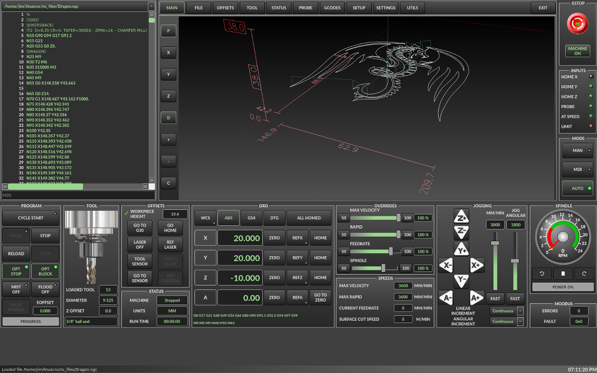

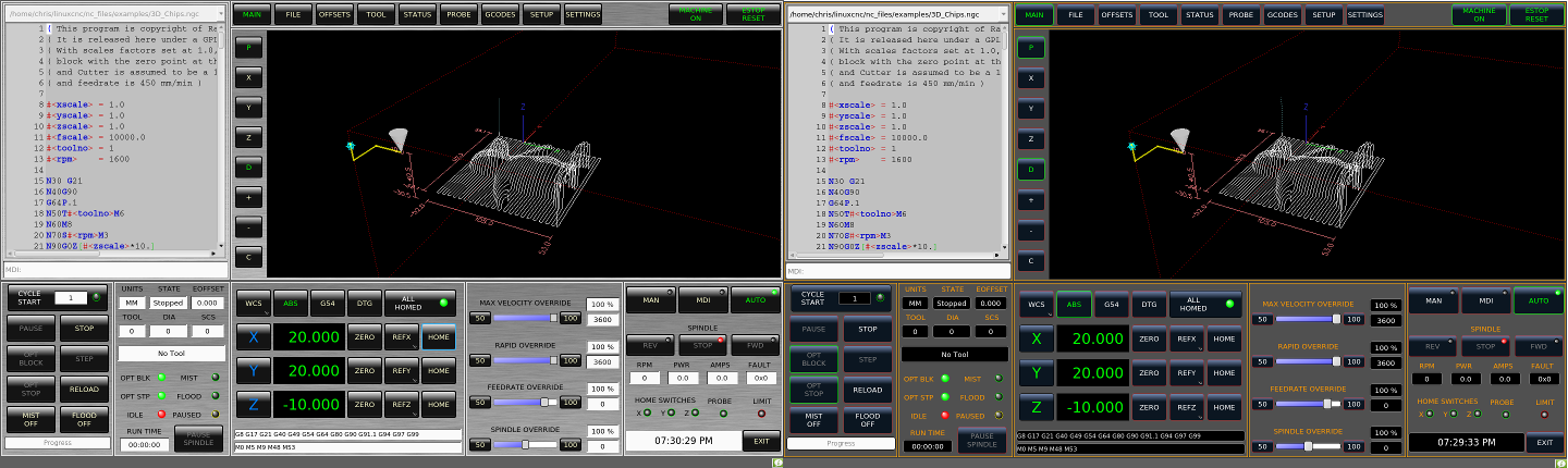

1. Innføring
QtDragon and QtDragon_hd are built with the QtVCP framework. It is the creative vision of forum personality Persei8. Much of it is based on the excellent work of others in the LinuxCNC community. LinuxCNC’s version is adapted from Persei8’s Github versions. It is primarily meant for 3/4 axes machines such as mills or routers. It works well with a touchscreen and/or mouse. QtDragon supports multiple ways to touch off tools and probing work pieces. You can use LinuxCNC’s external offsets capability to automatically raise the spindle during a pause. If you the VersaProbe option and remap code you can add auto tool length probing at tool changes.
QtDragon and QtVCP are relatively new programs added into LinuxCNC. Bugs and oddities are possible. Please test carefully when using a dangerous machine. Please forward reports to the forum or maillist.
1.1. QtDragon
QtDragon Router
QtDragon is resizable from a resolution of 1280x768 to 1680x1200. It will work in window mode on any monitor with higher resolution but not on monitors with lower resolution.
1.2. QtDragon_hd
QtDragon_hd
QtDragon_hd is a similar design as QtDragon but modified to utilize the extra space of modern larger monitors. There are some small differences in layout and utility.
QtDragon_hd has a resolution of 1920x1056 and is not resizeable. It will work in window mode on any monitor with higher resolution but not on monitors with lower resolution.

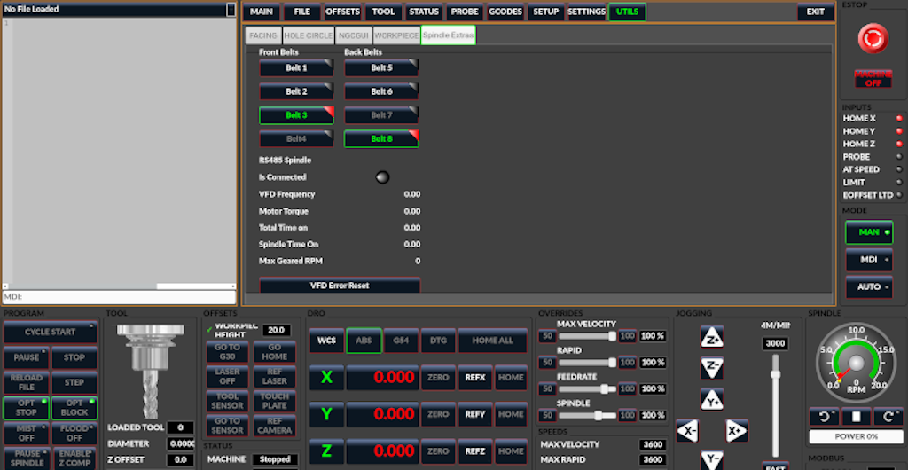

2.9.2. Embedding Spindle Belts Panel
This example panel is designed to display additional RS485 VFD data and also to configure a 4 sheave, 2 belt spindle drive via a series of buttons.
QtDragon spindle_belts Panel - Spindle Belts VCP
[DISPLAY]
EMBED_TAB_NAME = Spindle Belts
EMBED_TAB_COMMAND = qtvcp spindle_belts
EMBED_TAB_LOCATION = tabWidget_utilities

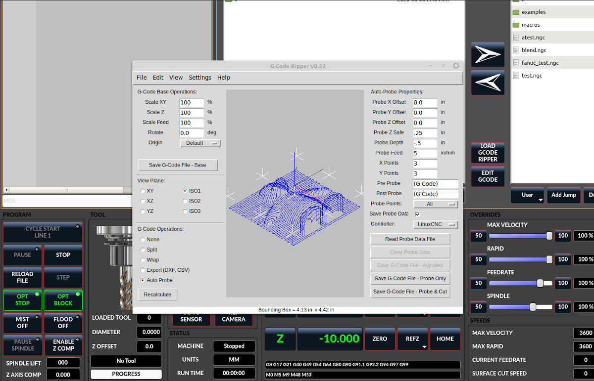

11.1. Using G-code Ripper for Z level Compensation
QtDragon G-code Ripper
G-code Ripper offers many functions that we will not go in to here. This is only available in the QtDragon_hd version.
  • In qtdragon_hd, switch to the file tab and press the load G-code Ripper button.
  • Set origin to match the origin of the G-code file to be probed.
  • Under G-Code Operations, check Auto Probe.
  • File -> Open G-Code File (The file you will run after compensation)
  • If necessary, make adjustments and press Recalculate.
  • Press Save G-Code File - Probe Only.
  • Save the generated file to the nc_files folder.
  • Exit gcode_ripper.
  • Without changing the offsets, run this program. Make sure the probe tool is installed. When complete, there will be a file in the config directory called probe_points.txt.
  • In qtdragon_hd, press the Enable Z Comp button to enable compensation. Look at the status line for indication of success or failure. Active compensation will be displayed beside the label: Z Level Comp While jogging that display should change based on the compensation component.

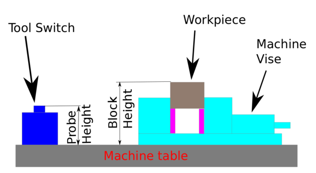

QtDragon has 2 methods for setting Z0. The first is a touchplate, where a metal plate of known thickness is placed on top of the workpiece, then the tool is lowered until it touches the plate, triggering the probe signal. The current user system’s (G5x) Z0 is set to probe height - the entered plate thickness.
The second method uses a tool setter in a fixed position and a known height above the table where the probe signal will be triggered. In order to set Z0 to the top of the workpiece, it has to know
  1. how far above the table the probe trigger point is (tool setter height) and
  2. how far above the table the top of the workpiece is.
This operation has to be done every time the tool is changed as the tool length is not saved.

  • PROBE HT:: The height of the tool sensor from the machine table surface. This value is used to calculate the Z zero height for the current work coordinate system when using the probe with a tool setter sensor.
  • BLOCK HT:: The height of the top of the workpiece from the machine table surface. This value is used to calculate the Z zero height for the current work coordinate system when using the probe with a tool setter sensor.

QtDragon can be setup to do integrated auto tool measurement using the Versa Probe widget and remap code. To use this feature, you will need to do some additional settings and you may want to use the offered HAL pin to get values in your own ngc remap procedure.
Before starting the first test, do not forget to enter the probe height and probe velocities on the versa probe settings page.
Tool Measurement in QtDragon is done with the following steps:
  • Touch off your workpiece in X and Y.
  • Measure the height of your block from the base, where your tool switch is located, to the upper face of the block (including chuck etc.).
  • In the Versa probe tab, enter the measured value for block height.
  • Make sure the use tool measurement button in the Vesa probe tab is enabled.
  • Go to auto mode and start your program.
When fist setting up auto tool measurement, please use caution until you confirm tool change and probe locations - it is easy to break a tool/probe. Abort will be honoured while the probe is in motion.
images/sketch_auto_tool_measurement.png
With the first given tool change the tool will be measured and the offset will be set automatically to fit the block height. The advantage of this way is, that you do not need a reference tool.
Your program must contain a tool change at the beginning. The tool will be measured, even it has been used before, so there is no danger if the block height has changed. There are several videos on you tube that demonstrate the technique using GMOCCAPY. The GMOCCAPY screen pioneered the technique.

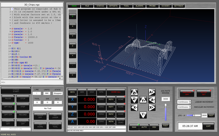

17.1. Main tab
This tab displays the graphical representation of the current program. The side buttons will control the display.
  • User View: Select/restore a user set view of the current program.
  • P,X,Y,Z: Set standard views.
  • D: Toggle display of dimensions.
  • +, -: Zoom controls.
  • C: Clear graphics of tool movement lines.

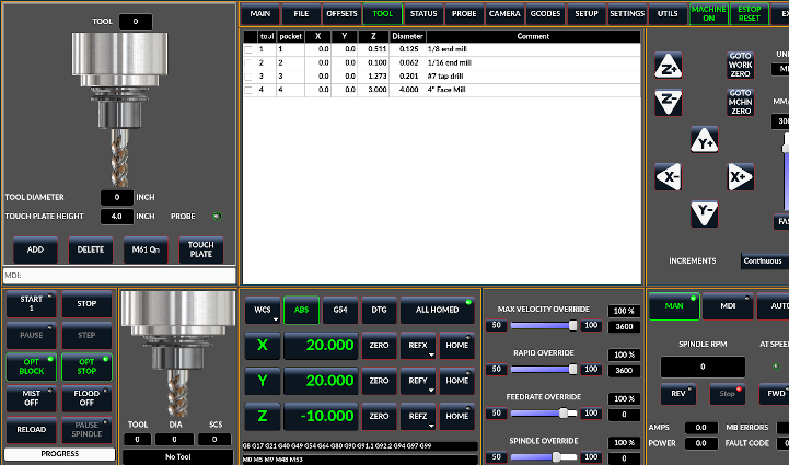

17.4. Tool Tab
You can monitor/modify tool offsets from this tab. Adding and deleting tools from the tool file can also be done from this tab. When this tab is selected the individual home buttons in the DRO area will change to tool offset setting buttons. They will return to home buttons when you select another tab. Pressing this tool button will drop down a when menu of options:
  • Set Current Tool Position
  • Adjust Current Tool Position
  • Zero Current Tool Position
  • Set Tool Offset Directly
  • Reset To Last

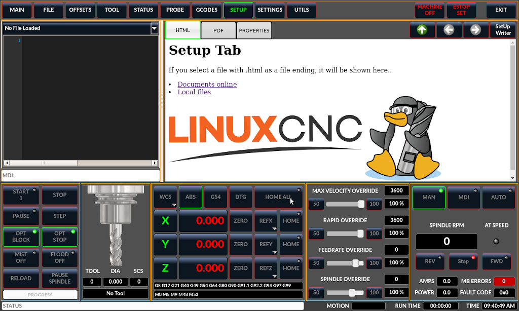

17.9. Setup Tab
It’s possible to load HTML or PDF file (.html / .pdf ending) with setup notes, and will be displayed in the setup tab.
If you load a G-code program and there is an HTML/PDF file of the same name, it will load automatically.
Some program, such as Fusion 360 and Aspire will create these files for you. You can also write your own HTML docs with the included SetUp Writer button.
There are three sub tabs:
  • HTML - any loaded HTML pages are displayed here. The navigation buttons work on this page.
  • PDF - any loaded PDF setup pages are displayed here.
  • PROPERTIES - when a program is loaded its G-code properties are displayed here.
There are navigation buttons for HTML page:
  • The up arrow returns you to the default HTML page.
  • The left arrow moves backward one HTML page.
  • The right arrow moves forward one HTML page.
If you wish to include a custom default HTML page, name it default_setup.html and place it in your configuration folder.
Custom QtVCP panels can be displayed in this tab by setting the EMBED_TAB_LOCATION option to tabWidget_setup.
QtDragon Setup Tab
