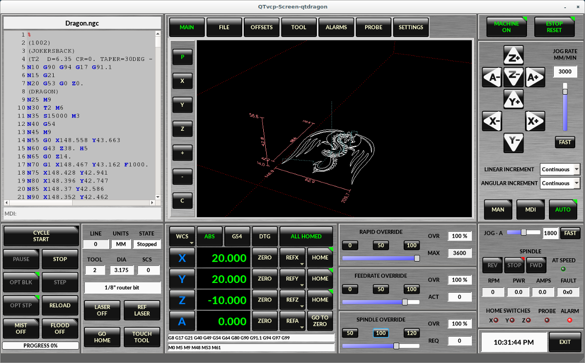

1. Showcase
Few examples of QtVCP built screens and virtual control panels:
QtDragon Router
Qtscreen Mill
Qtscreen QtAxis
Qtscreen Blender
Qtscreen x1mill
Qtscreen x1mill
Test Panel
