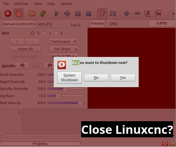

exit screen
Closes down LinuxCNC

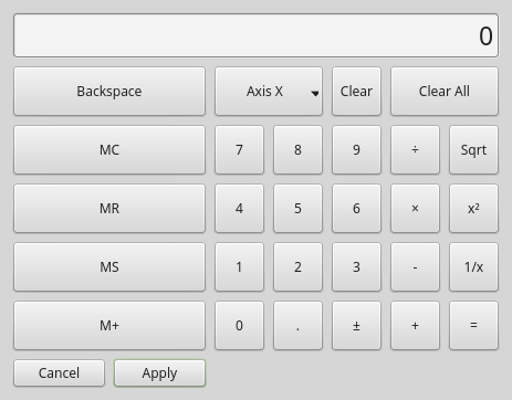

2.4. AxisToolButton - Select and Set Axis Widget
This allows one to select and set an axis.
If the button is set checkable, it will indicate which axis is selected.
If you press and hold the button a pop up menu will show allowing one to:
  • Zero the axis
  • Divide the axis by 2
  • Set the axis arbitrarily
  • Reset the axis to the last number recorded
You must have selected an entry dialog that corresponds to the dialog_code_string, usually this is selected from the screenOptions widget.
You can select the property halpin_option, it will then set a HAL pin true when the axis is selected. The property joint_number should be set to the appropriate joint number. The property axis_letter should be set to the appropriate axis letter.
The property dialog_code_string can be changed to ENTRY or CALCULATOR to call a typing only entry dialog or a touch/typing calculator type entry dialog.
It is based on PyQt’s QToolButton.

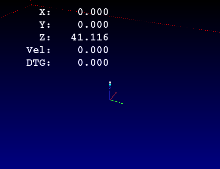

2.9. GCodeGraphics - G-code Graphic Backplot Widget
QtVCP GcodeGraphics: G-code Graphic Backplot Widget
This displays the current G-code in a graphical form.
Stylesheets Properties
dro-font/dro-large-font (string)
Sets the small and large DRO font properties
Here we reference with the widget base name; GCodeGraphics
GCodeGraphics{
    qproperty-dro_font:"monospace  bold 12";
GCodeGraphics{
    qproperty-dro_large_font:"Times 25";
_view (string)
Sets the default view orientation on GUI load.
Valid choices for a lathe are p, y, y2. For other screens, valid choices are p, x, y, z, z2.
The following shows an example of how to set this property (referenced using the widget user selected name):
#gcodegraphics{
    qproperty-_view: z;
_dro (bool)
Determines whether or not to show the DRO.
The following shows an example of how to set this property:
#gcodegraphics{
    qproperty-_dro: False;
_dtg (bool)
Determine whether or not to show the Distance To Go.
#gcodegraphics{
    qproperty-_dtg: False;
_metric (bool)
Determines whether or not to show the units in metric by default.
#gcodegraphics{
    qproperty-_metric: False;
_overlay (bool)
Determines whether or not to show the overlay by default.
#gcodegraphics{
    qproperty-_overlay: False;
_offsets (bool)
Determines whether or not to show the offsets by default.
#gcodegraphics{
    qproperty-_offsets: False;
_small_origin (bool)
Determines whether or not to show the small origin by default.
#gcodegraphics{
    qproperty-_small_origin: False;
overlay_color (primary, secondary, or RGBA formatted color)
Sets the default overlay color.

#gcodegraphics{
    qproperty-overlay_color: blue;
background_color (primary, secondary, or RGBA formatted color)
Sets the default background color.
#gcodegraphics{
    qproperty-background_color: blue;
+_use_gradient_background+ (bool)
Determines whether or not use a gradient background by default.
#gcodegraphics{
    qproperty-_use_gradient_background: False;
jog_color (primary, secondary, or RGBA formatted color)
Sets the default jog color.
#gcodegraphics{
    qproperty-jog_color: red;
Feed_color (primary, secondary, or RGBA formatted color)
Sets the default feed color.
#gcodegraphics{
    qproperty-Feed_color: green;
Rapid_color (primary, secondary, or RGBA formatted color)
Sets the default rapid color.
#gcodegraphics{
    qproperty-Rapid_color: rgba(0, 0, 255, .5);
InhibitControls (bool)
Determines whether or not to inhibit external controls by default.
#gcodegraphics{
    qproperty-InhibitControls:True;
MouseButtonMode (int)
Changes the mouse button behavior to rotate, move or zoom within the preview.
#gcodegraphics{
    qproperty-MouseButtonMode: 1;

MouseWheelInvertZoom (bool)
Determines whether or not to invert the zoom direction when zooming with the mouse wheel.
#gcodegraphics{
    qproperty-MouseWheelInvertZoom:True;
ACTION functions
The ACTION library can control the G-code graphics widget.
ACTION.RELOAD_DISPLAY()
Reload the current program which recalculates the origin/offsets.
ACTION.SET_GRAPHICS_VIEW(_view_)
The following view commands can be sent:
  • clear
  • zoom-in
  • zoom-out
  • pan-up
  • pan-down
  • pan-right
  • pan-left
  • rotate-cw
  • rotate-ccw
  • rotate-up
  • rotate-down
  • overlay-dro-on
  • overlay-dro-off
  • overlay-offsets-on
  • overlay-offsets-off
  • alpha-mode-on
  • alpha-mode-off
  • inhibit-selection-on
  • inhibit-selection-off
  • dimensions-on
  • dimensions-off
  • grid-size
  • record-view
  • set-recorded-view
  • P
  • X
  • Y
  • Y2
  • Z
  • Z2
  • set-large-dro
  • set-small-dro
ACTION.ADJUST_PAN(_X,Y_)
Directly set the relative pan of view in x and y direction.
ACTION.ADJUST_ROTATE(_X,Y_)
Directly set the relative rotation of view in x and y direction.
It is based on PyQt’s OpenGL widget.

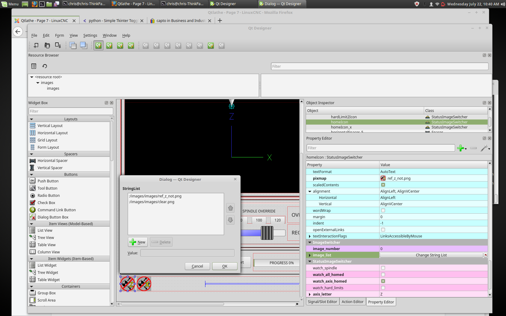

Here is an example of using it to display an icon of Z axis homing state:
QtVCP StatusImageSwitcher: Controller Status Image Switcher
In the properties section notice that:
  • watch_axis_homed is checked
  • axis_letter is set to Z
If you double click the image_list a dialog will show and allow you to add image paths to.
If you have one image as an icon and one clear image then that will look like it shows and hides the icon.
Selecting image paths can be done by selecting the pixmap property and selecting an image.
The pixmap setting is for test display only and will be ignored outside of Qt Designer.
  • Right click the image name and you should see Copy path.
  • Click Copy path.
  • Now double click the image list property so the dialog shows.
  • Click the New button.
  • Paste the image path in the entry box.
Do that again for the next image.
Use a clear image to represent a hidden icon.
You can test the images display from the image list by changing the image number. In this case 0 is unhomed and 1 would be homed.
This is for test display only and will be ignored outside of Qt Designer.

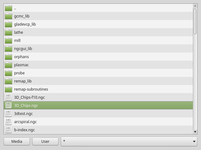

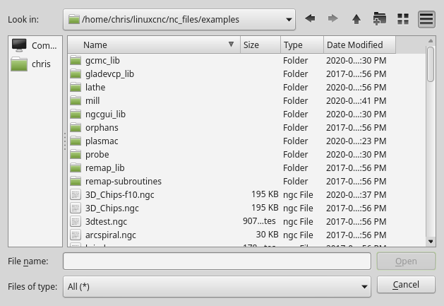

fileDialog_option
Sets up the file choosing dialog.

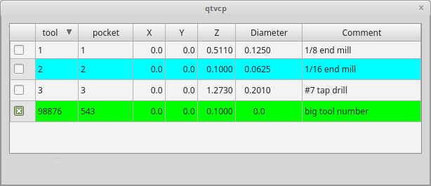

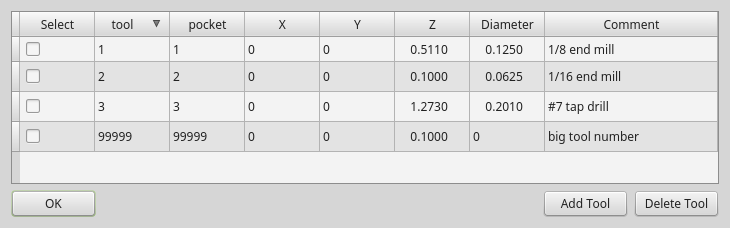

toolOffset_option
Sets up the tool offset display/editor dialog.
toolOffset_overlay_color
Color of transparent layer shown when the toolOffset dialog is shown.

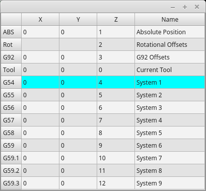

originOffset_option
Sets up the origin display/editor dialog.

calculatorDialog_option
Sets up the calculator entry dialog.
calculator_overlay_color
Color of transparent layer shown when the calculator dialog is shown.

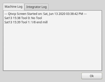

machineLogDialog_option
Sets up a dialog to display logs from the machine and QtVCP.

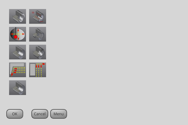

2.20. MacroTab - Special Macros Widget
QtVCP MacroTab: Special Macros Widget
This widget allows a user to select and adjust special macro programs for doing small jobs.
It uses images for visual representation of the macro and for an icon.
It searches for special macros using the INI definition:
[RS274NGC]
SUBROUTINE_PATH =
The macros are O-word subroutines with special comments to work with the launcher. The first three lines must have the keywords below, the fourth is optional.
Here is a sample for the first four lines in an O-word file:
; MACROCOMMAND = Entry1,Entry2
; MACRODEFAULTS = 0,true
; MACROIMAGE = my_image.svg,Icon layer number,Macro layer number
; MACROOPTIONS = load:yes,save:yes,default:default.txt,path:~/macros
MACROCOMMAND
This is the first line in the O-word file.
It is a comma separated list of text to display above an entry.
There will be one for every variable required in the O-word function.
If the macro does not require variables, leave it empty:
; MACROCOMMAND=
MACRODEFAULTS
This must be the second line in the O-word file.
It is a comma separated list of the default values for each variable in the O-word function.
If you use the word true or false in the list, a *checkbutton* will be shown.
MACROIMAGE
This must be the third line in the O-word file.
  • SVG Images
    If using SVG image files, they must end with the .svg extension.
    The images must be added to SVG layers which are used to define the different images for macro and icon.
    Value is comma separated list of three ordered fields:
    ; MACROIMAGE=filename.svg,macro_layer_name[,icon_layer_name]
    With:
    _filename_.svg
    SVG image file name as first field.
    It is assumed to be in the same folder as the O-word file.
    *macro_layer_name
    Macro image layer name as second field.
    icon_layer_name
    Icon image layer name as optional third field. If the third entry is missing, the same image will be used for macro and icon.
  • PNG/JPG Images:
    Value remains a comma separated list:
    ; MACROIMAGE=macro_image.(png|jpg)[,icon_image.(png|jpg)]
    With:
    _macro_image_.(png|jpg)
    Macro image file name as first field.
    It is assumed that the image file are in the same folder than the macro.
    _icon_image_.(png|jpg)
    Icon image file name as optional second field.
    If the second entry is missing the same image will be used for macro and image.
If the keyword is present but the entries are missing, no images will be used.
MACROOPTIONS
This optional line must be the fourth line in the O-word file.
It is a comma separated list of keyword and data:
LOAD:yes
Shows a load button.
SAVE:yes
Shows a save button.

2.24. OriginOffsetView - Origins View and Setting Widget
QtVCP OriginOffsetsView: Origins View and Setting Widget
This widget allows one to visualize and modify User System Origin offsets directly.
It will update LinuxCNC’s Parameter file for changes made or found.
The settings can only be changed in LinuxCNC after homing and when the motion controller is idle.
The display and entry will change between metric and imperial, based on LinuxCNC’s current G20 / G21 setting.
The current in-use user system will be highlighted.
Extra actions can be integrated to manipulate settings.
These actions depend on extra code added either to a combined widget, like originoffsetview dialog, or the screens handler code.
Typical actions might be Clear Current User offsets or Zero X.
Clicking on the columns and rows allows one to adjust the settings.
A dialog can be made to popup for data or text entry.
The comments section will be recorded in the preference file.
It is based on PyQt’s QTableView, QAbstractTableModel, and ItemEditorFactory.
Properties, functions and styles of the PyQt base objects are always available.

2.26. MachineLog - Machine Events Journal Display Widget
FIXME MachineLog documentation

2.29. FileManager - File Loading Selector Widget
QtVCP FileManager: File Loading Selector Widget
This widget is used to select files to load.
It has a the ability to scroll the names with hardware such as a MPG.
One can class patch the function load(self,fname) to customize file loading.
The function getCurrentSelected() will return a Python tuple, containing the file path and whether it is a file.
temp = FILEMANAGER.getCurrentSelected()
print('filepath={}'.format(temp[0]))
if temp[1]:
    print('Is a file')
doubleClickSelection (bool)
Determines whether or not to require double clicking on a folder.
Single clicking a folder (False) is enabled by default and is intended for touch screen users.
#filemanager {
    qproperty-doubleClickSelection: True;
showListView (bool)
Determines whether or not to show the file/folder structure in list form.
Table view (False) is enabled by default.
#filemanager {
    qproperty-showListView: True;
It is based on PyQt’s FIXME

2.31. ToolOffsetView - Tools Offsets View And Edit Widget
QtVCP ToolOffsetView: Tools Offsets View And Edit Widget
This widget displays and allows one to modify tools offsets.
It will update LinuxCNC’s tool table for changes made or found.
The tool settings can only be changed in LinuxCNC after homing and when the motion controller is idle.
The display and entry will change between metric and imperial based on LinuxCNC’s current G20/G21 setting.
The current in-use tool will be highlighted, and the current selected tool will be highlighted in a different color.
The checkbox beside each tool can be used to select too for an action that depends on extra code added either to a combined widget, like the toolOffsetView dialog or the screens handler code.
Typical actions are load selected tool, delete selected tools, etc.
The comments section will typically be displayed in the manual tool change dialog.
If using a lathe configuration, there can be columns for X and Z wear.
To use these columns to adjust the tool wear, it requires a remapped tool change routine.
Properties
ToolOffsetView has properties that can be set in Qt Designer, in Python handler code or (if appropriate) in stylesheets:
dialog_code_string
Sets which dialog will pop up with numerical entry.
test_dialog_code_string
Sets which dialog will pop up with text entry.
metric_template
Metric numerical data format.
imperial_template
Imperial numerical data format.
styleCodeHighlight
Current tool-in-use highlight color.
styleCodeSelected
Selected highlight color.
In a handler file:
self.w.tooloffsetview.setProperty('dialog_code','CALCULATOR')
self.w.tooloffsetview.setProperty('metric_template','%10.3f')
and in style sheets:
ToolOffsetView{
  qproperty-styleColorHighlist: lightblue;
  qproperty-styleColorSelected: #444;
Funksjoner
ToolOffsetView has some functions useful for screen builders to add actions:
add_tool()
Adds a blank dummy tool (99) that the user can edit to suit.
delete_tools()
Deletes the currently checkbox selected tools.
get_checked_list()
Returns a list of tools selected by checkboxs.
set_all_unchecked()
Uncheck all selected tools.
Example for handler file executing aforementioned functions.
self.w.tooloffsetview.add_tool()
self.w.tooloffsetview.delete_tools()
toolList = self.w.tooloffsetview.get_checked_list()
self.w.tooloffsetview.set_all_unchecked()

3.3. FileDialog - Load and Save File Chooser Dialog Widget
QtVCP FileDialog: Load and Save File Chooser Widget
This is used to load G-code files.
If there is a Focus Overlay widget present, it will signal it to display.
When using STATUS 's request-dialog function, the default launch names are LOAD or SAVE.
There are options that can be set when requesting a dialog, these would be added to the message dict:
EXTENSIONS
FILENAME
DIRECTORY
An example Python call, for a load dialog:
mess = {'NAME':'LOAD','ID':'_MY_DIALOG_',
            'TITLE':'Load Some text File',
            'FILENAME':'~/linuxcnc/nc_files/someprogram.txt',
            'EXTENSIONS':'Text Files (*.txt);;ALL Files (*.*)'
ACTION.CALL_DIALOG(mess)
And for a save dialog

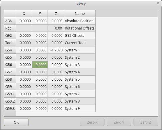

3.4. OriginOffsetDialog - Origin Offset Setting Dialog Widget
QtVCP `OriginOffsetDialog`: Origin Offset Setting Widget
This widget allows one to modify User System origin offsets directly in a dialog form.
If there is an Focus Overlay widget present, it will signal it to display.
When using STATUS 's request-dialog function, the default launch name is ORIGINOFFSET.
It is based on PyQt’s QDialog.
3.5. ToolOffsetDialog - Tool Offset Setting Dialog Widget
QtVCP `ToolOffsetDialog`: Tool Offset Setting Dialog Widget
This widget allows one to modify Tool offsets directly in a dialog form.
When using STATUS 's request-dialog function, the default launch name is TOOLOFFSET.
3.6. MacroTabDialog - Macro Launch Dialog Widget
This is a dialog to display the macrotab widget.
MacroTab displays a choice of macro programs to run using icons.
When using ``STATUS``'s request-dialog function, the default launch name is MACROTAB.

3.9. CalculatorDialog - Calculator Dialog Widget
QtVCP CalculatorDialog: Calculator Dialog Widget
This is a dialog to display a calculator for numeric entry, such as origin offset.
It returns the entry via STATUS messages using a Python DICT.
The DICT contains at minimum, the name of the dialog requested and an ID code.
When using ``STATUS``'s request-dialog function, the default launch name is CALCULATOR.

3.12. MachineLogDialog - Machine and Debugging Logs Dialog Widget
QtVCP MachineLogDialog: Machine and Debugging Logs Dialog Widget
This is a dialog to display the machine log and QtVCP’s debugging log.

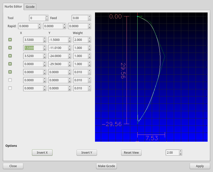

4.1. NurbsEditor - NURBS Editing Widget
QtVCP NurbsEditor: NURBS Editing Widget
The Nurbs editor allows you to manipulate a NURBS based geometry on screen and then convert NURBS to G-code.
You can edit the G-code on screen and then send it to LinuxCNC.

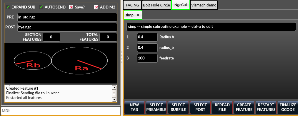

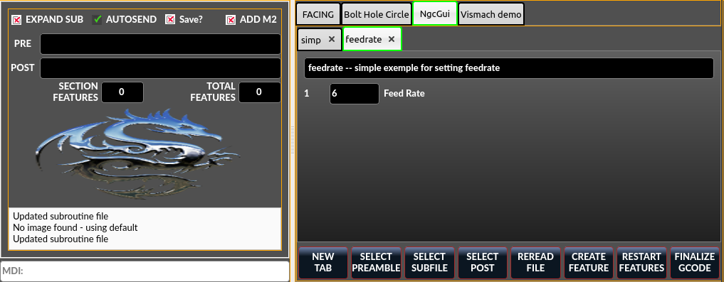

6.5. Qt NGCGUI
QtVCP NGCGUI: Shown from QtDragon
QtVCP’s version of NGC subroutine selector (Shown as used in QtDragon).
6.5.1. INI settings
LinuxCNC needs to know where to look to run the subroutines.
If the subroutine calls other subroutines or custom M codes, those paths must be added too.
[RS274NGC]
SUBROUTINE_PATH = ~/linuxcnc/nc_files/examples/ngcgui_lib:~/linuxcnc/nc_files/examples/ngcgui_lib/utilitysubs
QtVCP needs to know where to open subroutines from.
You can also specify subroutines to be pre-opened in tabs.
[DISPLAY]
# NGCGUI subroutine path.

6.5.3. Adding Custom Subroutines
You can create your own subroutines for use with NGCGUI. They must follow these rules:
  • For creating a subroutine for use with NGCGUI, the filename and the subroutine name must be the same.
  • The subroutine must be in a folder within LinuxCNC’s INI designated search path.
  • On the first line there may be a comment of type info:
  • The subroutine must be surrounded by the sub and endsub tags.
  • The variables used must be numbered variables and must not skip number.
  • Comments and presets may be included.
  • If an image file of the same name is in the folder, it will be shown.
(info: feedrate -- simple example for setting feedrate)
o<feedrate> sub
    #<feedrate>       = #1 (= 6 Feed Rate) ; comments in brackets will be shown in ngcui
    f#<feedrate>
o<feedrate> endsub
