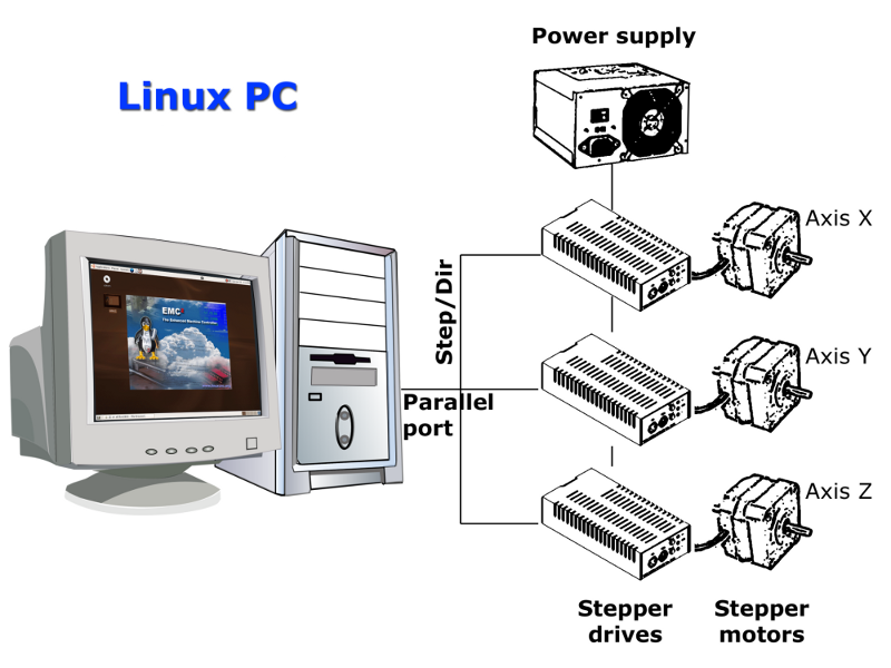

The below illustration is a simple block diagram showing what a typical 3-axis, CNC mill with stepper motors might look like:
![Simple LinuxCNC Controlled Machine](images/whatstep1.png)
A computer running LinuxCNC sends a sequence of pulses via the parallel port to the stepper drives, each of which has one stepper motor connected to it. Each drive receives two independent signals; one signal to command the drive to move its associated stepper motor in a clockwise or anti-clockwise direction, and a second signal that defines the speed at which that stepper motor rotates.

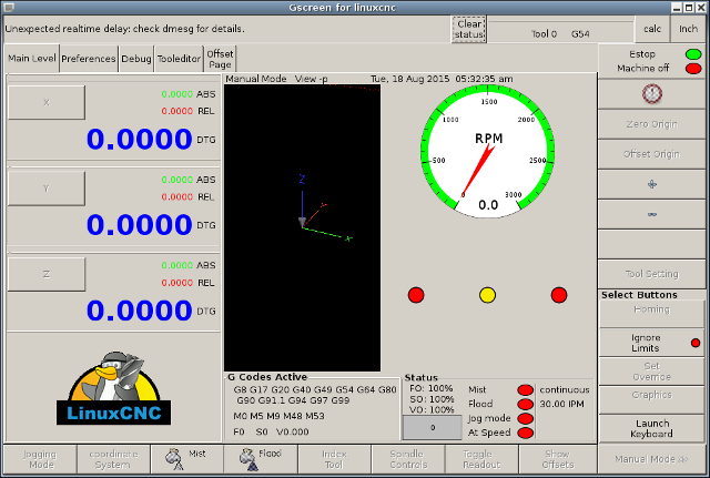

Gscreen, a user-configurable touch screen GUI:
![Gscreen, a configurable base touch screen GUI](../gui/images/gscreen-mill.png)

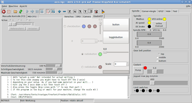

GladeVCP, a Glade-based virtual control panel that can be added to the Axis or Touchy GUIs. GladeVCP has the advantage over PyVCP in that it is not limited to the display or control of HAL virtual signals, but can include other external interfaces outside LinuxCNC such as window or network events. GladeVCP is also more flexible in how it may be configured to appear on the GUI:
![GladeVCP with Axis](../gui/images/axis-gladevcp.png)
