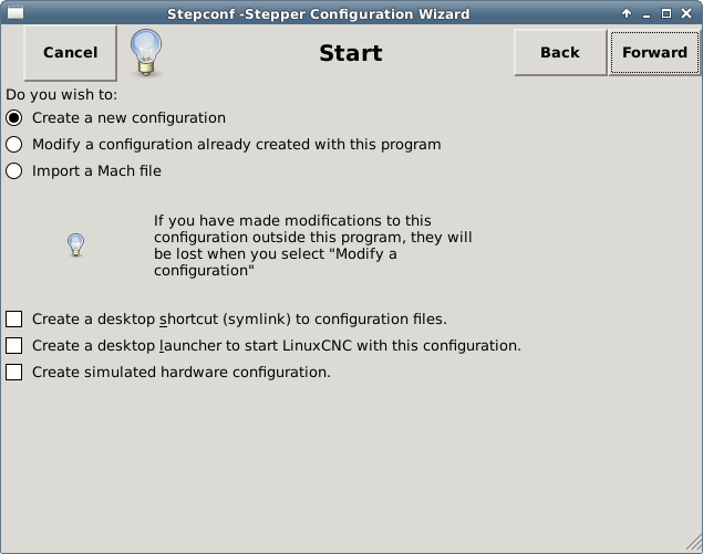

2. Start Page
![Entry Page](images/stepconf-start_en.png)
Create New - Creates a fresh configuration.
Modify - Modify an existing configuration. After selecting this a file picker pops up so you can select the .stepconf file for modification. If you made any modifications to the main .hal or the .ini file these will be lost. Modifications to custom.hal and custom_postgui.hal will not be changed by the Stepconf Wizard. Stepconf will highlight the lastconf that was built.
Import - Import a Mach configuration file and attempt to convert it to a linuxcnc config file. After the import, you will go though the pages of stepconf to confirm/modify the entries. The original mach xml file will not be changed.
These next options will be recorded in a preference file for the next run of Stepconf.
Create Desktop Shortcut - This will place a link on your desktop to the files.
Create Desktop Launcher - This will place a launcher on your desktop to start your application.
Create Simulated Hardware - This allows you to build a config for testing, even if you don’t have the actual hardware.

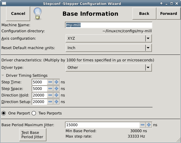

3. Basic Information
![Basic Information Page](images/stepconf-base_en.png)
Machine Name - Choose a name for your machine. Use only uppercase letters, lowercase letters, digits, - and _.
Axis Configuration - Choose XYZ (Mill), XYZA (4-axis mill) or XZ (Lathe).
Machine Units - Choose Inch or mm. All subsequent entries will be in the chosen units. Changing this also changes the default values in the Axes section. If you change this after selecting values in any of the axes sections, they will be over-written by the default values of the selected units.
Driver Type - If you have one of the stepper drivers listed in the pull down box, choose it. Otherwise, select Other and find the timing values in your driver’s data sheet and enter them as nano seconds in the Driver Timing Settings. If the data sheet gives a value in microseconds, multiply by 1000. For example, enter 4.5us as 4500ns.
A list of some popular drives, along with their timing values, is on the LinuxCNC.org Wiki under Stepper Drive Timing.
Additional signal conditioning or isolation such as optocouplers and RC filters on break out boards can impose timing constraints of their own, in addition to those of the driver. You may find it necessary to add some time to the drive requirements to allow for this.
The LinuxCNC Configuration Selector has configs for Sherline already configured.
Step Time - How long the step pulse is on in nano seconds. If your not sure about this setting a value of 20,000 will work with most drives.
Step Space - Minimum time between step pulses in nano seconds. If your not sure about this setting a value of 20,000 will work with most drives.
Direction Hold - How long the direction pin is held after a change of direction in nanoseconds. If your not sure about this setting a value of 20,000 will work with most drives.
Direction Setup - How long before a direction change after the last step pulse in nanoseconds. If your not sure about this setting a value of 20,000 will work with most drives.
One / Two Parport - Select how many parallel port are to be configured.
Base Period Maximum Jitter - Enter the result of the Latency Test here. To run a latency test press the Test Base Period Jitter button. See the Latency Test section for more details.
Max Step Rate -Stepconf automatically calculates the Max Step Rate based on the driver characteristics entered and the latency test result.
Min Base Period - Stepconf automatically determines the Min Base Period based on the driver characteristics entered and latency test result.

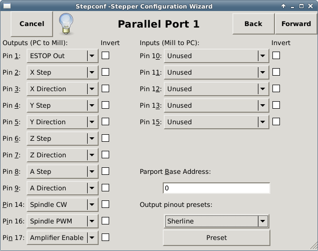

5. Parallel Port Setup
![Parallel Port 1 Setup Page](images/stepconf-parallel-1_en.png)
You may specify the address as a hexidecimal (often 0x378) or as linux’s default port number (probably 0)
For each pin, choose the signal which matches your parallel port pinout. Turn on the invert check box if the signal is inverted (0V for true/active, 5V for false/inactive).
Output pinout presets - Automatically set pins 2 through 9 according to the Sherline standard (Direction on pins 2, 4, 6, 8) or the Xylotex standard (Direction on pins 3, 5, 7, 9).
Inputs and Outputs - If the input or output is not used set the option to Unused.
External E Stop - This can be selected from an input pin drop down box. A typical E Stop chain uses all normally closed contacts.
Homing & Limit Switches - These can be selected from an input pin drop down box for most configurations.
Charge Pump - If your driver board requires a charge pump signal select Charge Pump from the drop down list for the output pin you wish to connect to your charge pump input. The charge pump output is connected to the base thread by Stepconf. The charge pump output will be about 1/2 of the maximum step rate shown on the Basic Machine Configuration page.

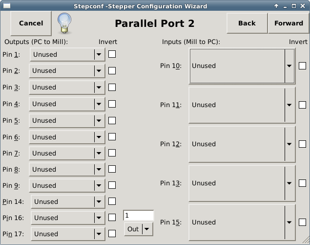

6. Parallel Port 2 Setup
![Parallel Port 2 Setup Page](images/stepconf-parallel-2_en.png)
The second Parallel port (if selected) can be configured and It’s pins
assigned on this page.
No step and direction signals can be selected.
You may select in or out to maximizes the number of input/output pins that
are available.
port number (probably 1).

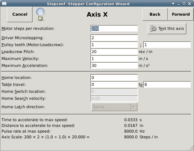

7. Axis Configuration
![Axis X Configuration Page](images/stepconf-axis-x_en.png)
Motor Steps Per Revolution - The number of full steps per motor revolution. If you know how many degrees per step the motor is (e.g., 1.8 degree), then divide 360 by the degrees per step to find the number of steps per motor revolution.
Driver Microstepping - The amount of microstepping performed by the driver. Enter 2 for half-stepping.
Pulley Ratio - If your machine has pulleys between the motor and leadscrew, enter the ratio here. If not, enter 1:1.
Leadscrew Pitch - Enter the pitch of the leadscrew here. If you chose Inch units, enter the number of threads per inch If you chose mm units, enter the number of millimeters per revolution (e.g., enter 2 for 2mm/rev). If the machine travels in the wrong direction, enter a negative number here instead of a positive number, or invert the direction pin for the axis.
Maximum Velocity -Enter the maximum velocity for the axis in units per second.
Maximum Acceleration - The correct values for these items can only be determined through experimentation. See Finding Maximum Velocity to set the speed and Finding Maximum Acceleration to set the acceleration.
Home Location - The position the machine moves to after completing the homing procedure for this axis. For machines without home switches, this is the location the operator manually moves the machine to before pressing the Home button. If you combine the home and limit switches you must move off of the switch to the home position or you will get a joint limit error.
Table Travel - The range of travel for that axis based on the machine origin. The home location must be inside the Table Travel and not equal to one of the Table Travel values.
Home Switch Location - The location at which the home switch trips or releases relative to the machine origin. This item and the two below only appear when Home Switches were chosen in the Parallel Port Pinout. If you combine home and limit switches the home switch location can not be the same as the home position or you will get a joint limit error.
Home Search Velocity - The velocity to use when searching for the home switch. If the switch is near the end of travel, this velocity must be chosen so that the axis can decelerate to a stop before hitting the end of travel. If the switch is only closed for a short range of travel (instead of being closed from its trip point to one end of travel), this velocity must be chosen so that the axis can decelerate to a stop before the switch opens again, and homing must always be started from the same side of the switch. If the machine moves the wrong direction at the beginning of the homing procedure, negate the value of Home Search Velocity.
Home Latch Direction - Choose Same to have the axis back off the switch, then approach it again at a very low speed. The second time the switch closes, the home position is set. Choose Opposite to have the axis back off the switch and when the switch opens, the home position is set.
Time to accelerate to max speed - Time to reach maximum speed calculated from Max Acceleration and Max Velocity.
Distance to accelerate to max speed - Distance to reach maximum speed from a standstill.
Pulse rate at max speed - Information computed based on the values entered above. The greatest Pulse rate at max speed determines the BASE_PERIOD. Values above 20000Hz may lead to slow response time or even lockups (the fastest usable pulse rate varies from computer to computer)
Axis SCALE - The number that will be used in the ini file [SCALE] setting. This is how many steps per user unit.
Test this axis - This will open a window to allow testing for each axis. This can be used after filling out all the information for this axis.

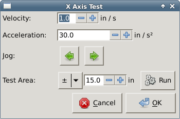

7.1. Test This Axis
![Test This Axis](images/stepconf-x-test_en.png)
Test this axis is a basic tester that only outputs step and direction signals to try different values for acceleration and velocity.
Important
In order to use test this axis you have to manually enable the axis if this is required. If your driver has a charge pump you will have to bypass it. Test this axis does not react to limit switch inputs. Use with caution. |
Begin with a low Acceleration
(for example, 2 inches/s2
or 50 mm/s2
and the velocity you hope to attain.
Using the buttons provided, jog the axis to near the center of travel.
Take care because with a low acceleration value,
it can take a surprising distance for the axis to decelerate to a stop.
After gaging the amount of travel available,
enter a safe distance in Test Area, keeping in mind that
after a stall the motor may next start to move in an unexpected direction.
Then click Run.
The machine will begin to move back and forth along this axis.
In this test, it is important that the combination of Acceleration and
Test Area allow the machine to reach the selected Velocity and cruise for
at least a short distance — the more distance, the better this test is.
The formula d = 0.5 * v * v/a
gives the minimum distance required to reach the
specified velocity with the given acceleration.
If it is convenient and safe to do so,
push the table against the direction of motion to simulate cutting forces.
If the machine stalls, reduce the speed and start the test again.
If the machine did not obviously stall, click the Run button off. The axis now returns to the position where it started. If the position is incorrect, then the axis stalled or lost steps during the test. Reduce Velocity and start the test again.
If the machine doesn’t move, stalls, or loses steps, no matter how low you turn Velocity, verify the following:
Correct step waveform timings
Correct pinout, including Invert on step pins
Correct, well-shielded cabling
Physical problems with the motor, motor coupling, leadscrew, etc.
Once you have found a speed at which the axis does not stall or lose steps during this testing procedure, reduce it by 10% and use that as the axis Maximum Velocity.
With the Maximum Velocity you found in the previous step, enter the acceleration value to test. Using the same procedure as above, adjust the Acceleration value up or down as necessary. In this test, it is important that the combination of Acceleration and Test Area allow the machine to reach the selected Velocity. Once you have found a value at which the axis does not stall or lose steps during this testing procedure, reduce it by 10% and use that as the axis Maximum Acceleration.

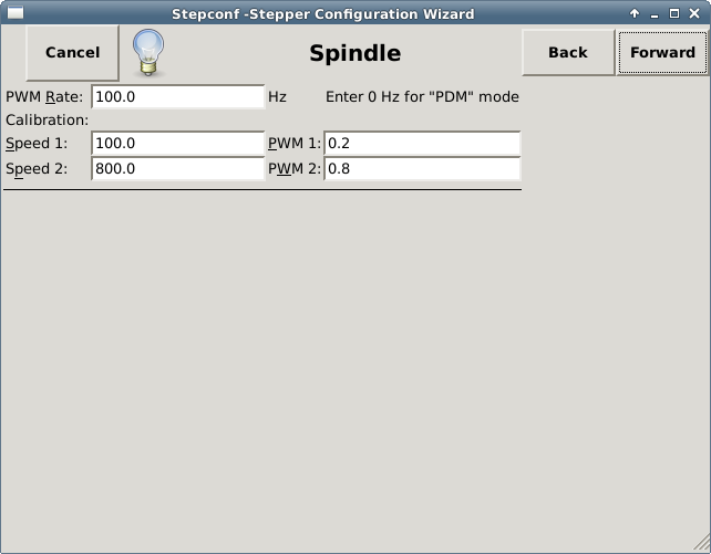

8. Spindle Configuration
![Spindle Configuration Page](images/stepconf-spindle_en.png)
This page only appears when Spindle PWM is chosen in the Parallel Port Pinout page for one of the outputs.
8.1. Spindle Speed Control
If Spindle PWM appears on the pinout, the following information should be entered:
PWM Rate - The carrier frequency of the PWM signal to the spindle. Enter 0 for PDM mode, which is useful for generating an analog control voltage. Refer to the documentation for your spindle controller for the appropriate value.
Speed 1 and 2, PWM 1 and 2 - The generated configuration file uses a simple linear relationship to determine the PWM value for a given RPM value. If the values are not known, they can be determined. For more information see Determining Spindle Calibration.
