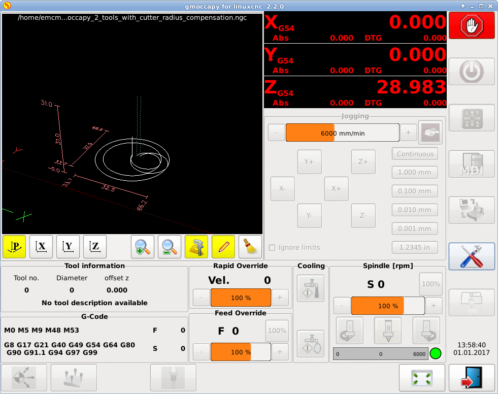

1. Introduction

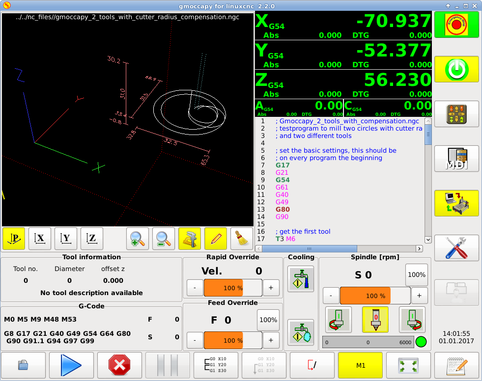

GMOCCAPY is a GUI for LinuxCNC, designed to be used with a touch screen, but can also be used on normal screens with a mouse or hardware buttons and MPG wheels, as it presents HAL Pins for the most common needs. Please find more information in the following.
It offers the possibility to display up to 9 axis, support a lathe mode for normal and back tool lathe and can be adapted to nearly every need, because gmoccapy supports embedded tabs and side panels. As a good example for that see gmoccapy_plasma
*gmoccapy 3 does support up to 9 axis and 9 joints. As gmoccapy 3 has been changed in code to support the joint / axis changes in LinuxCNC it does not work on 2.7 or 2.6 branch!
It has support for integrated virtual keyboard (onboard or matchbox-keyboard), so there is no need for a hardware keyboard or mouse, but it can also be used with that hardware. Gmoccapy offers a separate settings page to configure most settings of the GUI without editing files.
GMOCCAPY can be localized very easy, because the corresponding files are separated from the linuxcnc.po files, so there is no need to translate unneeded stuff. The files are placed in /src/po/gmoccapy. Just copy the gmoccapy.pot file to something like fr.po and translate that file with gtranslator or poedit. After rebuilding, you got the GUI in your preference language. Please publish your translation, so it can be included in the official packages and be published to other users. At the Moment it is available in English, German, Spanish, Polish, Serbian and Hungarian. Feel free to help me to introduce more languages, nieson@web.de. If you need help, don’t hesitate to ask.

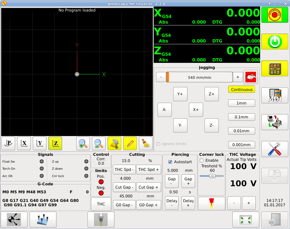

You will get a similar screen to the following: The design may variate depending on your config.
![images/gmoccapy_3_axis.png](images/gmoccapy_3_axis.png)

4.1. The DISPLAY Section
[DISPLAY]
DISPLAY = gmoccapy
PREFERENCE_FILE_PATH = gmoccapy_preferences
MAX_FEED_OVERRIDE = 1.5
MAX_SPINDLE_OVERRIDE = 1.2
MIN_SPINDLE_OVERRIDE = 0.5
LATHE = 1
BACK_TOOL_LATHE = 1
PROGRAM_PREFIX = ../../nc_files/
The most important part is to tell LinuxCNC to use gmoccapy, editing the [DISPLAY] section.
[DISPLAY]
DISPLAY = gmoccapy

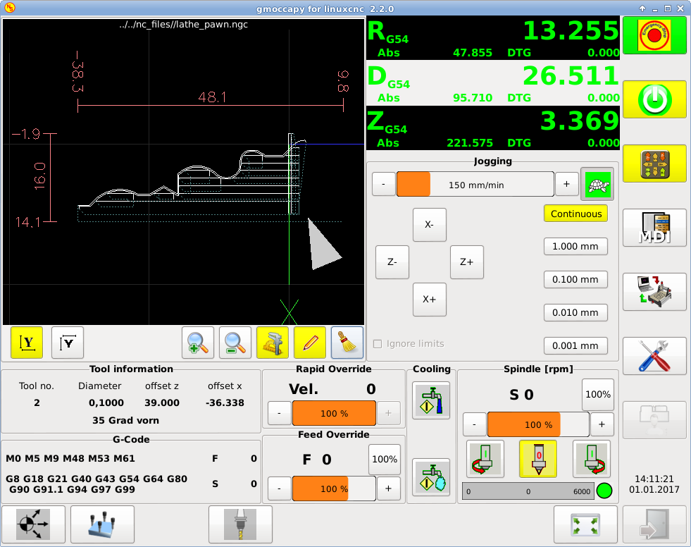

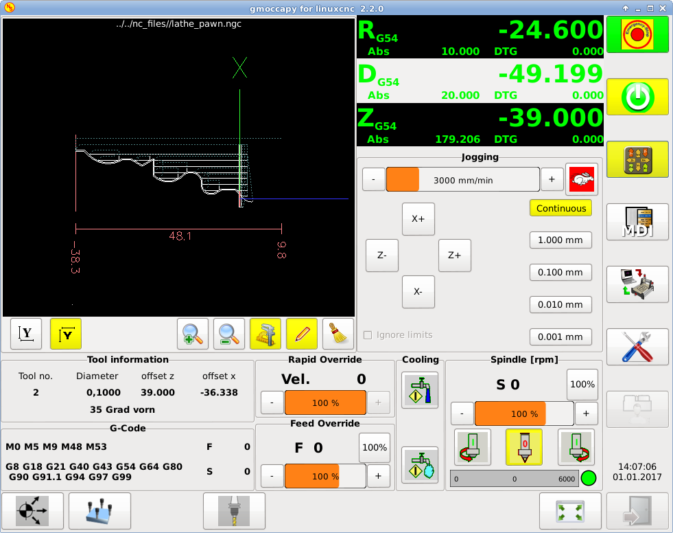

LATHE = 1
BACK_TOOL_LATHE = 1
The first line set the screen layout to control a lathe.
The second line is optional and will switch the X axis in a way you need for a back tool lathe. Also the keyboard shortcuts will react in a different way. It is allowed with gmoccapy to configuer a lathe also with additional axis, so you may use also a XZCW config for a lathe.
Tip
See also the Lathe Specific Section |

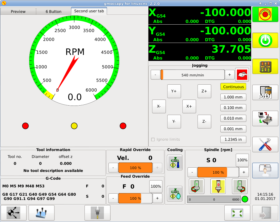

You can add embedded programs to gmoccapy like you can do in axis, touchy and gscreen. All is done by gmoccapy automatically if you include a few lines in your INI file in the DISPLAY section.
If you never used a glade panel, I recommend to read the excellent documentation. Glade VCP

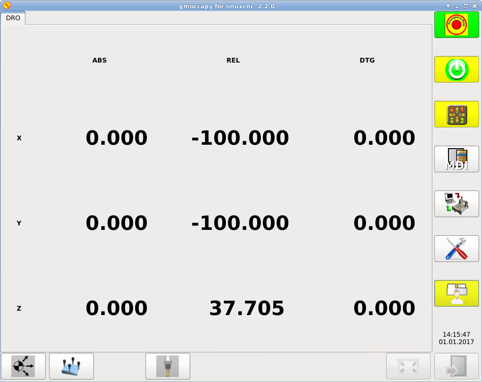

EMBED_TAB_NAME = DRO
EMBED_TAB_LOCATION = ntb_user_tabs
EMBED_TAB_COMMAND = gladevcp -x {XID} dro.glade
EMBED_TAB_NAME = Second user tab
EMBED_TAB_COMMAND = gladevcp -x {XID} vcp_box.glade
All you have to take care off, is that you include for every tab or side panel the mentioned three lines,
EMBED_TAB_NAME = Represents the name of the tab or side panel, it is up to you what name you use, but it must be present!
EMBED_TAB_LOCATION = Is the place where your program will be placed in the GUI.
ntb_user_tabs (as main tab, covering the complete screen)'
ntb_preview (as tab on the preview side)'
box_left (on the left, complete high of the screen)
box_right (on the right, in between the normal screen and the button list)
box_coolant_and_spindle (will hide the coolant and spindle frames and introduce your glade file here)
box_cooling (will hide the cooling frame and introduce your glade file)
box_spindle (will hide the spindle frame and introduce your glade file)
box_vel_info (will hide the velocity frames and introduce your glade file)
box_custom_1 (will introduce your glade file left of vel_frame)
box_custom_2 (will introduce your glade file left of cooling_frame)
box_custom_3 (will introduce your glade file left of spindle_frame)
box_custom_4 (will introduce your glade file right of spindle_frame)
See the different INI files included to see the differences
EMBED_TAB_COMMAND = the command to execute, i.e.
Includes a custom glade file called dro.glade in the mentioned location The file must be placed in the config folder of your machine.
gladevcp h_buttonlist.glade
Will just open a new user window called h_buttonlist.glade note the difference, this one is stand alone, and can be moved around independent from gmoccapy window.
gladevcp -c gladevcp -u hitcounter.py -H manual-example.hal manual-example.ui
Will add a the panel manual-example.ui, include a custom python handler, hitcounter.py and make all connections after realizing the panel according to manual-example.hal.
Note
If you make any hal connections to you custom glade panel, you need to do that in the hal file specified in the EMBEDDED_TAB_COMMAND line, otherwise you may get an error that the hal pin does not exist, this is because of race conditions loading the hal files. Connections to gmoccapy hal pin need to be made in the postgui hal file specified in your INI file, because this pin do not exist prior of realizing the GUI |

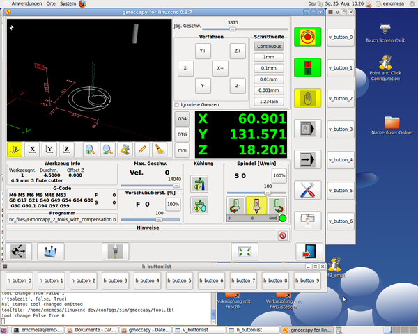

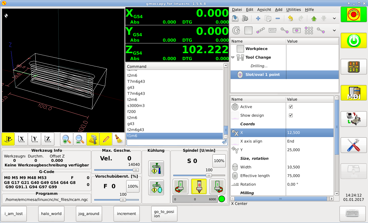

Here are some examples:
![images/gmoccapy_ntb_preview_maximized_2.png](images/gmoccapy_ntb_preview_maximized_2.png)
![images/gmoccapy_ntb_preview.png](images/gmoccapy_ntb_preview.png)
![images/gmoccapy_with_left_box_in_edit_mode.png](images/gmoccapy_with_left_box_in_edit_mode.png)
![images/gmoccapy_with_right_panel_in_MDI_mode.png](images/gmoccapy_with_right_panel_in_MDI_mode.png)

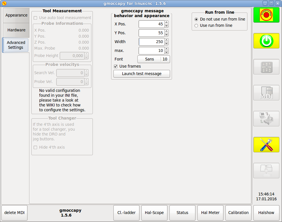

Gmoccapy has the ability to create hal driven user messages. To use them you need to introduce some lines in the [DISPLAY] section of the INI file.
Here is how to set up 3 user pop up message dialogs the messages support pango markup language. Detailed information about the markup language can be found at Pango Markup
MESSAGE_TEXT = The text to be displayed, may be pango markup formatted
MESSAGE_TYPE = "status" , "okdialog" , "yesnodialog"
MESSAGE_PINNAME = is the name of the hal pin group to be created
status : Will just display a message as pop up window, using the messaging system of gmoccapy
okdialog : Will hold focus on the message dialog and will activate a "-waiting" Hal_Pin OUT. Closing the message will reset the waiting pin
yesnodialog : Will hold focus on the message dialog and will activate a "-waiting" Hal_Pin bit OUT it will also give access to an "-response" Hal_Pin Bit Out, this pin will hold 1 if the user clicks OK, and in all other states it will be 0 Closing the message will reset the waiting pin The response Hal Pin will remain 1 until the dialog is called again
MESSAGE_TEXT = This is a <span background="#ff0000" foreground="#ffffff">
info-message</span> test
MESSAGE_TYPE = status
MESSAGE_PINNAME = statustest
MESSAGE_TEXT = This is a yes no dialog test
MESSAGE_TYPE = yesnodialog
MESSAGE_PINNAME = yesnodialog
MESSAGE_TEXT = Text can be <small>small</small>, <big>big</big>, <b>bold</b <i>italic</i>, and even be <span color="red">colored</span>.
MESSAGE_TYPE = okdialog
MESSAGE_PINNAME = okdialog
The specific hal pin conventions for these can be found under the User Messages hal pin section.

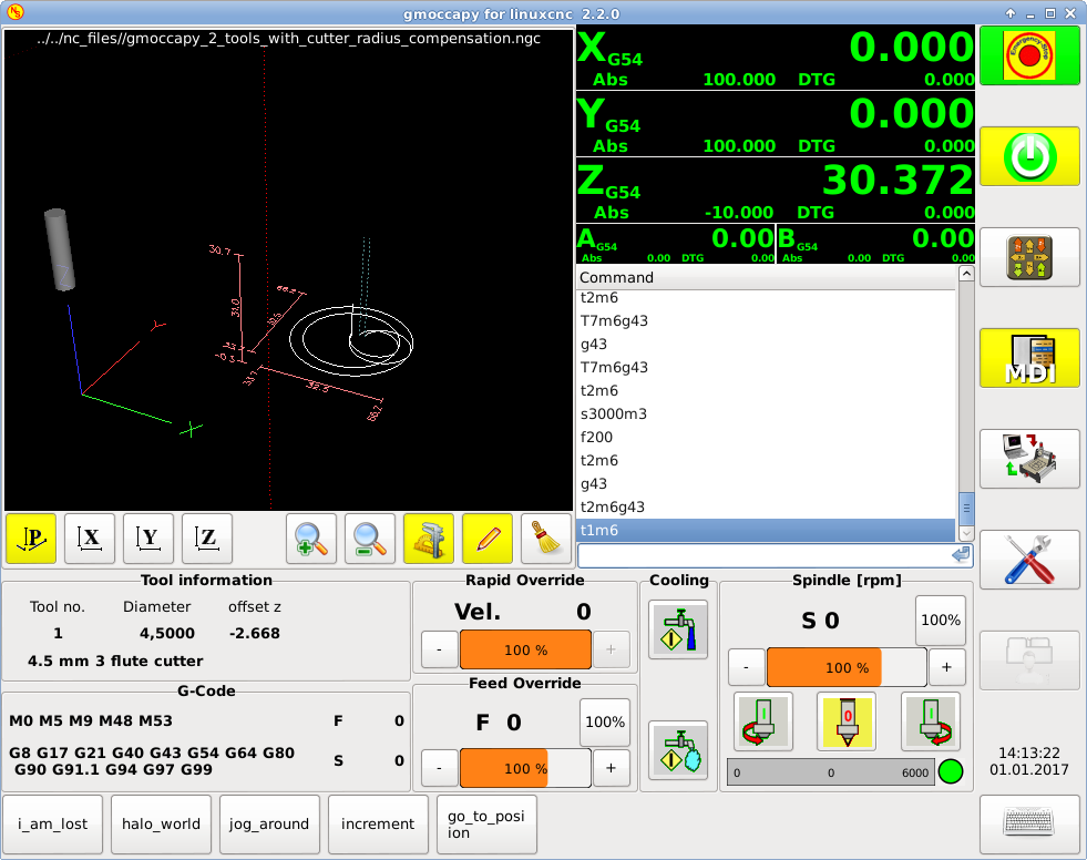

4.3. The MACRO Section
You can add macros to gmoccapy, similar to touchy’s way. A macro is nothing else than a ngc-file. You are able to execute complete CNC programs in MDI mode, by just pushing one button. To do so, you have to add a section like so:
[MACROS]
MACRO = i_am_lost
MACRO = hello_world
MACRO = jog_around
MACRO = increment xinc yinc
MACRO = go_to_position X-pos Y-pos Z-pos
This will add 5 macros to the MDI button list.
Note
As maximum 16 macros will appear in the GUI, due to space reasons you may need to click on an arrow to switch page and display hidden macro button. It is no error placing more in your INI file. The macro button will be displayed in the order of the INI entries. |

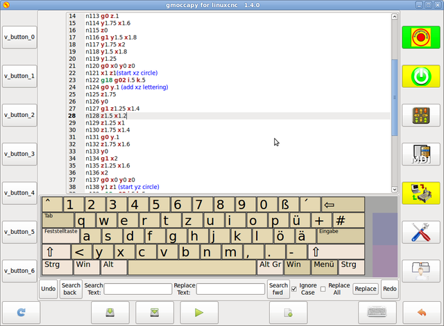

![images/gmoccapy_mdi_hidden_keyboard.png](images/gmoccapy_mdi_hidden_keyboard.png)

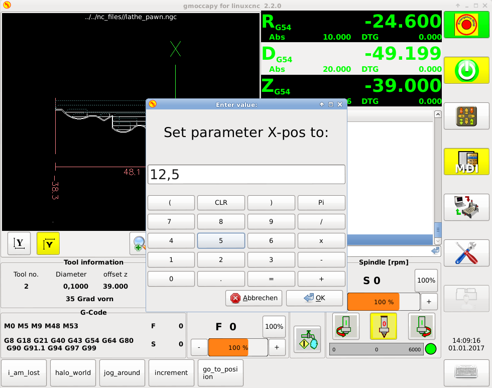

Gmoccapy will also accept macros asking for parameters like:
The parameters must be separated by spaces. This calls a file go_to_position.ngc with the following content:
; Test file go to position
; will jog the machine to a given position
O<go_to_position> sub
G17
G21
G54
G61
G40
G49
G80
G90
;#1 = <X-Pos>
;#2 = <Y-Pos>
;#3 = <Z-Pos>
(DBG, Will now move machine to X = #1 , Y = #2 , Z = #3)
G0 X #1 Y #2 Z #3
O<go_to_position> endsub
M2
After pushing the execute macro button, you will be asked to enter the values for X-pos Y-pos Z-pos and the macro will only run if all values have been given.

in settings mode:
gmoccapy.h-button.button-0 == delete MDI history
gmoccapy.h-button.button-1 ==
gmoccapy.h-button.button-2 ==
gmoccapy.h-button.button-3 ==
gmoccapy.h-button.button-4 == open classic ladder
gmoccapy.h-button.button-5 == open hal scope
gmoccapy.h-button.button-6 == open hal status
gmoccapy.h-button.button-7 == open hal meter
gmoccapy.h-button.button-8 == open hal calibration
gmoccapy.h-button.button-9 == open hal show

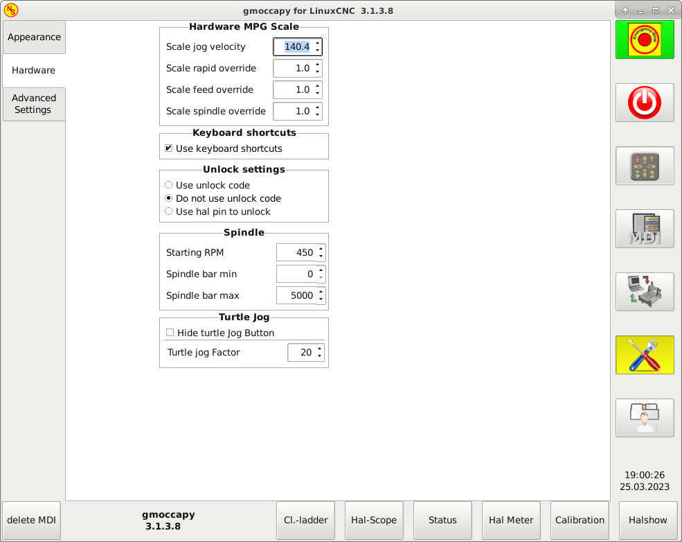

5.2. Velocities And Overrides
All sliders from gmoccapy can be connected to hardware encoder or hardware potentiometers.
Note
for gmoccapy 3 the hal pin name has changed, as new controls has been implemented, max velocity does not exist any more, as rapid override has been implemented. This change has been done as many user ask for that. |
To connect encoders the following pin are exported:
gmoccapy.jog.jog-velocity.counts = HAL_S32 Jog velocity
gmoccapy.jog.jog-velocity.count-enable = HAL_BIT Must be True, to enable counts
gmoccapy.feed.feed-override.counts = HAL_S32 feed override
gmoccapy.feed.feed-override.count-enable = HAL_BIT Must be True, to enable counts
gmoccapy.feed.reset-feed-override = HAL_BIT reset the feed override to 100 %
gmoccapy.spindle.spindle-override.counts = HAL_S32 spindle override
gmoccapy.spindle.spindle-override.count-enable = HAL_BIT Must be True, to enable counts
gmoccapy.spindle.reset-spindle-override = HAL_BIT reset the spindle override to 100 %
gmoccapy.rapid.rapid-override.counts = HAL_S32 Maximal Velocity of the machine
gmoccapy.rapid.rapid-override.count-enable = HAL_BIT Must be True, to enable counts
To connect potentiometers, use the following hal pin:
gmoccapy.jog.jog-velocity.direct-value = HAL_FLOAT To adjust the jog velocity slider
gmoccapy.jog.jog-velocity.analog-enable = HAL_BIT Must be True, to allow analog inputs
gmoccapy.feed.feed-override.direct-value = HAL_FLOAT To adjust the feed override slider
gmoccapy.feed.feed-override.analog-enable = HAL_BIT Must be True, to allow analog inputs
gmoccapy.spindle.spindle-override.direct-value = HAL_FLOAT To adjust the spindle override slider
gmoccapy.spindle.spindle-override.analog-enable = HAL_BIT Must be True, to allow analog inputs
gmoccapy.rapid.rapid-override.direct-value = HAL_FLOAT To adjust the max velocity slider
gmoccapy.rapid.rapid-override.analog-enable = HAL_BIT Must be True, to allow analog inputs
In addition gmoccapy 3 offers additional hal pin to control the new slider widgets with momentary switches. The values how fast the increase or decrease will be, must be set in the glade file. In a future release it will be integrated in the settings page.
gmoccapy.spc_jog_vel.increase = HAL_BIT IN as long as True the value of the slider will increase
gmoccapy.spc_jog_vel.decrease = HAL_BIT IN as long as True the value of the slider will decrease
gmoccapy.spc_jog_vel.scale = HAL_FLOAT IN A value to scale the output value (Handy to change units/min to units/sec
gmoccapy.spc_jog_vel.value = HAL_FLOAT OUT value of the widget
gmoccapy.spc_jog_vel.scaled-value = HAL_FLOAT OUT scaled value of the widget
gmoccapy.spc_feed.increase = HAL_BIT IN as long as True the value of the slider will increase
gmoccapy.spc_feed.decrease = HAL_BIT IN as long as True the value of the slider will decrease
gmoccapy.spc_feed.scale = HAL_FLOAT IN A value to scale the output value (Handy to change units/min to units/sec
gmoccapy.spc_feed.value = HAL_FLOAT OUT value of the widget
gmoccapy.spc_feed.scaled-value = HAL_FLOAT OUT scaled value of the widget
gmoccapy.spc_spindle.increase = HAL_BIT IN as long as True the value of the slider will increase
gmoccapy.spc_spindle.decrease = HAL_BIT IN as long as True the value of the slider will decrease
gmoccapy.spc_spindle.scale = HAL_FLOAT IN A value to scale the output value (Handy to change units/min to units/sec
gmoccapy.spc_spindle.value = HAL_FLOAT OUT value of the widget
gmoccapy.spc_spindle.scaled-value = HAL_FLOAT OUT scaled value of the widget
gmoccapy.spc_rapid.increase = HAL_BIT IN as long as True the value of the slider will increase
gmoccapy.spc_rapid.decrease = HAL_BIT IN as long as True the value of the slider will decrease
gmoccapy.spc_rapid.scale = HAL_FLOAT IN A value to scale the output value (Handy to change units/min to units/sec
gmoccapy.spc_rapid.value = HAL_FLOAT OUT value of the widget
gmoccapy.spc_rapid.scaled-value = HAL_FLOAT OUT scaled value of the widget
The float pin do accept values from 0.0 to 1.0, being the percentage value you want to set the slider value.
[WARNING] If you use both connection types, do not connect the same slider to both pin, as the influences between the two has not been tested! Different sliders may be connected to the one or other hal connection type.
[IMPORTANT] Please be aware, jog velocity depends on the turtle button state, it will lead to different slider scales depending on the mode (turtle or rabbit). Please take also a look to jog velocities and turtle-jog hal pin for more details.
Spindle Override Min Value = 20 %
Spindle Override Max Value = 120 %
gmoccapy.analog-enable = 1
gmoccapy.spindle-override-value = 0.25
value to set = Min Value + (Max Value - Min Value) * gmoccapy.spindle-override-value
value to set = 20 + (120 - 20) * 0.25
value to set = 45 %

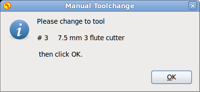

This pin are provided to use gmoccapy’s internal tool change dialog, similar to the one known from axis, but with several modifications, so you will not only get the message to change to tool number 3, but also the description of that tool like 7.5 mm 3 flute cutter. The information is taken from the tool table, so it is up to you what to display.
![images/manual_toolchange.png](images/manual_toolchange.png)
gmoccapy.toolchange-number HAL_S32 The number of the tool to be changed
gmoccapy.toolchange-change HAL_BIT Indicate that a tool has to be changed
gmoccapy.toolchange-changed HAL_BIT Indicate toll has been changed
Usually they are connected like this for a manual tool change:
net tool-change gmoccapy.toolchange-change <= iocontrol.0.tool-change
net tool-changed gmoccapy.toolchange-changed <= iocontrol.0.tool-changed
net tool-prep-number gmoccapy.toolchange-number <= iocontrol.0.tool-prep-number
net tool-prep-loop iocontrol.0.tool-prepare <= iocontrol.0.tool-prepared

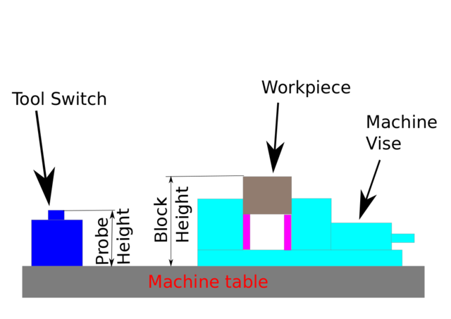

Tool Measurement in gmoccapy is done a little bit different to many other GUI. You should follow these steps:
touch of you workpiece in X and Y
measure the hight of your block from the base where your tool switch is located, to the upper face of the block (including chuck etc.)
Push the button block height and enter the measured value
Go to auto mode and start your program
here is a small sketch:
![images/sketch_auto_tool_measurement.png](images/sketch_auto_tool_measurement.png)
With the first given tool change the tool will be measured and the offset will be set automatically to fit the block height. The advantage of the gmoccapy way is, that you do not need a reference tool.

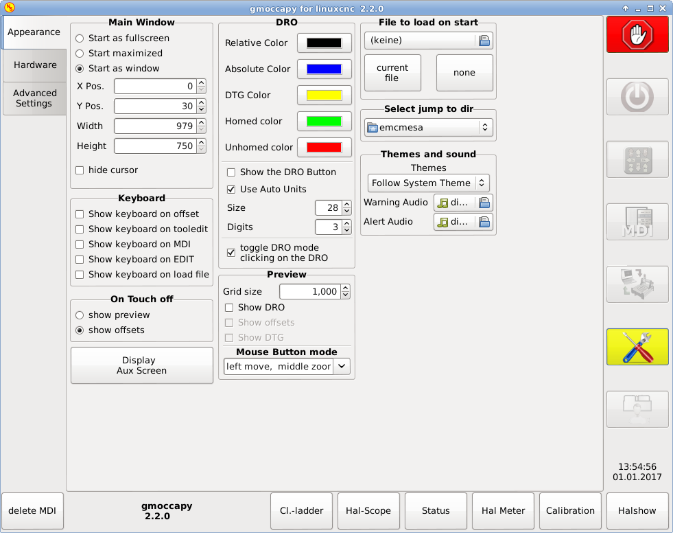

7.1. Appearance
![images/gmoccapy_settings_appearance.png](images/gmoccapy_settings_appearance.png)
On this tab you will find the following options:
- Main Window
Here you can select how you wish the GUI to start. The main reason for this was the wish to get an easy
way for the user to set the starting options without the need to touch code.
You have three options:
start as full screen
start maximized
start as window
If you select start as window the spinboxes to set the position and size will get active.
One time set, the GUI will start every time on the place and with the size selected.
Nevertheless the user can change the size and position using the mouse, but that will
not have any influence on the settings.
hide the cursor does allow to hide the cursor, what is very useful if you use a touch screen.
- Keyboard
The check-boxes allows the user to select if he want the on board keyboard to be shown immediately,
when entering the MDI Mode, when entering the offset page, the tooledit widget or when open a program
in the EDIT mode. The keyboard button on the bottom button list will not been affected by this settings,
so you be able to show or hide the keyboard by pressing the button. The default behavior will be set by
the check-boxes.
Default are :
Note
If this section is not sensitive, you have not installed a virtual keyboard, + supported are onboard and matchbox-keyboard. |
show keyboard on offset = True
show keyboard on tooledit = False
show keyboard on MDI = True
show keyboard on EDIT = True
show keyboard on load file = False
If the keyboard layout is not correct, i.e. clicking X gives Z, than the layout has not been set properly, related to your locale settings. For onboard it can be solved with a small batch file with the following content:
#!/bin/bash
setxkbmap -model pc105 -layout de -variant basic
The letters "de" are for German, you will have to set them according to your locale settings. Just execute this file before starting LinuxCNC, it can be done also adding a starter to your local folder.
./config/autostart
So that the layout is set automatically on starting.
For matchbox-keyboard you will have to make your own layout, for a German layout ask in the forum.
- On Touch Off
give the option to show the preview tab or the offset page tab if you enter the touch off mode by clicking the corresponding bottom button.
show preview
show offsets
As the notebook tabs are shown, you are able to switch between both views in any case.
- DRO Options
You have the option to select the background colors of the different DRO states. So users suffering from protanopia (red/green weakness) are able to select proper colors
By default the backgrounds are:
Relative mode = black
Absolute mode = blue
Distance to go = yellow
The foreground color of the DRO can be selected with:
homed color = green
unhomed color = red
show dro in preview
the DRO will be shown in the preview window +
show offsets+
the Offsets will be shown in the preview window +
show DTG
the distance to go will be shown in the preview window +
Note
You can change through the DRO modes (absolute, relative, distance to go) by clicking on the DRO! * if you click on the left side letter of the DRO a popup window will allow you to set the value of the axis, making it more easy to set the value, as you will not need to go over the touch off botton button. Clicking the numbers (right side of the DRO) will toggle trough the DRO modes as descibed above. * |
size
allows to set the size of the DRO font, default is 28, if you use a bigger screen you may want to increase the size up to 56.
If you do use 4 axis, the DRO font size will be 3/4 of the value, because of space reason. +
digits
sets the number of digits of the DRO from 1 to 5.
Note
Imperial will show one digit more that metric. So if you are in imperial machine units and set the digit value to 1, you will get no digit at all in metric. |
toggle DRO mode
if not active, a mouse click on the DRO will not take any action.
By default this checkbox is active, so every click on any DRO will toggle the DRO readout from actual to relative to DTG (distance to go).
Neverthereless a click on the axis letter will open the popup dialog to set the axis value +
- Preview
Grid Size Sets the grid size of the preview window. Unfortunately the size has to be set in inches, even if your machine units are metric. We do hope to fix that in a future release.
[NOTE] The grid will not be shown in perspective view.
Show DRO
Will show the a DRO also in the preview window, it will be shown automatically in fullsize preview
Show DTG will show also the DTG (direct distance to end point) in the preview, only if Show DRO is active and not full size preview.
Show Offsets will show the offsets in the preview window.
[NOTE] If you only check this option and leave the others unchecked, you will get in full size preview a offset page
Mouse Button Mode this combobox you can select the button behavior of the mouse to rotate, move or zoom within the preview.
left rotate, middle move, right zoom
left zoom, middle move, right rotate
left move, middle rotate, right zoom
left zoom, middle rotate, right move
left move, middle zoom, right rotate
left rotate, middle zoom, right move
Default is left move, middle zoom, right rotate.
The mouse wheel will still zoom the preview in every mode.
Tip
If you select an element in the preview, the selected element will be taken as rotation center point and in auto mode the corresponding code line will be highlighted. |
- File to load on start up
Select the file you want to be loaded on start up. In other GUI changing this was very cumbersome, because the users where forced to edit the INI File.
Select the file you want to be loaded on start up. If a file is loaded, it can be set by pressing the current button to avoid that any program is loaded at start up, just press the None button.
The file selection screen will use the filters you have set in the INI File, if there aren’t any filters given, you will only see ngc files. The path will be set according to the INI settings in [DISPLAY] PROGRAM_PREFIX
- Jump to dir
you can set here the directory to jump to if you press the corresponding button in the file selection dialog.
![images/gmoccapy_file_selection_dialog_with_keyboard.png](images/gmoccapy_file_selection_dialog_with_keyboard.png)
- Themes and Sounds
This lets the user select what desktop theme to apply and what error and messages sounds should be played. By default "Follow System Theme" is set.
7.2. Hardware
![images/gmoccapy_settings_hardware.png](images/gmoccapy_settings_hardware.png)
- Hardware MPG Scales
For the different Hal Pin to connect MPG Wheels to, you may select individual scales to be applied. The main reason for this was my own test to solve this through hal connections, resulting in a very complex hal file. Imagine a user having an MPG Wheel with 100 ipr and he wants to slow down the max vel from 14000 to 2000 mm/min, that needs 12000 impulses, resulting in 120 turns of the wheel! Or an other user having a MPG Wheel with 500 ipr and he wants to set the spindle override witch has limits from 50 to 120 % so he goes from min to max within 70 impulses, meaning not even 1/4 turn.
By default all scales are set using the calculation:
(MAX - MIN)/100
- Keyboard shortcuts
Some users want to jog there machine using the keyboard buttons and there are others that will never allow this. So everybody can select whether to use them or not. It is not recommended to use keyboard jogging, as it represents a serious risk for operator and machine.
Default is not to use keyboard shortcuts.
Please take care if you use a lathe, than the shortcuts will be different. See the Lathe section
Arrow Left or NumPad_Left = X minus
Arrow Right or NumPad_Right = X plus
Arrow up or NumPad_Up = Y plus
Arrow Down or NumPad_Down = Y minus
Page Up or NumPad_Page_Up = Z plus
Page Down or NumPad_Page_Down = Z minus
F1 = Estop (will work even if keyboard shortcuts are disabled)
F2 = Machine on
F3 = manual mode
F5 = MDI mode
ESC = Abort
In AUTO Mode we will allow the following key shortcuts * R or r = run program * P or p = pause program * S or s = resume program * Control and R or r will reload the loaded file
There are additional keys for message handling, see Message behavior and appearance
WINDOWS = Delete last message
<STRG><SPACE> = Delete all messages
- Unlock options
There are three options to unlock the settings page:
use unlock code (the user must give a code to get in)
Do not use unlock code (There will be no security check)
Use hal pin to unlock (hardware pin must be high to unlock the settings, see hardware unlock pin
Default is use unlock code (default = 123)
- Spindle
The start RPM sets the rpm to be used if the spindle is started and no S value has been set.
Note
This value will be preseted according to your settings in [DISPLAY] DEFAULT_SPINDLE_SPEED of your INI. If you change the settings on the settings page, that value will be default from that moment, your INI File will not be modified. |
With the MIN and MAX settings you set the limits of the spindle bar shown in the INFO frame on the main screen. It is no error giving wrong values. If you give a maximum of 2000 and your spindle makes 4000 rpm, only the bar level will be wrong on higher speeds than 2000 rpm.
default values are
MIN = 0
MAX = 6000
- Turtle Jog
This settings will have influence on the jog velocities.
hide turtle jog button will hide the button right of the jog velocity slider, if you hide this button, please take care that it shows the rabbit icon, otherwise you will not be able to jog faster than the turtle jog velocity, which is calculated using the turtle jog factor.
Turtle jog factor sets the scale to apply for turtle jog mode. If you set a factor of 20, the turtle max jog velocity will be 1/20 of max velocity of the machine if in turtle mode (button pressed, showing the turtle)
Note
This button can be activated using the turtle-jog hal pin. |
7.3. Advanced Settings
![images/gmoccapy_settings_advanced.png](images/gmoccapy_settings_advanced.png)
Note
Tool Measurement If this part is not sensitive, you do not have a valid INI file configuration
to use tool measurement. |
Please check Auto Tool Measurement
Use auto tool measurement : If checked, after each tool change, a tool measurement will be done, the result will be stored in the tool table and an G43 will be executed after the change.
The following informations are taken from your INI file and must be given in absolute coordinates
X Pos. = The X position of the tool switch
Y Pos. = The Y position of the tool switch
Z Pos. = The Z position of the tool switch, we will go as rapid move to this coordinate
Max. Probe = is the distance to search for contact, an error will be launched, if no contact is given. The distance has to be given in relative coordinates, beginning the move from Z Pos., so you have to give a negative value to go down!
Probe Height = is the height of your probe switch, you can measure it. Just touch off the base where the probe switch is located and set that to zero. Then make a tool change and watch the tool_offset_z value, that is the hight you must enter here.
Search Vel. = The velocity to search for the tool switch, after contact the tool will go up again and then goes toward the probe again with probe vel, so you will get better results.
Probe Vel. = Is the velocity for the second movement to the switch, it should be slower to get better touch results.(In sim mode, this is commented out in macros/change.ngc, otherwise the user would have to click twice on the probe button)
If checked, the tool in spindle will be saved on each change in the preference file, making it possible to reload the last mounted tool on start up. The tool will be loaded after all axis are homed, because before it is not allowed to execute MDI commands. If you use NO_FORCE_HOMING you can not use this feature, because the needed all_homed_signal will never be emitted.
This will display small pop up windows displaying the message or error text, the behavior is very similar to the one axis uses. You can delete a specific message, by clicking on it’s close button, if you want to delete the last one, just hit the WINDOWS key on your keyboard, or delete all messages at ones with <STRG><SPACE>.
You are able to set some options:
X Pos = The position of the top left corner of the message in X counted in pixel from the top left corner of the screen.
Y Pos = The position of the top left corner of the message in Y counted in pixel from the top left corner of the screen.
Width = The width of the message box
max = The maximum messages you want to see at ones, if you set this to 10, the 11th message will delete the first one, so you will only see the last 10 ones.
Font = The font and size you want to use to display the messages
use frames = If you activate the checkbox, each message will be displayed in a frame, so it is much easier to distinguish the messages. But you will need a little bit more space.
The button launch test message will just do what it is supposed to, it will show a message, so you can see the changes of your settings without the need to generate an error.
You can allow or disallow the run from line. This will set the corresponding button insensitive (grayed out), so the user will not be able to use this option. The default is disable run from line.
Warning
It is not recommend to use run from line, as LinuxCNC will not take care of any previous lines in the code before the starting line. So errors or crashes are very probable. |
8. Lathe Specific Section
If in the INI File LATHE = 1 is given, the GUI will change its appearance to the special needs for a lathe. Mainly the Y axis will be hidden and the jog buttons will be arranged in a different order.
![images/gmoccapy_lathe.png](images/gmoccapy_lathe.png)
![images/gmoccapy_back_tool_lathe.png](images/gmoccapy_back_tool_lathe.png)
As you see the R DRO has a black background and the D DRO is gray. This will change according to the active G-Code G7 or G8. The active mode is visible by the black background, meaning in the shown images G8 is active.
The next difference to the standard screen is the location of the Jog Button. X and Z have changed places and Y is gone. You will note that the X+ and X- buttons changes there places according to normal or back tool lathe.
Also the keyboard behavior will change:
Normal Lathe:
Arrow Left or NumPad_Left = Z minus
Arrow Right or NumPad_Right = Z plus
Arrow up or NumPad_Up = X minus
Arrow Down or NumPad_Down = X plus
Back Tool Lathe:
Arrow up or NumPad_Up = X plus
Arrow Down or NumPad_Down = X minus
The tool information frame will show not only the Z offset, but also the X offset and the tool table is showing all lathe relevant information.

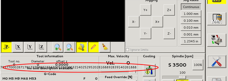

11.1. Strange numbers in the info area
If you get strange numbers in the info area of gmoccapy like:
![images/strange_numbers.png](images/strange_numbers.png)
You have made your config file using an older version of StepConfWizard. It has made a wrong entry in the INI file under the [TRAJ] named MAX_LINEAR_VELOCITY = xxx. Change that entry to MAX_VELOCITY = xxx
