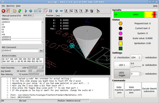

Run the sample GladeVCP panel integrated into Axis like PyVCP as follows:
$ cd configs/sim/axis/gladevcp
$ linuxcnc gladevcp_panel.ini

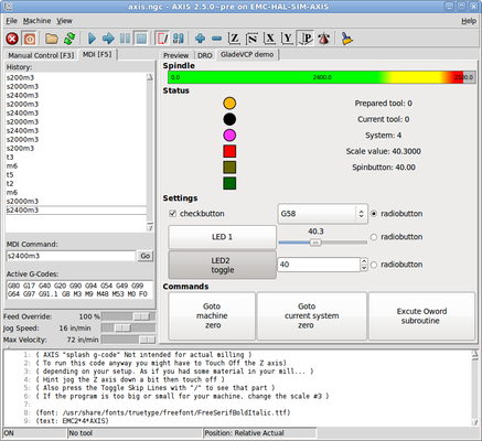

Run the same panel, but as a tab inside Axis:
$ linuxcnc gladevcp_tab.ini
images/example-tabbed-small.png

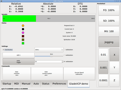

To run this panel inside Touchy:
$ cd configs/sim/touchy/gladevcp
$ linuxcnc gladevcp_touchy.ini
images/touchy-tab-33.png
Functionally these setups are identical - they only differ in screen real estate requirements and visibility. Since it is possible to run several GladeVCP components in parallel (with different HAL component names), mixed setups are possible as well - for instance a panel on the right hand side, and one or more tabs for less-frequently used parts of the interface.
2.1. Exploring the example panel
While running configs/sim/axis/gladevcp_panel.ini or configs/sim/axis/gladevcp_tab.ini, explore Show HAL Configuration - you will find the gladevcp HAL component and may observe their pin values while interacting with the widgets in the panel. The HAL setup can be found in configs/axis/gladevcp/manual-example.hal.
The example panel has two frames at the bottom. The panel is configured so that resetting ESTOP activates the Settings frame and turning the machine on enables the Commands frame at the bottom. The HAL widgets in the Settings frame are linked to LEDs and labels in the Status frame, and to the current and prepared tool number - play with them to see the effect. Executing the T<toolnumber> and M6 commands in the MDI window will change the current and prepared tool number fields.
The buttons in the Commands frame are MDI Action widgets - pressing them will execute an MDI command in the interpreter. The third button Execute Oword subroutine is an advanced example - it takes several HAL pin values from the Settings frame, and passes them as parameters to the Oword subroutine. The actual parameters received by the routine are displayed by (DEBUG, ) commands - see ../../nc_files/oword.ngc for the subroutine body.
To see how the panel is integrated into Axis, see the [DISPLAY]GLADEVCP statement in configs/sim/axis/gladevcp/gladevcp_panel.ini, the [DISPLAY]EMBED* statement in configs/sim/axis/gladevcp/gladevcp_tab.ini and [HAL]POSTGUI_HALFILE statements in both configs/sim/axis/gladevcp/gladevcp_tab.ini and configs/sim/axis/gladevcp/gladevcp_panel.ini

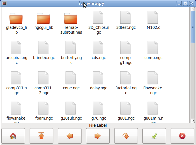

6.23. IconView (File Select)
This is touch screen friendly widget to select a file and to change directories.
The widget has the following properties:
icon_size
Sets the size of the displayed icon.
Allowed values are integers in the range from 12 to 96
default is 48
start_dir
Sets the directory to start in when the widget is shown first time,
must be a string, containing a valid directory path,
default is "/"
jump_to_dir
Sets the directory "jump to" directory, witch is selected by the corresponding button in the bottom button list, the 5th button counting from the left,
default is "~"
filetypes
Sets the file filter for the objects to be shown
Must be a string containing a comma separated list of extensions to be shown
Default is "ngc,py"
sortorder
Sets the sorting order of the displayed icon must be an integer value from 0 to 3, where
0 = ASCENDING (sorted according to file names)
1 = DESCENDING (sorted according to file names)
2 = FOLDERFIRST (show the folders first, then the files)
3 = FILEFIRST (show the files first, then the folders),
Default = 2 = FOLDERFIRST
Direct program control
Using goobject to set the above listed properties:
[widget name].set_property(property,Value)
There are python methods to control the widget:
[widget name].show_buttonbox(state)
    if False the bottom button box will be hidden, this is helpful in custom screens,
    with special buttons layouts to not alter the layout of the GUI, good example
    for that is gmoccapy
    state = boolean (True or False)
    Default is True
[widget name].show_filelabel(state)
    if True the file label (between the IconView window and the bottom button box will be shown.
    Hiding this label may save place, but showing it is very useful for debugging reasons,
    Default is True
[widget name].set_icon_size(iconsize)
    sets the icon size
    must be an integer in the range from 12 to 96
    Default = 48
[widget name].set_directory(directory)
    Allows to set an directory to be shown
    directory = string (a valid file path)
[widget name].set_filetypes(filetypes)
    sets the file filter to be used, only files with the given extensions will be shown
    filetypes = string containing a comma separated list of extensions
    Default = "ngc,py"
[widget name].get_selected()
    Returns the path of the selected file, or None if an directory has been selected
[widget name].refresh_filelist()
    Refreshes the filelist, needed if you add a file without changing the directory
If the button box has been hidden, you can reach the functions of this button through it’s clicked signals like so:
[widget name].btn_home.emit("clicked")
[widget name].btn_jump_to.emit("clicked")
[widget name].btn_sel_prev.emit("clicked")
[widget name].btn_sel_next.emit("clicked")
[widget name].btn_get_selected.emit("clicked")
[widget name].btn_dir_up.emit("clicked")
[widget name].btn_exit.emit("clicked")
The widget will emit the following signals:
selected
    This signal is emitted, when the user selects an icon, it will return a string containing a
    file path if a file has been selected, or None if an directory has been selected
sensitive
    This signal is emitted, when the buttons change there state from sensitive to not sensitive or vice versa.
    This signal is useful to maintain surrounding GUI synchronized with the button of the widget. See gmoccapy as example.
    It will return the buttonname and the new state. Buttonname is one of "btn_home", "btn_dir_up", "btn_sel_prev",
    "btn_sel_next", "btn_jump_to" or "btn_select". State is a boolean and will be True or False.
exit
    This signal is Emmit, when the exit button has been pressed to close the IconView
    mostly needed if the application is started as stand alone.
Example:
images/iconview.png

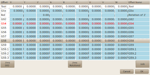

6.26. Offsetpage
The Offsetpage widget is used to display/edit the offsets of all the axes.
It has convenience buttons for zeroing G92 and Rotation-Around-Z offsets.
It will only allow you to select the edit mode when the machine is on and idle.
You can directly edit the offsets in the table at this time. Unselect the edit
button to allow the OffsetPage to reflect changes.
It has the following properties:
Hidden Columns
A no-space list of columns to hide: The columns are designated (in order) as such:
xyzabcuvwt
You can hide any of the columns.
Hidden Rows
A no-space list of rows to hide: the rows are designated (in order) as such
0123456789abc
You can hide any of the rows.
Pango Font
Sets text font type and size
HighLight color
when editing this is the high light color
Active color
when OffsetPage detects an active user coordinate system it will use this
color for the text
Text template for metric units
You can use python formatting to display the position with different precision.
Text template for imperial units
There a couple ways to directly control the widget using Python.
[widget name].set_property("highlight_color",gtk.gdk.Color('blue'))
[widget name].set_property("foreground_color",gtk.gdk.Color('black'))
[widget name].set_property("hide_columns","xyzabcuvwt")
[widget name].set_property("hide_rows","123456789abc")
[widget name].set_property("font","sans 25")
[widget name].set_filename("../../../configs/sim/gscreen/gscreen_custom/sim.var")
[widget name].set_col_visible("Yabuvw",False)
[widget name].set_row_visible("456789abc",False)
[widget name].set_to_mm()
[widget name].set_to_inch()
[widget name].hide_button_box(True)
[widget name].set_font("sans 20")
[widget name].set_highlight_color("violet")
[widget name].set_foreground_color("yellow")
[widget name].mark_active("G55")
    Allows you to directly set a row to highlight.
    (eg in case you wish to use your own navigation controls.
    See <<cha:gmoccapy,Gmoccapy Chapter>>
[widget name].selection_mask = ("Tool","Rot","G5x")
    These rows are NOT selectable in edit mode.
[widget name].set_names([['G54','Default'],["G55","Vice1"],['Rot','Rotational']])
    This allows you to set the text of the 'T' column of each/any row.
    This is a list of a list of offset-name/user-name pairs.
    The default text is the same as the offset name.
[widget name].get_names()
    This returns a list of a list of row-keyword/user-name pairs.
    The user name column is editable, so saving this list is user friendly.
    see set_names above.
images/offsetpage.png

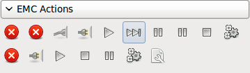

7. Action Widgets reference
GladeVcp includes a collection of "canned actions" called VCP Action Widgets for the Glade user interface editor. Other than HAL widgets, which interact with HAL pins, VCP Actions interact with LinuxCNC and the G-code interpreter.
VCP Action Widgets are derived from the Gtk.Action widget. The Action widget in a nutshell:
  • it is an object available in Glade
  • it has no visual appearance by itself
  • it’s purpose: associate a visible, sensitive UI component like menu, toolbutton, button with a command. See these widget’s General→Related Action property.
  • the "canned action" will be executed when the associated UI component is triggered (button press, menu click..)
  • it provides an easy way to execute commands without resorting to Python programming.
The appearance of VCP Actions in Glade is roughly as follows:
images/vcp-actions.png
Tooltip hovers provide a description.

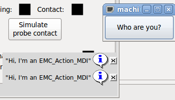

7.3. The Action_MDI Toggle and Action_MDI widgets
These widgets provide a means to execute arbitrary MDI commands. The Action_MDI widget does not wait for command completion as the Action_MDI Toggle does, which remains disabled until command complete.
7.4. A simple example: Execute MDI command on button press
configs/apps/gladevcp/mdi-command-example/whoareyou.ui is a Glade UI file which conveys the basics:
Open it in Glade and study how it’s done. Start Axis, and then start this from a terminal window with gladevcp whoareyou.ui. See the hal_action_mdi1 Action and it’s MDI command property - this just executes (MSG, "Hi, I’m an VCP_Action_MDI") so there should be a message popup in Axis like so:
images/whoareyou.png
You’ll notice that the button associated with the Action_MDI action is grayed out if the machine is off, in E-Stop or the interpreter is running. It will automatically become active when the machine is turned on and out of E-Stop, and the program is idle.

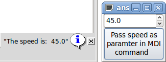

  • assume you have a HAL SpinBox named speed, and you want to pass it’s current value as a parameter in an MDI command.
  • The HAL SpinBox will have a float-type HAL pin named speed-f (see HalWidgets description).
  • To substitute this value in the MDI command, insert the HAL pin name enclosed like so: ${pin-name}
  • for the above HAL SpinBox, we could use (MSG, "The speed is: ${speed-f}") just to show what’s happening.
The example UI file is configs/apps/gladevcp/mdi-command-example/speed.ui. Here’s what you get when running it:
images/speed.png

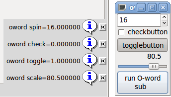

7.6. An advanced example: Feeding parameters to an O-word subroutine
It’s perfectly OK to call an O-word subroutine in an MDI command, and pass HAL pin values as actual parameters. An example UI file is in configs/apps/gladevcp/mdi-command-example/owordsub.ui.
Place nc_files/gladevcp_lib/oword.ngc so Axis can find it, and run gladevcp owordsub.ui from a terminal window. This looks like so:

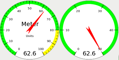

With glade, widget properties are typically set fixed while editing. You can, however, set widget properties at runtime, for instance from ini file values, which would typically be done in the handler initialization code. Setting properties from HAL pin values is possible, too.
In the following example (assuming a HAL Meter widget called meter), the meter’s min value is set from an INI file parameter at startup, and the max value is set via a HAL pin, which causes the widget’s scale to readjust dynamically:
import linuxcnc
import os
import hal
import hal_glib
class HandlerClass:
    def _on_max_value_change(self,hal_pin,data=None):
        self.meter.max = float(hal_pin.get())
        self.meter.queue_draw() # force a widget redraw
    def __init__(self, halcomp,builder,useropts):
  self.builder = builder
        # hal pin with change callback.
        # When the pin's value changes the callback is executed.
        self.max_value = hal_glib.GPin(halcomp.newpin('max-value',  hal.HAL_FLOAT, hal.HAL_IN))
        self.max_value.connect('value-changed', self._on_max_value_change)
  inifile = linuxcnc.ini(os.getenv("INI_FILE_NAME"))
  mmin = float(inifile.find("METER", "MIN") or 0.0)
        self.meter = self.builder.get_object('meter')
        self.meter.min = mmin
def get_handlers(halcomp,builder,useropts):
    return [HandlerClass(halcomp,builder,useropts)]
