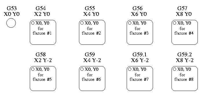

3. Coordinate Systems
images/offsets.png
Figure 1. Example of Coordinate Systems
Coordinate System Offsets
  • G54 - use coordinate system 1
  • G55 - use coordinate system 2
  • G56 - use coordinate system 3
  • G57 - use coordinate system 4
  • G58 - use coordinate system 5
  • G59 - use coordinate system 6
  • G59.1 - use coordinate system 7
  • G59.2 - use coordinate system 8
  • G59.3 - use coordinate system 9
Coordinate system offsets are used to shift the coordinate system from the machine coordinate system. This allows the G code to be programmed for the part without regard to the part location on the machine. Using coordinate system offsets would allow you to machine parts in multiple locations with the same G code.
