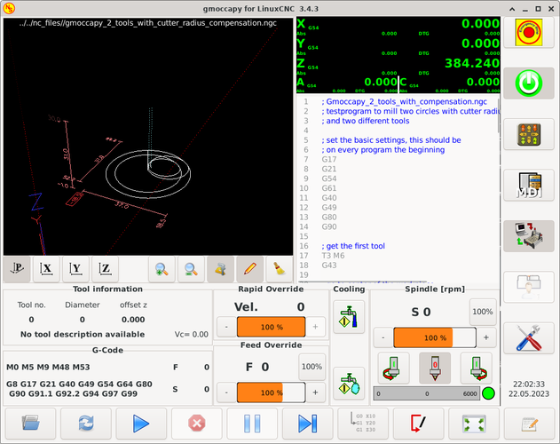

You will get a similar screen to the following (the design may vary depending on your config):
