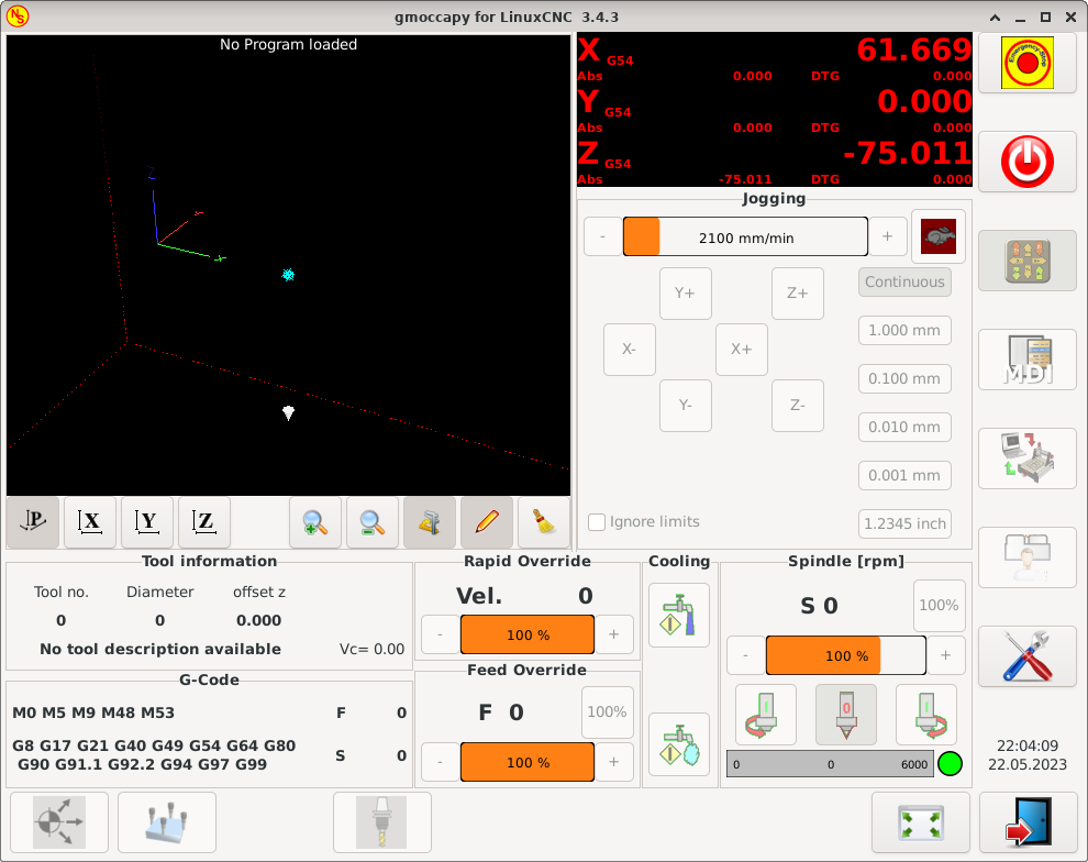

You will get a similar screen to the following (the design may vary depending on your config):

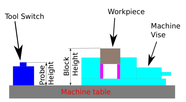

    Probe Information
    The following information are taken from your INI file and must be given in absolute coordinates:
    • X Pos. - The X position of the tool switch.
    • Y Pos. - The Y position of the tool switch.
    • Z Pos. - The Z position of the tool switch, we will go as rapid move to this coordinate.
    • Max. Probe - The distance to search for contact, an error will be launched, if no contact is given in this range. The distance has to be given in relative coordinates, beginning the move from Z Pos., so you have to give a negative value to go down!
    • Probe Height - The height of your probe switch, you can measure it. Just touch off the base where the probe switch is located and set that to zero. Then make a tool change and watch the tool_offset_z value, that is the height you must enter here.
