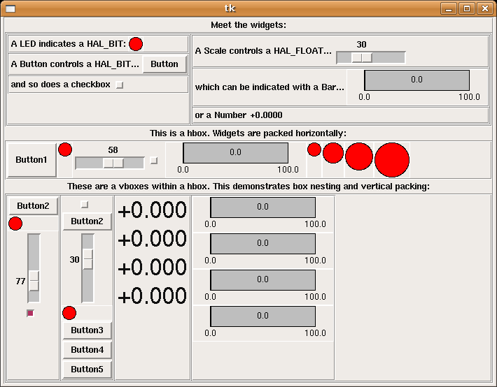

The following graphic displays many of the PyVCP widgets.
