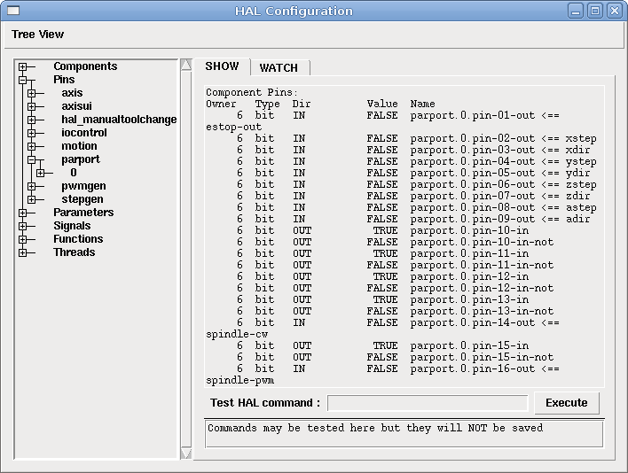

More detailed information can be found in the man page for halcmd: run man halcmd in a terminal window.
To see the HAL configuration and check the status of pins and parameters use the HAL Configuration window on the Machine menu in AXIS. To watch a pin status open the Watch tab and click on each pin you wish to watch and it will be added to the watch window.

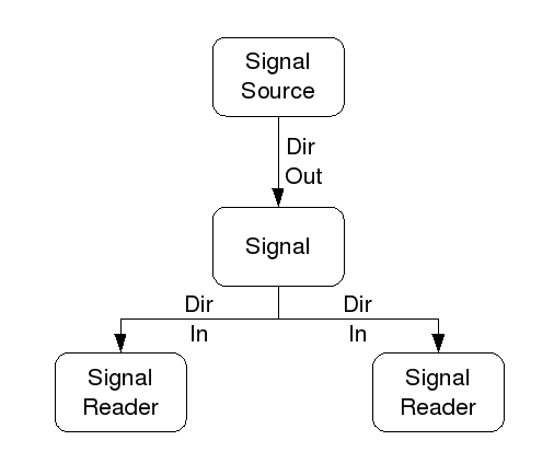

The same signal-name can be used in multiple net commands to connect additional pins, as long as the rules above are obeyed.
This example shows the signal xStep with the source being stepgen.0.out and with two readers, parport.0.pin-02-out and parport.0.pin-08-out.
Basically the value of stepgen.0.out is sent to the signal xStep and that value is then sent to parport.0.pin-02-out and parport.0.pin-08-out.
# signal source destination destination net xStep stepgen.0.out => parport.0.pin-02-out parport.0.pin-08-out
Since the signal xStep contains the value of stepgen.0.out (the source) you can use the same signal again to send the value to another reader.
To do this just use the signal with the readers on another line.
# signal destination2 net xStep => parport.0.pin-06-out

Creates groups of ``weighted_sum``s, each with the given number of input bits (size).
To update the weighted_sum, the process_wsums must be attached to a thread.
process_wsums to servo threadaddf process_wsums servo-thread
Which updates the weighted_sum component.
In the following example, a copy of the AXIS HAL configuration window, bits 0 and 2 are TRUE, they have no offset. The weight (weight) of bit 0 is 1, that of bit 2 is 4, so the sum is 5.
| Owner | Type | Dir | Value | Name |
10 |
bit |
In |
TRUE |
10 |
s32 |
I/O |
1 |
10 |
bit |
In |
FALSE |
10 |
s32 |
I/O |
2 |
10 |
bit |
In |
TRUE |
10 |
s32 |
I/O |
4 |
10 |
bit |
In |
FALSE |
10 |
s32 |
I/O |
8 |
10 |
bit |
In |
FALSE |
10 |
s32 |
I/O |
0 |
10 |
s32 |
Out |
5 |
