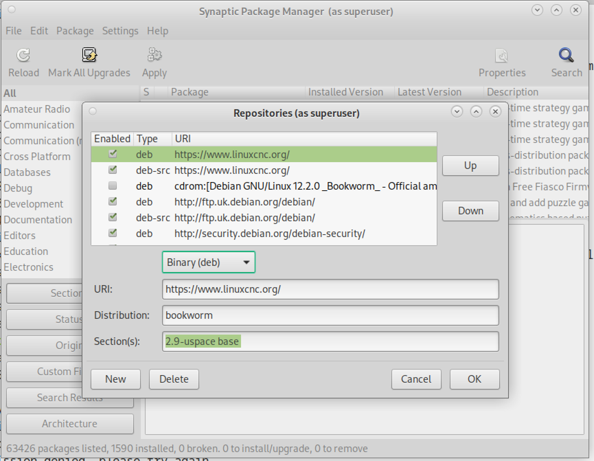

Setting apt sources
Figure 1. Figure with a screenshot of the repository configuration of the synaptic package manager.
  • Click Add Source, then Close in the Software Sources window. If it pops up a window informing you that the information about available software is out-of-date, click the Reload button.
