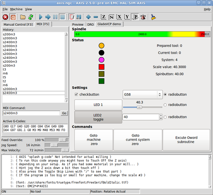

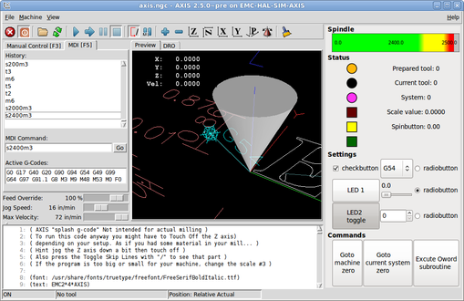

Führen Sie das in AXIS integrierte GladeVCP-Beispielpanel wie PyVCP wie folgt aus:
$ cd configs/sim/axis/gladevcp
$ linuxcnc gladevcp_panel.ini
images/example-panel-small.png
Führen Sie das gleiche Panel aus, aber als Registerkarte innerhalb von AXIS:
$ linuxcnc gladevcp_tab.ini

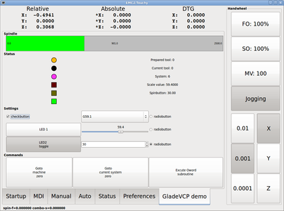

Um dieses Panel innerhalb von Touchy auszuführen:
$ cd configs/sim/touchy/gladevcp
$ linuxcnc gladevcp_touchy.ini
images/touchy-tab-33.png

2.1. Erkunden des Beispielpanels
While running configs/sim/axis/gladevcp_panel.ini or configs/sim/axis/gladevcp_tab.ini, explore Show HAL Configuration - you will find the gladevcp HAL component and may observe their pin values while interacting with the widgets in the panel. The HAL setup can be found in configs/axis/gladevcp/manual-example.hal.
The example panel has two frames at the bottom. The panel is configured so that resetting ESTOP activates the Settings frame and turning the machine on enables the Commands frame at the bottom. The HAL widgets in the Settings frame are linked to LEDs and labels in the Status frame, and to the current and prepared tool number - play with them to see the effect. Executing the T<toolnumber> and M6 commands in the MDI window will change the current and prepared tool number fields.
The buttons in the Commands frame are MDI Action widgets - pressing them will execute an MDI command in the interpreter. The third button Execute Oword subroutine is an advanced example - it takes several HAL pin values from the Settings frame, and passes them as parameters to the Oword subroutine. The actual parameters received by the routine are displayed by (DEBUG, ) commands - see ../../nc_files/oword.ngc for the subroutine body.
Um zu sehen, wie das Panel in AXIS integriert ist, sehen Sie die Anweisung [DISPLAY]GLADEVCP in configs/sim/axis/gladevcp/gladevcp_panel.ini, die Anweisung [DISPLAY]EMBED* in configs/sim/axis/gladevcp/gladevcp_tab.ini und [HAL]POSTGUI_HALFILE sowohl in configs/sim/axis/gladevcp/gladevcp_tab.ini als auch in configs/sim/axis/gladevcp/gladevcp_panel.ini.

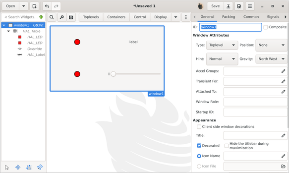

3.2. Glade ausführen, um eine neue Benutzeroberfläche zu erstellen
This section just outlines the initial LinuxCNC-specific steps. For more information and a tutorial on Glade, see http://glade.gnome.org. Some Glade tips & tricks may also be found on youtube.
Ändern Sie entweder eine bestehende UI-Komponente, indem Sie glade <Datei>.ui ausführen, oder starten Sie eine neue, indem Sie einfach den Befehl glade in der Shell ausführen.
  • If LinuxCNC was not installed from a package, the LinuxCNC shell environment needs to be set up with source <linuxcncdir>/scripts/rip-environment, otherwise Glade won’t find the LinuxCNC-specific widgets.
  • Wenn Sie nach nicht gespeicherten Einstellungen gefragt werden, akzeptieren Sie einfach die Standardeinstellungen und klicken Sie auf „Schließen“.
  • From Toplevels (toolbar), pick GtkWindow (first entry) as top level window. Set window1 as ID in the right pane under the tab General. This naming is important because GladeVCP relies on it.
  • From the button with the three dots you can find the LinuxCNC specific widgets.
  • Add a container like a HAL_Box or a HAL_Table from HAL Python to the frame.
  • Pick and place some elements like LED, button, etc. within a container.
This will look like this:
images/glade-manual-small.png
Glade tends to write a lot of messages to the shell window, which mostly can be ignored. Select File→Save as, give it a name like myui.ui and make sure it is saved as GtkBuilder file (radio button left bottom corner in Save dialog). GladeVCP will also process the older libglade format correctly but there is no point in using it. The convention for GtkBuilder file extension is .ui.

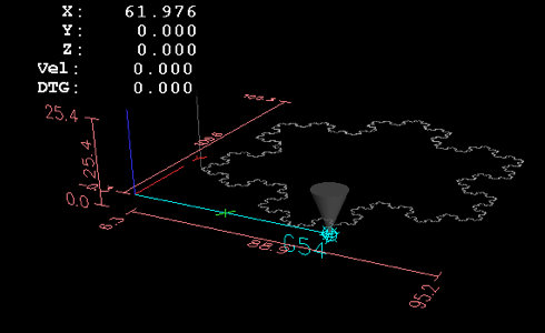

6.19. Gremlin tool path preview for NGC files
Gremlin is a plot preview widget similar to the AXIS preview window. It assumes a running LinuxCNC environment like AXIS or Touchy. To connect to it, inspects the INI_FILE_NAME environment variable. Gremlin displays the current NGC file - it does monitor for changes and reloads the ngc file if the file name in AXIS/Touchy changes. If you run it in a GladeVCP application when LinuxCNC is not running, you might get a traceback because the Gremlin widget can’t find LinuxCNC status, like the current file name.
6.19.1. Pins
Gremlin exportiert keine HAL-Pins.
6.19.2. Eigenschaften
Gremlin hat die folgenden Eigenschaften:
enable_dro
This displays the dro on the graphics.
Default = true.
show_velocity
Dies zeigt die Werkzeuggeschwindigkeit an.
Vorteinstellung = true.
use_commanded
Dies wählt die zu verwendende DRO aus: befohlene oder tatsächliche Werte.
Voreinstellung = true.
metric_units
Dies legt fest was die DRO nutzt: metrische oder imperiale Einheiten.
show_rapids
Dies legt fest, dass der Plotter die schnelle Bewegungen zeigt.
show_dtg_
Hiermit wird die Anzeige des Restweges auf der DRO ausgewählt.
use_relative
Hiermit wird festgelegt, dass die Anzeige der Werte relativ zu den Koordinaten des Benutzersystems oder der Maschine erfolgen soll.
show_live_plot
Hiermit wird dem Plotter mitgeteilt, ob er zeichnen soll oder nicht.
show_limits
Hiermit wird der Plotter angewiesen, die Grenzen der Maschine anzuzeigen.
show_lathe_radius
Hiermit wird die DRO Anzeige der X-Achse in Radius oder Durchmesser gewählt, wenn der Drehmaschinenmodus aktiviert ist (wählbar in der INI-Datei mit LATHE = 1).
show_extents_option
This tells the plotter to show the machine’s extents.
Default = true.
show_tool
Hiermit wird der Plotter angewiesen, das Werkzeug zu zeichnen.
show_program
Shows the G-code program.
Default = True
use_joints_mode
Wird in nicht trivialkins Maschinen (z.B. Robotern) verwendet.
Standard = false.
grid_size
Legt die Größe des Gitters fest (nur in den Ansichten X, Y und Z sichtbar). +
Standardwert ist 0
use_default_controls
This disables the default mouse controls.
This is most useful when using a touchscreen as the default controls do not work well. You can programmatically add controls using Python and the handler file technique.
Default = true.
view (engl. für Sicht)
Kann einer der Werte x, y, y2 , z, z2 , p (Perspektive) sein.
Standardmäßig wird die Ansicht z verwendet.
enable_dro
Typ = boolesch. +
Ob ein DRO auf dem Plot gezeichnet werden soll oder nicht. +
mouse_btn_mode
Typ = Ganzzahl.
Maustastenbehandlung: führt zu verschiedenen Funktionen der Taste:
  • 0 = Standard: Links drehen, Mitte bewegen, rechts zoomen
  • 1 = Links zoomen, Mitte verschieben, rechts rotieren
  • 2 = Links bewegen, Mitte drehen, rechts zoomen
  • 3 = Links zoomen, Mitte drehen, rechts verschieben
  • 4 = Links verschieben, mittig zoomen, rechts rotieren
  • 5 = Links drehen, Mitte zoomen, rechts bewegen
  • 6 = Bewegung nach links, mittlerer Zoom, rechter Zoom
Modus 6 wird für Plasmas und Drehbänke empfohlen, da für diese Maschinen keine Rotation erforderlich ist.

[widget name].gremlin.zoom_out()
[widget name].get_zoom_distance()
[widget name].set_zoom_distance(dist)
[widget name].clear_live_plotter()
[widget name].rotate_view(x,y)
[widget name].pan(x,y)
Hinweise
  • Wenn Sie alle Plot-Optionen auf false, show_offsets aber auf true setzen, erhalten Sie eine Seite mit Offsets anstelle einer grafischen Darstellung.
  • If you get the zoom distance before changing the view then reset the zoom distance, it is much more user friendly.
  • wenn Sie ein Element in der Vorschau auswählen, wird das ausgewählte Element als Rotationsmittelpunkt verwendet
images/gremlin.png
Abbildung 14. Gremlin Beispiel

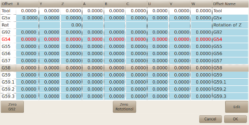

6.20. HAL_Offset
Das HAL_Offset-Widget wird verwendet, um den Offset einer einzelnen Achse anzuzeigen.
6.20.1. Eigenschaften
HAL_Offset hat die folgenden Eigenschaften:
display_units_mm
Display in metric units.
joint_number
Used to select which axis (technically which joint) is displayed.
On a trivialkins machine (mill, lathe, router) axis vs. joint number are:
0:X 1:Y 2:Z 3:A 4:B 5:C 6:U 7:V 8:W
mm_text_template
Sie können die Python-Formatierung verwenden, um die Position mit unterschiedlicher Genauigkeit anzuzeigen.
imperial_text_template
reference_type
0:G5x 1:Werkzeug 2:G92 3:Drehung um Z

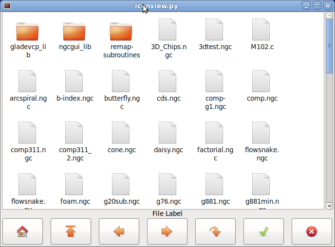

6.23. IconView (Dateiauswahl)
Dies ist ein Touchscreen-freundliches Widget zur Auswahl einer Datei und zum Wechseln von Verzeichnissen.
6.23.1. Eigenschaften
Das IconView-Widget hat die folgenden Eigenschaften:
icon_size
Legt die Größe des angezeigten Symbols fest. +
Erlaubte Werte sind Ganzzahlen im Bereich von 12 bis 96. +
Voreinstellung ist 48.
start_dir
Legt das Verzeichnis fest, in dem das Widget beim ersten Mal angezeigt wird.
Muss ein String sein, der einen gültigen Verzeichnispfad enthält.
Standard ist "/".
jump_to_dir
Legt das Verzeichnis fest, in das gesprungen werden soll und das durch die entsprechende Schaltfläche in der unteren Schaltflächenliste ausgewählt wird (die 5. Schaltfläche von links).
Voreinstellung ist "\~".
filetypes
Legt den Dateifilter für die anzuzeigenden Objekte fest.
Muss eine Zeichenkette sein, die eine durch Komma getrennte Liste von Erweiterungen enthält, die angezeigt werden sollen.
Standard ist "ngc,py".
sortorder
Legt die Sortierreihenfolge des angezeigten Symbols fest. +
Muss ein ganzzahliger Wert von 0 bis 3 sein, mit den entsprechenden Konstanten:
  • 0 = ASCENDING (engl. für aufsteigend) (nach Dateinamen sortiert)
  • 1 = DESCENDING (engl. für absteigend) (Sortierung nach Dateinamen)
  • 2 = FOLDERFIRST (zuerst die Ordner, dann die Dateien anzeigen), Standard
  • 3 = FILEFIRST (zuerst die Dateien, dann die Ordner anzeigen)
6.23.2. Direkte Programmsteuerung
Verwenden Sie GObject, um die oben aufgeführten Eigenschaften einzustellen:
[Widgetname].set_property(Eigenschaft,Wert)
Es gibt Python-Methoden zur Steuerung des Widgets:
  • [widget name].show_buttonbox(state)
    If False the bottom button box will be hidden.
    This is helpful in custom screens, with special buttons layouts to not alter the layout of the GUI. Good example for that is GMOCCAPY.
    state = boolean (True or False).
    Default is True.
  • [Widgetname].show_filelabel(state)+
    Bei True wird das Dateilabel (zwischen dem IconView-Fenster und dem unteren Schaltflächenfeld) angezeigt. +
    Das Ausblenden dieses Labels kann Platz sparen, aber das Anzeigen ist sehr nützlich für die Fehlersuche. +
    state = boolescher Wert (True oder False). +
    Voreinstellung ist True.
  • [Widgetname].set_icon_size(iconsize) +
    Setzt die Größe des Icons. +
    Muss eine ganze Zahl im Bereich von 12 bis 96 sein. +
    Voreinstellung = 48.
  • [Widgetname].set_directory(Verzeichnis) +
    Ermöglicht das Setzen eines anzuzeigenden Verzeichnisses. +
    Verzeichnis = String (ein gültiger Dateipfad).

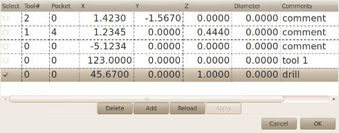

6.25. Werkzeugeditor-Widget (engl. tooleditor widget)
Dies ist ein "Werkzeug-Editor"-Widget zum Anzeigen und Ändern einer Werkzeugdatei. +
Im Drehmaschinenmodus werden Verschleißkorrekturen und Werkzeugkorrekturen separat angezeigt. +
Verschleißkorrekturen werden durch Werkzeugnummern über 10000 (Fanuc-Stil) gekennzeichnet. +
Es überprüft die aktuelle Datei einmal pro Sekunde, um zu sehen, ob LinuxCNC es aktualisiert.
Anmerkung
LinuxCNC erfordert Mapping von Werkzeug-Aufrufe, um Verschleiß-Offsets anzuwenden.
6.25.1. Eigenschaften
tooleditor hat die folgenden Eigenschaften:
font
Display font to use
hide_columns
Dadurch werden die angegebenen Spalten ausgeblendet. +
Die Spalten werden (in dieser Reihenfolge) wie folgt bezeichnet: s,t,p,x,y,z,a,b,c,u,v,w,d,i,j,q. +
Sie können eine beliebige Anzahl von Spalten ausblenden, einschließlich der Auswahl und der Kommentare.
lathe_display_type
Show lathe format
6.25.2. Direkte Programmsteuerung
Es gibt mehrere Möglichkeiten, das Widget direkt mit Python zu steuern.
Verwenden Sie goobject, um die oben aufgeführten Eigenschaften einzustellen:
[Widgetname].set_properties('hide_columns','uvwijq')
Dadurch würden die Spalten uvwij und q ausgeblendet und alle anderen angezeigt.
Es gibt Python-Methoden:
  • [Widgetname].set_visible("ijq",False)
    Blendet die Spalten ij und Q aus und belässt den Rest so, wie er war.
  • [Widgetname].set_filename(pfad_zur_datei)
    Setzt und lädt die Werkzeugdatei.
  • [Widgetname].reload(None)
    Lädt die aktuelle Werkzeugdatei neu.
  • [Widgetname].set_font('sans 16,tab='1') +
    Setzt die (Pango)-Schriftart für die Registerkarte, den Spaltentitel und die Werkzeugdaten. +
    Die all_offsets, wear_offsets, tool_offsets können gleichzeitig gesetzt werden, indem man 1, 2 und/oder 3 an den Tab-String anhängt. +
    Standardmäßig sind alle Registerkarten eingestellt.
  • [Widgetname].set_title_font('sans 16,tab='1') +
    Setzt die (Pango)-Schriftart nur für die Spaltentitel. +
    Standardmäßig sind alle Tabulatoren gesetzt.
  • [Widgetname].set_tab_font('sans 16,tab='1') +
    Setzt die (Pango)-Schriftart nur auf den Registerkarten. +
    Standardmäßig sind alle Tabs gesetzt.
  • [Widgetname].set_col_visible("abcUVW", False, tab='1') +
    Dies würde die abcuvw-Spalten auf der Registerkarte 1 (all_offsets) ausblenden (False)
  • [widget name].set_lathe_display(value) +
    Blendet die Verschleiß- und Werkzeugkorrekturtabellen für Drehbänke ein oder aus
  • [Widgetname].get_toolinfo(toolnum) +
    Gibt das Werkzeuginformationsfeld der angeforderten Werkzeugnummer oder des aktuellen Werkzeugs zurück, wenn keine Werkzeugnummer angegeben ist. +
    Gibt None zurück, wenn das Werkzeug nicht in der Tabelle gefunden wurde oder wenn es kein aktuelles Werkzeug gibt.
  • [Widgetname].hide_buttonbox(self, True) +
    Komfortable Methode zum Ausblenden von Schaltflächen. +
    Sie müssen diese Methode nach show_all() aufrufen.
  • [Widgetname].get_selected_tool() +
    Gibt die vom Benutzer ausgewählte (hervorgehobene) Werkzeugnummer zurück.
  • [Widgetname].set_selected_tool(toolnumber) +
    Wählt das gewünschte Werkzeug aus (markiert es).
images/gtk-tooledit.png
Abbildung 17. Werkzeug-Editor (engl. tooleditor) Beispiel

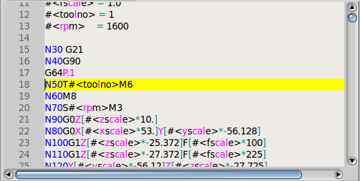

6.27. HAL_sourceview-Widget
This is for displaying and simple editing of G-code. It looks for .ngc highlighting specs in ~/share/gtksourceview-4/language-specs/. The current running line will be highlighted.
Mit externem Python-Glue-Code kann dies:
  • Nach Text suchen, Änderungen rückgängig machen und Wiederherstellen,
  • für die Auswahl von Programmzeilen genutzt werden.
6.27.1. Direkte Programmsteuerung
  • [widget name].redo() +
    Wiederholung einer Ebene von Änderungen.
  • [widget name].undo()` +
    Rückgängig machen einer Ebene von Änderungen
  • [Widgetname].text_search(direction=True,mixed_case=True,text='G92') +
    Sucht vorwärts (direction = True) oder rückwärts, +
    Sucht mit gemischter Groß- und Kleinschreibung (mixed_case = True) oder exakter Übereinstimmung
  • [Widgetname].set_line_number(Zeilennummer) +
    Setzt die hervorzuhebende Zeile. +
    Verwendet die Zeilennummern der Quellansicht.
  • [Widgetname].get_line_number() +
    Gibt die aktuell hervorgehobene Zeile zurück.
  • [Widget-Name].line_up()` +
    Verschiebt die markierte Zeile um eine Zeile nach oben.
  • [Name des Widgets].line_down()
    Verschiebt die markierte Zeile um eine Zeile nach unten.
  • [Widgetname].load_file('Dateiname')
    Lädt eine Datei.
    Die Verwendung von None (keine Zeichenkette für den Dateinamen) lädt das gleiche Programm erneut.
  • [Widget-Name].get_filename()
    FIXME Beschreibung
images/hal_sourceview.png
Abbildung 19. Quellen-Ansicht (engl. sourceview) Beispiel

7.5. Ein einfaches Beispiel: Ausführen eines MDI-Befehls bei Button-Druck
configs/apps/gladevcp/mdi-command-example/whoareyou.ui ist eine Glade UI-Datei, welche die Grundlagen vermittelt:
  1. Open it in Glade and study how it is done.
  2. Starten Sie AXIS, und starten Sie es dann von einem Terminalfenster aus mit gladevcp whoareyou.ui.
  3. See the hal_action_mdi1 action and its MDI command property - this just executes (MSG, "Hi, I'm an VCP_Action_MDI") so there should be a message popup in AXIS like so:
images/whoareyou.png
Abbildung 22. Action_MDI Einfaches Beispiel
Sie werden feststellen, dass die mit der Aktion Action_MDI verbundene Schaltfläche ausgegraut ist, wenn die Maschine ausgeschaltet ist, sich im E-Stop befindet oder der Interpreter läuft. Sie wird automatisch aktiv, wenn die Maschine eingeschaltet ist und sich nicht mehr im Notaus-Modus befindet und das Programm im Leerlauf ist.

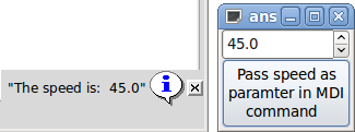

7.6. Parameterübergabe mit Action_MDI- und ToggleAction_MDI-Widgets
Optional können bei "MDI Befehl"-Zeichenketten Parameter ersetzt werden, bevor sie an den Interpreter übergeben werden. Parameter können derzeit Namen von HAL-Pins in der GladeVCP-Komponente sein. So funktioniert es:
  • assume you have a HAL SpinBox named speed, and you want to pass its current value as a parameter in an MDI command.
  • Die HAL SpinBox hat einen HAL-Pin vom Typ float mit dem Namen speed-f (siehe HalWidgets-Beschreibung).
  • für die obige HAL SpinBox könnten wir (MSG, "Die Geschwindigkeit ist: ${geschwindigkeit-f}") verwenden, um zu zeigen, was passiert.
Die Beispiel-UI-Datei ist "configs/apps/gladevcp/mdi-command-example/speed.ui". So sieht das Ergebnis aus, wenn man sie ausführt:
images/speed.png
Abbildung 23. Action_MDI Parameterübergabe Beispiel

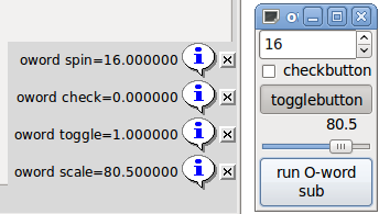

7.7. Ein fortgeschrittenes Beispiel: Übergabe von Parametern an eine O-Wort-Unterroutine
Es ist völlig in Ordnung, eine O-Wort-Unterroutine in einem MDI-Befehl aufzurufen und HAL-Pin-Werte als aktuelle Parameter zu übergeben. Eine Beispiel-UI-Datei befindet sich in configs/apps/gladevcp/mdi-command-example/owordsub.ui.
Legen Sie nc_files/gladevcp_lib/oword.ngc so ab, dass AXIS es finden kann, und führen Sie gladevcp owordsub.ui in einem Terminalfenster aus. Das sieht dann so aus:
images/oword.png
Abbildung 24. Action_MDI Erweitertes Beispiel

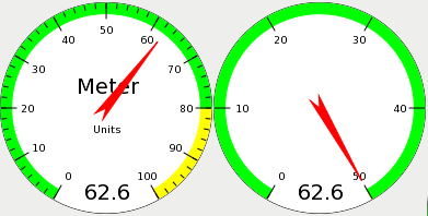

8.16. HAL-Widget-Eigenschaften programmatisch einstellen
With Glade, widget properties are typically set fixed while editing. You can, however, set widget properties at runtime, for instance from INI file values, which would typically be done in the handler initialization code. Setting properties from HAL pin values is possible, too.
Im folgenden Beispiel (unter der Annahme eines HAL Meter-Widgets mit dem Namen meter) wird der Minimalwert des Zählers beim Start über einen INI-Dateiparameter und der Maximalwert über einen HAL-Pin eingestellt, wodurch die Skala des Widgets dynamisch angepasst wird:
import linuxcnc
import os
import hal
import hal_glib
class HandlerClass:
    def _on_max_value_change(self,hal_pin,data=None):
        self.meter.max = float(hal_pin.get())
        self.meter.queue_draw() # force a widget redraw
    def __init__(self, halcomp,builder,useropts):
        self.builder = builder
        # HAL-Pin mit Änderungs-Callback.
        # Wenn sich der Wert des Pins ändert, wird der Callback ausgeführt.
        self.max_value = hal_glib.GPin(halcomp.newpin('max-value',  hal.HAL_FLOAT, hal.HAL_IN))
        self.max_value.connect('value-changed', self._on_max_value_change)
        inifile = linuxcnc.ini(os.getenv("INI_FILE_NAME"))
        mmin = float(inifile.find("METER", "MIN") or 0.0)
        self.meter = self.builder.get_object('meter')
        self.meter.min = mmin
def get_handlers(halcomp,builder,useropts):
    return [HandlerClass(halcomp,builder,useropts)]
