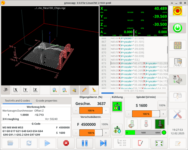

1. Introduktion
GMOCCAPY is a GUI for LinuxCNC, designed to be used with a touch screen, but can also be used on normal screens with a mouse or hardware buttons and MPG wheels, as it presents HAL Pins for the most common needs. Please find more information in the following.
It offers the possibility to display up to 9 axes, support a lathe mode for normal and back tool lathe and can be adapted to nearly every need, because GMOCCAPY supports embedded tabs and side panels. As a good example for that see gmoccapy_plasma.
GMOCCAPY 3 does support up to 9 axes and 9 joints. As GMOCCAPY 3 has been changed in code to support the joint / axis changes in LinuxCNC it does not work on 2.7 or 2.6 branch!
It has support for integrated virtual keyboard (onboard or matchbox-keyboard), so there is no need for a hardware keyboard or mouse, but it can also be used with that hardware. GMOCCAPY offers a separate settings page to configure most settings of the GUI without editing files.
GMOCCAPY can be localized very easy, because the corresponding files are separated from the linuxcnc.po files, so there is no need to translate unneeded stuff. If you want to contribute a translation, please use the web based translation editor Weblate. For more information see the section Translations

You will get a similar screen to the following (the design may vary depending on your config):

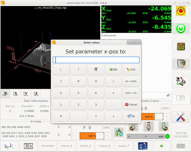

GMOCCAPY will also accept macros asking for parameters like:
[MACRO] MACRO = go_to_position X-pos Y-pos Z-pos
The parameters must be separated by spaces. This example calls a file go_to_position.ngc with the following content:
; Test file "go to position" ; will jog the machine to a given position O<go_to_position> sub G17 G21 G54 G61 G40 G49 G80 G90 ;#1 = <X-Pos> ;#2 = <Y-Pos> ;#3 = <Z-Pos> (DBG, Will now move machine to X = #1 , Y = #2 , Z = #3) G0 X #1 Y #2 Z #3 O<go_to_position> endsub M2
After pushing the execute macro button, you will be asked to enter the values for X-pos Y-pos Z-pos and the macro will only run if all values have been given.
Not

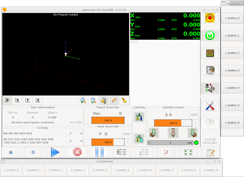

4.4. Embedded Tabs and Panels
You can add embedded programs to GMOCCAPY like you can do in AXIS, Touchy and Gscreen. All is done by GMOCCAPY automatically if you include a few lines in your INI file in the DISPLAY section.
If you have never used a Glade panel, I recommend to read the excellent documentation on Glade VCP.
EMBED_TAB_NAME = DRO EMBED_TAB_LOCATION = ntb_user_tabs EMBED_TAB_COMMAND = gladevcp -x {XID} dro.glade EMBED_TAB_NAME = Second user tab EMBED_TAB_LOCATION = ntb_preview EMBED_TAB_COMMAND = gladevcp -x {XID} vcp_box.glade
All you have to take care of, is that you include for every tab or side panel the mentioned three lines:
EMBED_TAB_NAME = Represents the name of the tab or side panel, it is up to you what name you use, but it must be present!
EMBED_TAB_LOCATION = The place where your program will be placed in the GUI, see figure Embedded tab locations. Valid values are:
ntb_user_tabs (as main tab, covering the complete screen)
ntb_preview (as tab on the preview side (1))
hbox_jog (will hide the jog buttons and introduce your glade file here (2))
box_left (on the left, complete high of the screen)
box_right (on the right, in between the normal screen and the button list)
box_tool_and_code_info (will hide the Tool information and G-code frames and introduce your glade file here (3))
box_tool_info (will hide the Tool information frame and introduce your glade file here)
box_code_info (will hide the G-code information frame and introduce your glade file here)
box_vel_info (will hide the velocity frames and introduce your glade file (4))
box_coolant_and_spindle (will hide the coolant and spindle frames and introduce your glade file here (5)+(6))
box_cooling (will hide the cooling frame and introduce your glade file (5))
box_spindle (will hide the spindle frame and introduce your glade file (6))
box_custom_1 (will introduce your glade file left of vel_frame)
box_custom_2 (will introduce your glade file left of cooling_frame)
box_custom_3 (will introduce your glade file left of spindle_frame)
box_custom_4 (will introduce your glade file right of spindle_frame)
box_dro_side (will introduce your glade file right of the DRO)
Not
See also the included sample INI files to see the differences. |
EMBED_TAB_COMMAND = The command to execute, i.e.
includes a custom glade file called dro.glade in the mentioned location. The file must be placed in the config folder of your machine.
gladevcp h_buttonlist.glade
will just open a new user window called h_buttonlist.glade note the difference. This one is stand alone, and can be moved around independent from GMOCCAPY window.
gladevcp -c gladevcp -u hitcounter.py -H manual-example.hal manual-example.ui
will add a the panel manual-example.ui, include a custom Python handler, hitcounter.py and make all connections after realizing the panel according to manual-example.hal.
hide
will hide the chosen box.
![images/gmoccapy_embedded_tabs.png](images/gmoccapy_embedded_tabs.png)
Not
If you make any HAL connections to your custom glade panel, you need to do that in the HAL file specified in the EMBED_TAB_COMMAND line, otherwise you may get an error that the HAL pin does not exist — this is because of race conditions loading the HAL files. Connections to GMOCCAPY HAL pins need to be made in the postgui HAL file specified in your INI file, because these pins do not exist prior of realizing the GUI. |
Here are some examples:

5.1. Right and Bottom Button Lists
The screen has two main button lists, one on the right side an one on the bottom. The right handed buttons will not change during operation, but the bottom button list will change very often. The buttons are count from up to down and from left to right beginning with 0.
Not
The pin names have changed in GMOCCAPY 2 to order them in a better way. |
The pins for the right (vertical) buttons are:
gmoccapy.v-button.button-0 (bit IN)
gmoccapy.v-button.button-1 (bit IN)
gmoccapy.v-button.button-2 (bit IN)
gmoccapy.v-button.button-3 (bit IN)
gmoccapy.v-button.button-4 (bit IN)
gmoccapy.v-button.button-5 (bit IN)
gmoccapy.v-button.button-6 (bit IN)
For the bottom (horizontal) buttons they are:
gmoccapy.h-button.button-0 (bit IN)
gmoccapy.h-button.button-1 (bit IN)
gmoccapy.h-button.button-2 (bit IN)
gmoccapy.h-button.button-3 (bit IN)
gmoccapy.h-button.button-4 (bit IN)
gmoccapy.h-button.button-5 (bit IN)
gmoccapy.h-button.button-6 (bit IN)
gmoccapy.h-button.button-7 (bit IN)
gmoccapy.h-button.button-8 (bit IN)
gmoccapy.h-button.button-9 (bit IN)
As the buttons in the bottom list will change according to the mode and other influences, the hardware buttons will activate the displayed functions. So you don’t have to take care about switching functions around in HAL, because that is done completely by GMOCCAPY!
For a three axes XYZ machine the HAL pins will react as shown in the following three tables:
Pin | Manual Mode | MDI Mode | Auto Mode |
open homing button |
macro_0 or nothing |
open file |
open touch off stuff |
macro_1 or nothing |
reload program |
macro_2 or nothing |
run |
open tool dialogs |
macro_3 or nothing |
stop |
macro_4 or nothing |
pause |
macro_5 or nothing |
step by step |
macro_6 or nothing |
run from line if enabled in settings, otherwise Nothing |
macro_7 or nothing |
optional blocks |
full-size preview |
macro_8 or switch page to additional macros |
full-size preview |
exit if machine is off, otherwise no reaction |
open keyboard or abort if macro is running |
edit code |
Pin | Settings Mode | Homing Mode | Touch off Mode |
delete MDI history |
edit offsets |
home all |
touch X |
touch Y |
home x |
touch Z |
open classic ladder |
home y |
open HAL scope |
home z |
open HAL status |
zero G92 |
open HAL meter |
open HAL calibration |
unhome all |
set selected |
open HAL show |
back |
back |
Pin | Tool Mode | Edit Mode | Select File |
delete tool(s) |
go to home directory |
new tool |
reload file |
one directory level up |
reload tool table |
save |
apply changes |
save as |
move selection left |
change tool by number T? M6 |
move selection right |
set tool by number without change M61 Q? |
jump to directory as set in settings |
change tool to the selected one |
new file |
select / ENTER |
touch of tool in Z |
show keyboard |
back |
back |
back |
So we have 67 reactions with only 10 HAL pins!
These pins are made available to be able to use the screen without a touch panel, or protect it from excessive use by placing hardware buttons around the panel. They are available in a sample configuration like shown in the image below.

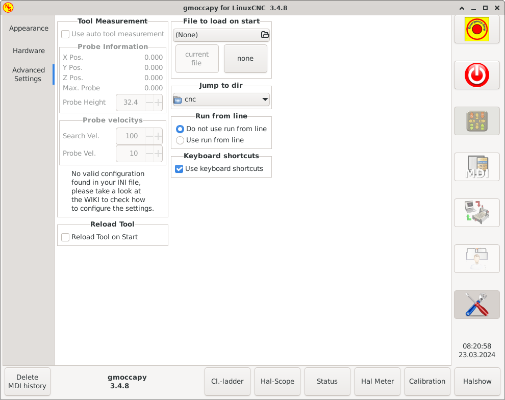

Please check Auto Tool Measurement
Not
If this part is not sensitive, you do not have a valid INI file configuration to use tool measurement. |
Use auto tool measurement - If checked, after each tool change, a tool measurement will be done, the result will be stored in the tool table and a G43 will be executed after the change.
- Probe Information
The following information is taken from your INI file and must be given in absolute coordinates.
X Pos. - The X position of the tool switch.
Y Pos. - The Y position of the tool switch.
Z Pos. - The Z position of the tool switch, we will go as rapid move to this coordinate.
Max. Probe The distance to search for contact, an error will be launched, if no contact is given in this range. The distance has to be given in relative coordinates, beginning the move from Z Pos., so you have to give a negative value to go down!
Probe Height - The height of your probe switch, you can measure it. Just touch off the base where the probe switch is located and set that to zero. Then make a tool change and watch the tool_offset_z value, that is the height you must enter here.
- Probe velocities
Search Vel. - The velocity to search for the tool switch. After contact the tool will go up again and then goes towards the probe again with probe vel, so you will get better results.
Probe Vel. - The velocity for the second movement to the switch. It should be slower to get better touch results. In simulation mode, this is commented out in macros/change.ngc, otherwise the user would have to click twice on the probe button.
- Reload Tool
Reload Tool on Start - Loads the last tool on start after homing.
