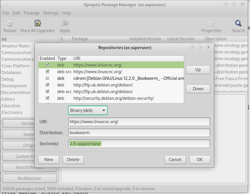

In the
Software Sources
window, select theOther Software
tab. -
Delete or un-check all the old linuxcnc.org entries (leave all non-linuxcnc.org lines as they are).
Click the
Add
button and add a new apt line. The line will be slightly different on the different platforms:
OS / Realtime Version | Repository |
Debian Buster - preempt |
Debian Buster - RTAI |
Debian Bullseye - preempt |
Debian Bookworm - preempt |
Debian Bookworm - RTAI |
![Setting apt sources](images/upgrading-to-2.9.png)
Click
Add Source
, thenClose
in the Software Sources window. If it pops up a window informing you that the information about available software is out-of-date, click theReload
button.
