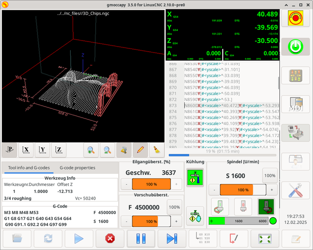

GMOCCAPY is a GUI for LinuxCNC, designed to be used with a touch screen, but can also be used on normal screens with a mouse or hardware buttons and MPG wheels, as it presents HAL Pins for the most common needs. Please find more information in the following.
It offers the possibility to display up to 9 axes, support a lathe mode for normal and back tool lathe and can be adapted to nearly every need, because GMOCCAPY supports embedded tabs and side panels. As a good example for that see gmoccapy_plasma.
GMOCCAPY 3 does support up to 9 axes and 9 joints. As GMOCCAPY 3 has been changed in code to support the joint / axis changes in LinuxCNC it does not work on 2.7 or 2.6 branch!
It has support for integrated virtual keyboard (onboard or matchbox-keyboard), so there is no need for a hardware keyboard or mouse, but it can also be used with that hardware. GMOCCAPY offers a separate settings page to configure most settings of the GUI without editing files.

You will get a similar screen to the following (the design may vary depending on your config):

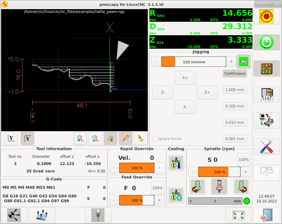

LATHE = 1 - Set the screen layout to control a lathe.

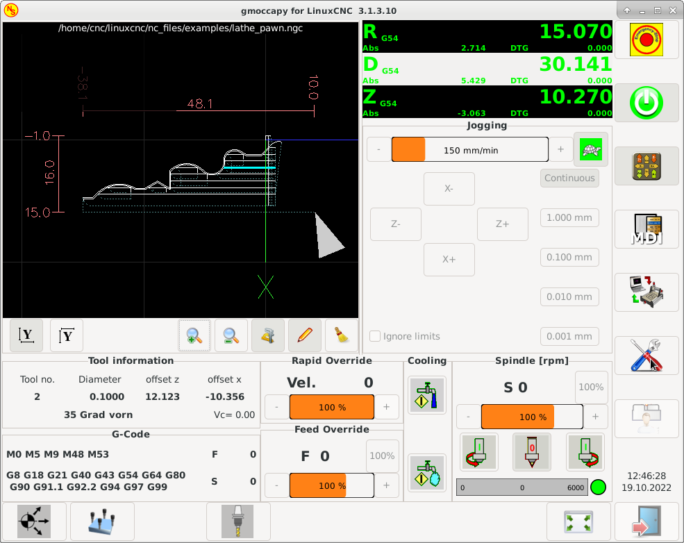

BACK_TOOL_LATHE = 1 - Is optional and will switch the X axis in a way you need for a back tool lathe. Also the keyboard shortcuts will react in a different way. It is allowed with GMOCCAPY to configure a lathe also with additional axes, so you may use also a XZCW config for a lathe.
See also the Lathe Specific Section. -

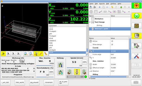

4.3. Macro Buttons
You can add macros to GMOCCAPY, similar to Touchy’s way. A macro is nothing else than a NGC file. You are able to execute complete CNC programs in MDI mode by just pushing one button. To do so, you first have to specify the search path for macros:
This sets the path to search for macros and other subroutines. Several subroutine paths can be separated ":".
Then you just have to add a section like this:
[MACROS] MACRO = i_am_lost MACRO = hello_world MACRO = jog_around MACRO = increment xinc yinc MACRO = go_to_position X-pos Y-pos Z-pos
Then you have to provide the corresponding NGC files which have to follow these rules:
The name of the file need to be exactly the same as the name mentioned in the macro line, just with the ".ngc" extension (case sensitive).
The file must contain a subroutine like O<i_am_lost> sub, the name of the sub must match exactly (case sensitive) the name of the macro.
The file must end with an endsub O<i_am_lost> endsub followed by an M2 command.
The files need to be placed in a folder specified in your INI file by SUBROUTINE_PATH in the RS274NGC section
The code between sub and endsub will be executed by pushing the corresponding macro button.
A maximum of 16 macros will be shown in the GUI. Due to space reasons you may need to click on an arrow to switch the page and display hidden macro buttons. The macro buttons will be displayed in the order of the INI entries. It is no error placing more than 16 macros in your INI file, they will just not be shown. |
You will find the sample macros in a folder named macros placed in the GMOCCAPY sim folder. If you have given several subroutine paths, they will be searched in the order of the given paths. The first file found will be used. |

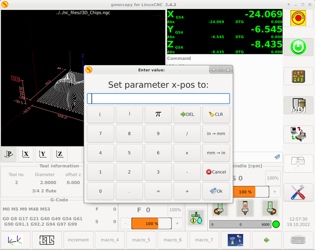

GMOCCAPY will also accept macros asking for parameters like:
[MACRO] MACRO = go_to_position X-pos Y-pos Z-pos
The parameters must be separated by spaces. This example calls a file go_to_position.ngc with the following content:
; Test file "go to position" ; will jog the machine to a given position O<go_to_position> sub G17 G21 G54 G61 G40 G49 G80 G90 ;#1 = <X-Pos> ;#2 = <Y-Pos> ;#3 = <Z-Pos> (DBG, Will now move machine to X = #1 , Y = #2 , Z = #3) G0 X #1 Y #2 Z #3 O<go_to_position> endsub M2
After pushing the execute macro button, you will be asked to enter the values for X-pos Y-pos Z-pos and the macro will only run if all values have been given.
If you would like to use a macro without any movement, see also the notes in known problems. |

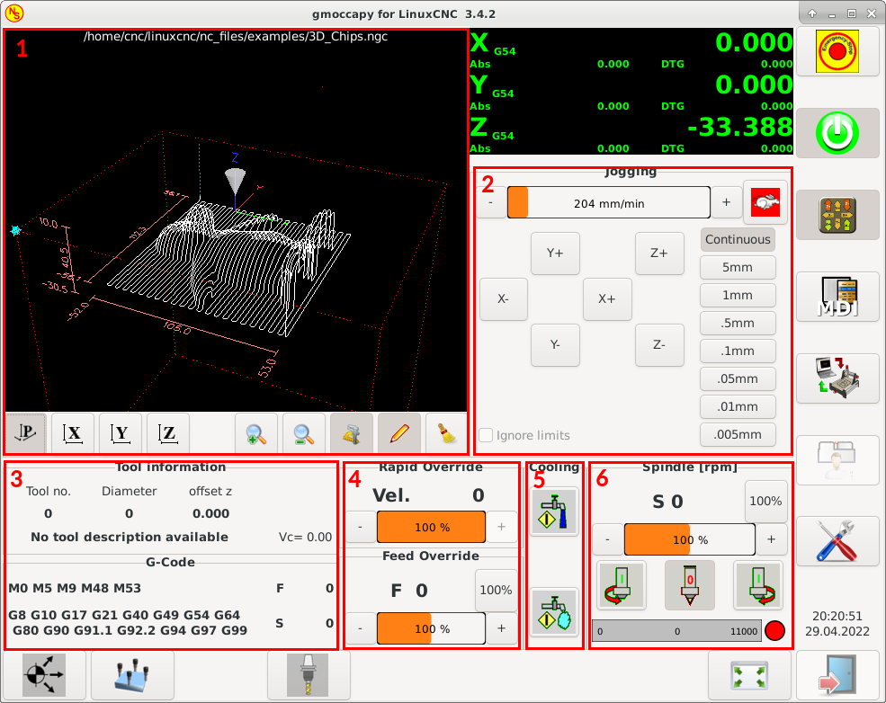

EMBED_TAB_NAME = DRO EMBED_TAB_LOCATION = ntb_user_tabs EMBED_TAB_COMMAND = gladevcp -x {XID} dro.glade EMBED_TAB_NAME = Second user tab EMBED_TAB_LOCATION = ntb_preview EMBED_TAB_COMMAND = gladevcp -x {XID} vcp_box.glade
All you have to take care of, is that you include for every tab or side panel the mentioned three lines:
EMBED_TAB_NAME = Represents the name of the tab or side panel, it is up to you what name you use, but it must be present!
EMBED_TAB_LOCATION = The place where your program will be placed in the GUI, see figure Embedded tab locations. Valid values are:
ntb_user_tabs (as main tab, covering the complete screen)
ntb_preview (as tab on the preview side (1))
hbox_jog (will hide the jog buttons and introduce your glade file here (2))
box_left (on the left, complete high of the screen)
box_right (on the right, in between the normal screen and the button list)
box_tool_and_code_info (will hide the Tool information and G-code frames and introduce your glade file here (3))
box_tool_info (will hide the Tool information frame and introduce your glade file here)
box_code_info (will hide the G-code information frame and introduce your glade file here)
box_vel_info (will hide the velocity frames and introduce your glade file (4))
box_coolant_and_spindle (will hide the coolant and spindle frames and introduce your glade file here (5)+(6))
box_cooling (will hide the cooling frame and introduce your glade file (5))
box_spindle (will hide the spindle frame and introduce your glade file (6))
box_custom_1 (will introduce your glade file left of vel_frame)
box_custom_2 (will introduce your glade file left of cooling_frame)
box_custom_3 (will introduce your glade file left of spindle_frame)
box_custom_4 (will introduce your glade file right of spindle_frame)
box_dro_side (will introduce your glade file right of the DRO)
See also the included sample INI files to see the differences. |

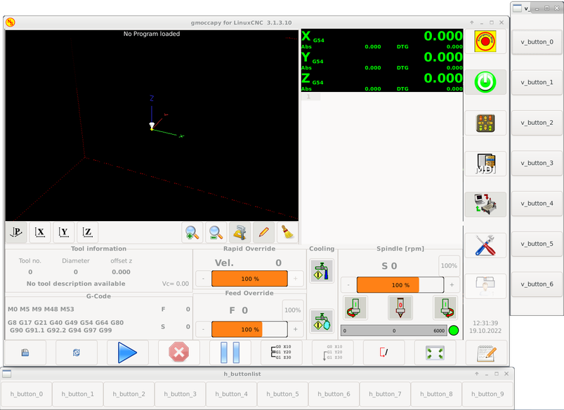

gladevcp h_buttonlist.glade
will just open a new user window called h_buttonlist.glade note the difference. This one is stand alone, and can be moved around independent from GMOCCAPY window.
gladevcp -c gladevcp -u hitcounter.py -H manual-example.hal manual-example.ui
will add a the panel manual-example.ui, include a custom Python handler, hitcounter.py and make all connections after realizing the panel according to manual-example.hal.

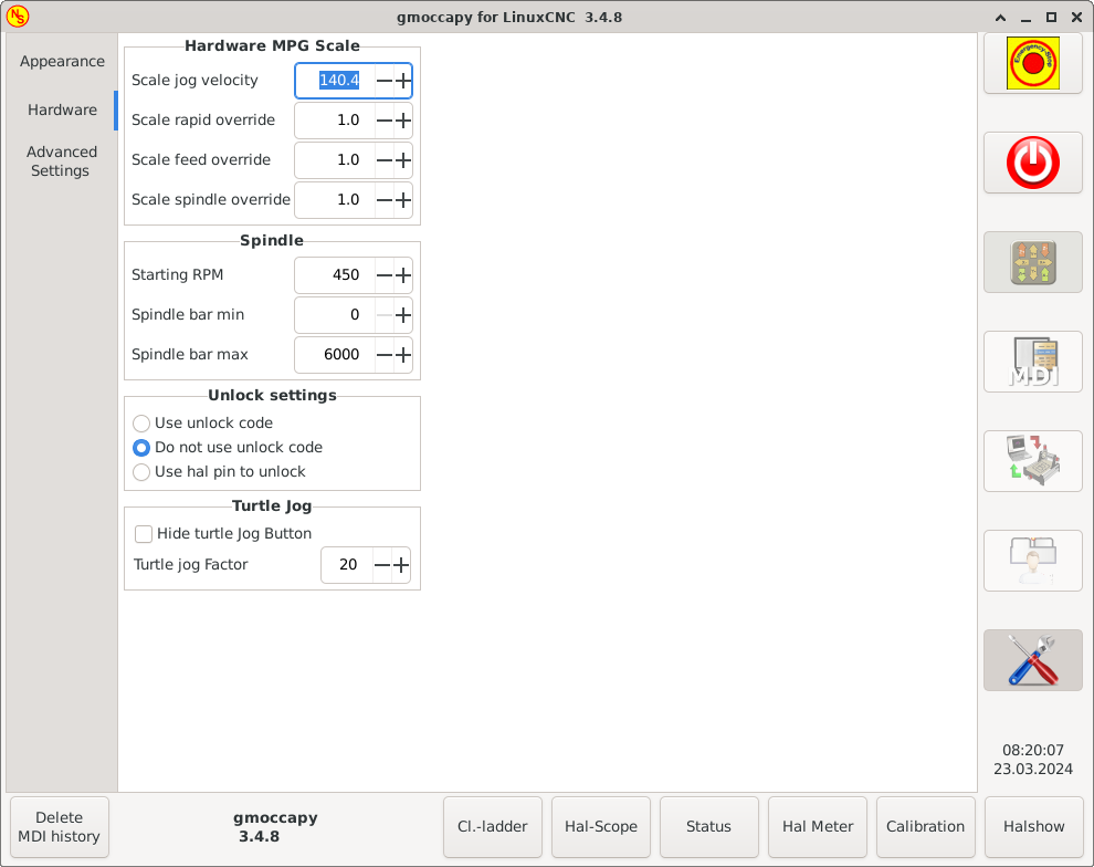

5.6. Hardware Unlock Pin
To be able to use a key switch to unlock the settings page, the following pin is exported:
gmoccapy.unlock-settings (bit IN) - The settings page is unlocked if the pin is high. To use this pin, you need to activate it on the settings page.

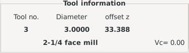

These pins allow you to show the active tool offset values for X and Z in the tool information frame. You should know that they are only active after G43 has been sent.
![Tool information](images/gmoccapy_tool_info.png)
gmoccapy.tooloffset-x (float IN)
gmoccapy.tooloffset-z (float IN)
The tooloffset-x line is not needed on a mill, and will not be displayed on a mill with trivial kinematics. |
To display the current offsets, the pins have to be connected like this in the postgui HAL file:
net tooloffset-x gmoccapy.tooloffset-x <= motion.tooloffset.x net tooloffset-z gmoccapy.tooloffset-z <= motion.tooloffset.z
Please note, that GMOCCAPY takes care of its own to update the offsets, sending an G43 after any tool change, but not in auto mode! So writing a program makes you responsible to include an G43 after each tool change! |

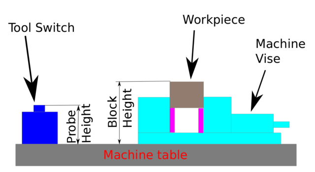

6. Auto Tool Measurement
GMOCCAPY offers an integrated auto tool measurement. To use this feature, you will need to do some additional settings and you may want to use the offered HAL pin to get values in your own NGC remap procedure.
Before starting the first test, do not forget to enter the probe height and probe velocities on the settings page! See Settings Page Tool Measurement. |
It might be also a good idea to take a look at the tool measurement video, see tool measurement related videos.
Tool Measurement in GMOCCAPY is done a little bit different to many other GUIs. You should follow these steps:
Touch off your workpiece in X and Y.
Measure the height of your block from the base where your tool switch is located, to the upper face of the block (including chuck etc.).
Push the button block height and enter the measured value.
Go to auto mode and start your program.
Here is a small sketch:
![images/sketch_auto_tool_measurement.png](images/sketch_auto_tool_measurement.png)

GMOCCAPY offers five pins for tool measurement purposes. These pins are mostly used to be read from a G-code subroutine, so the code can react to different values.
gmoccapy.toolmeasurement (bit OUT) - Enable or not tool measurement
gmoccapy.blockheight (float OUT) - The measured value of the top face of the workpiece
gmoccapy.probeheight (float OUT) - The probe switch height
gmoccapy.searchvel (float OUT) - The velocity to search for the tool probe switch
gmoccapy.probevel (float OUT) - The velocity to probe tool length

7.2. Hardware
![Hardware settings](images/gmoccapy_settings_hardware.png)
For the different HAL pins to connect MPG wheels to, you may select individual scales to be applied. The main reason for this was my own test to solve this through HAL connections, resulting in a very complex HAL file. Imagine a user having an MPG Wheel with 100 ipr and he wants to slow down the max. vel. from 14000 to 2000 mm/min, that needs 12000 impulses, resulting in 120 turns of the wheel! Or an other user having a MPG Wheel with 500 ipr and he wants to set the spindle override which has limits from 50 to 120 % so he goes from min to max within 70 impulses, meaning not even 1/4 turn.
By default all scales are set using the calculation:
(MAX - MIN)/100
Some users want to jog there machine using the keyboard buttons and there are others that will never allow this. So everybody can select whether to use them or not.
Keyboard shortcuts are disabled by default.
It is not recommended to use keyboard jogging, as it represents a serious risk for operator and machine. |
Please take care if you use a lathe, then the shortcuts will be different, see the Lathe Specific Section.

There are three options to unlock the settings page:
Use unlock code - The user must give a code to get in.
Do not use unlock code - There will be no security check.
Use HAL pin to unlock - Hardware pin must be high to unlock the settings, see hardware unlock pin.
Default is use unlock code (default = 123).
Starting RPM - Sets the rpm to be used if the spindle is started and no S value has been set.
This value will be presetted according to your settings in [DISPLAY] DEFAULT_SPINDLE_SPEED
of your INI file. If you change the settings on the settings page, that value will be default from that moment, your INI file will not be modified. -
Spindle bar min and Spindle bar max - Sets the limits of the spindle bar shown in the INFO frame on the main screen.
Default values are:
MIN = 0
MAX = 6000It is no error giving wrong values. If you give a maximum of 2000 and your spindle makes 4000 RPM, only the bar level will be wrong on higher speeds than 2000 RPM.
This settings will have influence on the jog velocities.
Hide turtle jog button - Will hide the button right of the jog velocity slider. If you hide this button, please take care that the "rabbit mode" is activated, otherwise you will not be able to jog faster than the turtle jog velocity, which is calculated using the turtle jog factor.
Turtle jog factor - Sets the scale to apply for turtle jog mode (button pressed, showing the turtle). If you set a factor of 20, the turtle max. jog velocity will be 1/20 of the max. velocity of the machine.
This button can be controlled using the Turtle-Jog HAL Pin. |
