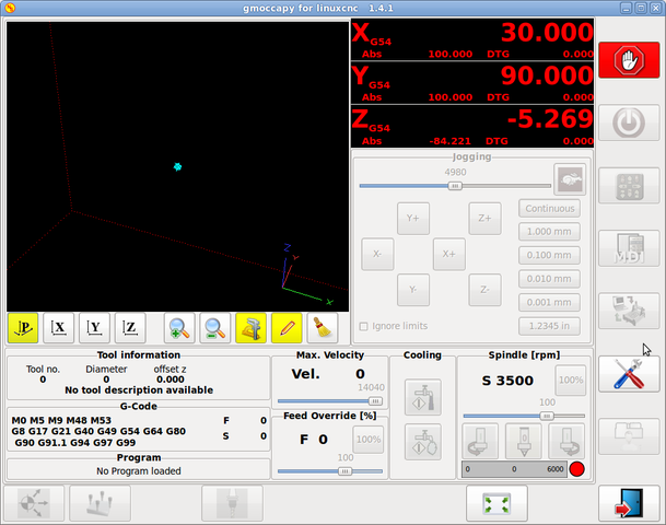

gmoccapy, a touch screen GUI based on Gscreen.
![../gui/images/gmoccapy_3_axis.png](../gui/images/gmoccapy_3_axis.png)

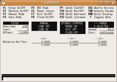

Keystick, a character-based screen graphics program suitable for minimal installations (without the X server running).
![../gui/images/keystick.png](../gui/images/keystick.png)
