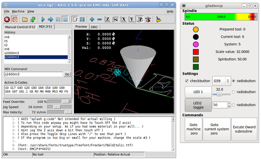

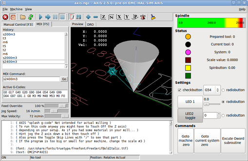

Run the sample GladeVCP panel integrated into Axis like PyVCP as follows:
$ cd configs/sim/gladevcp $ linuxcnc gladevcp_panel.ini
![images/example-panel-small.png](images/example-panel-small.png)

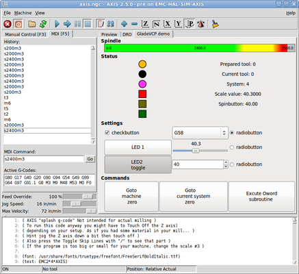

Run the same panel, but as a tab inside Axis:
$ cd configs/sim/gladevcp $ linuxcnc gladevcp_tab.ini

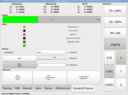

To run this panel inside Touchy:
$ cd configs/sim/gladevcp $ linuxcnc gladevcp_touchy.ini
![images/touchy-tab-33.png](images/touchy-tab-33.png)
Functionally these setups are identical - they only differ in screen real estate requirements and visibility. Since it is possible to run several GladeVCP components in parallel (with different HAL component names), mixed setups are possible as well - for instance a panel on the right hand side, and one or more tabs for less-frequently used parts of the interface.
2.1. Exploring the example panel
While running Axis, explore Show HAL Configuration - you will find the gladevcp HAL component and may observe their pin values while interacting with the widgets in the panel. The HAL setup can be found in configs/gladevcp/manual-example.hal.
The example panel has two frames at the bottom. The panel is configured so that resetting ESTOP activates the Settings frame and turning the machine on enables the Commands frame at the bottom. The HAL widgets in the Settings frame are linked to LEDs and labels in the Status frame, and to the current and prepared tool number - play with them to see the effect. Executing the T<toolnumber> and M6 commands in the MDI window will change the current and prepared tool number fields.

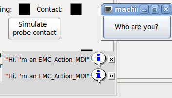

The buttons in the Commands frame are MDI Action widgets - pressing them will execute an MDI command in the interpreter. The third button Execute Oword subroutine is an advanced example - it takes several HAL pin values from the Settings frame, and passes them as parameters to the Oword subroutine. The actual parameters received by the routine are displayed by (DEBUG, ) commands - see configs/gladevcp/nc_files/oword.ngc for the subroutine body.
To see how the panel is integrated into Axis, see the [DISPLAY]GLADEVCP statements in gladevcp_panel.ui, and the [DISPLAY]EMBED* and [HAL]POSTGUI_HALFILE statements in gladevcp_tab.ini respectively.

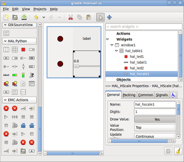

3.2. Running Glade to create a new user interface
This section just outlines the initial LinuxCNC-specific steps. For more information and a tutorial on glade, see http://glade.gnome.org. Some glade tips & tricks may also be found on youtube.
Either modify an existing UI component by running glade <file>.ui or start a new one by just running the glade command from the shell.
If LinuxCNC was not installed from a package, the LinuxCNC shell environment needs to be set up with . <linuxcncdir>/scripts/rip-environment, otherwise glade won’t find the LinuxCNC-specific widgets.
When asked for unsaved Preferences, just accept the defaults and hit Close.
From Toplevel (left pane), pick Window (first icon) as top level window, which by default will be named window1. Do not change this name - GladeVCP relies on it.

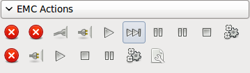

In the left tab, scroll down and expand HAL Python and EMC Actions.
add a container like a HAL_Box or a HAL_Table from HAL Python to the frame
pick and place some elements like LED, button, etc. within a container
This will look like so:
![images/glade-manual-small.png](images/glade-manual-small.png)
Glade tends to write a lot of messages to the shell window, which mostly can be ignored. Select File→Save as, give it a name like myui.ui and make sure it’s saved as GtkBuilder file (radio button left bottom corner in Save dialog). GladeVCP will also process the older libglade format correctly but there is no point in using it. The convention for GtkBuilder file extension is .ui.

6.15. Gremlin tool path preview for .ngc files
Gremlin is a plot preview widget similar to the Axis preview window. It assumes a running LinuxCNC environment like Axis or Touchy. To connect to it, inspects the INI_FILE_NAME environment variable. Gremlin displays the current .ngc file - it does monitor for changes and reloads the ngc file if the file name in Axis/Touchy changes. If you run it in a GladeVCP application when LinuxCNC is not running, you might get a traceback because the Gremlin widget can’t find LinuxCNC status, like the current file name.
Gremlin does not export any HAL pins. It has the following properties:
- view
may be any of x, y, z, p (perspective) . Defaults to z view.
- enable_dro
boolean; whether to draw a DRO on the plot or not. Defaults to True.
Example:

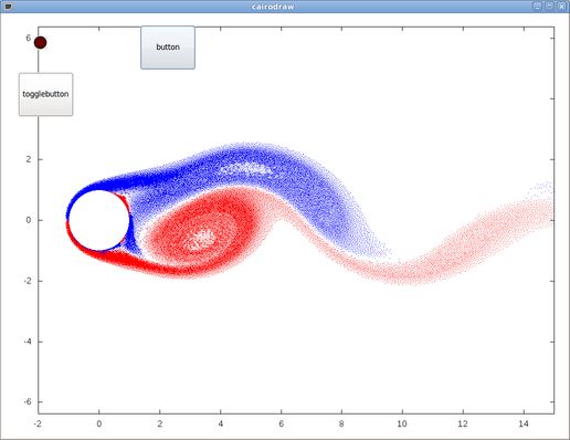

6.16. Animated function diagrams: HAL widgets in a bitmap
For some applications it might be desirable to have background image - like a functional diagram - and position widgets at appropriate places in that diagram. A good combination is setting a bitmap background image, like from a .png file, making the gladevcp window fixed-size, and use the glade Fixed widget to position widgets on this image.
The code for the below example can be found in configs/gladevcp/animated-backdrop:

The appearance of EMC Actions in Glade is roughly as follows:
![images/emc-actions.png](images/emc-actions.png)
Tooltip hovers provide a description.

7.4. A simple example: Execute MDI command on button press
configs/gladevcp/mdi-command-example/whoareyou.ui is a Glade UI file which conveys the basics:
Open it in Glade and study how it’s done. Start Axis, and then start this from a terminal window with gladevcp whoareyou.ui. See the hal_action_mdi1 Action and it’s MDI command property - this just executes (MSG, "Hi, I’m an EMC_Action_MDI") so there should be a message popup in Axis like so:
![images/whoareyou.png](images/whoareyou.png)
You’ll notice that the button associated with the Action_MDI action is grayed out if the machine is off, in E-Stop or the interpreter is running. It will automatically become active when the machine is turned on and out of E-Stop, and the program is idle.

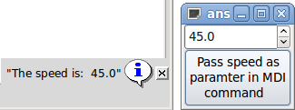

7.5. Parameter passing with Action_MDI and ToggleAction_MDI widgets
Optionally, MDI command strings may have parameters substituted before they are passed to the interpreter. Parameters currently may be names of HAL pins in the GladeVCP component. This is how it works:
assume you have a HAL SpinBox named speed, and you want to pass it’s current value as a parameter in an MDI command.
The HAL SpinBox will have a float-type HAL pin named speed-f (see HalWidgets description).
To substitute this value in the MDI command, insert the HAL pin name enclosed like so: ${pin-name}
for the above HAL SpinBox, we could use (MSG, "The speed is: ${speed-f}") just to show what’s happening.
The example UI file is configs/gladevcp/mdi-command-example/speed.ui. Here’s what you get when running it:
![images/speed.png](images/speed.png)

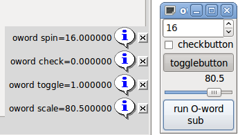

7.6. An advanced example: Feeding parameters to an O-word subroutine
It’s perfectly OK to call an O-word subroutine in an MDI command, and pass HAL pin values as actual parameters. An example UI file is in configs/gladevcp/mdi-command-example/owordsub.ui.
Place configs/gladevcp/nc_files/oword.ngc so Axis can find it, and run gladevcp owordsub.ui from a terminal window. This looks like so:
