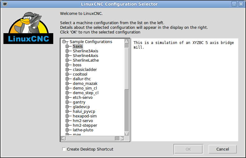

Configuration Selector
If no ini file is passed to the linuxcnc script it loads the configuration selector so you can choose and save a sample configuration. Once a sample configuration has been saved it can be modified to suit your application.
images/configuration-selector.png
Figure 1. Configuration Selector
