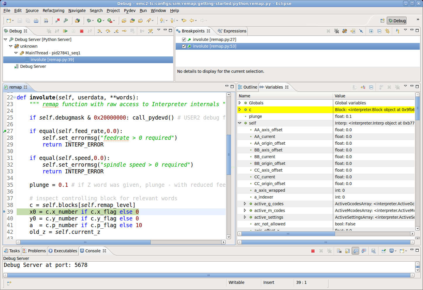

REMAP=G88.1 modalgroup=1 py=involute
The involute
function in python/remap.py
listed below does all word extraction from the current block directly. Note that interpreter errors can be translated to Python exceptions. Remember this is readahead time - execution time errors cannot be trapped this way.
import sys import traceback from math import sin,cos from interpreter import * from emccanon import MESSAGE from util import lineno, call_pydevd # raises InterpreterException if execute() or read() fails throw_exceptions = 1 def involute(self, **words): """ remap-Funktion mit Rohzugriff auf Interpreter-Interna """ if self.debugmask & 0x20000000: call_pydevd() # USER2 debug flag if equal(self.feed_rate,0.0): return "feedrate > 0 required" if equal(self.speed[0], 0.0): return "spindle speed > 0 required" plunge = 0.1 # if Z word was given, plunge - with reduced feed # Kontrollblock auf relevante Wörter untersuchen c = self.blocks[self.remap_level] x0 = c.x_number if c.x_flag else 0 y0 = c.y_number if c.y_flag else 0 a = c.p_number if c.p_flag else 10 old_z = self.current_z if self.debugmask & 0x10000000: print("x0=%f y0=%f a=%f old_z=%f" % (x0,y0,a,old_z)) try: #self.execute("G3456") # would raise InterpreterException self.execute("G21",lineno()) self.execute("G64 P0.001",lineno()) self.execute("G0 X%f Y%f" % (x0,y0),lineno()) if c.z_flag: feed = self.feed_rate self.execute("F%f G1 Z%f" % (feed * plunge, c.z_number),lineno()) self.execute("F%f" % (feed),lineno()) for i in range(100): t = i/10. x = x0 + a * (cos(t) + t * sin(t)) y = y0 + a * (sin(t) - t * cos(t)) self.execute("G1 X%f Y%f" % (x,y),lineno()) if c.z_flag: # retract to starting height self.execute("G0 Z%f" % (old_z),lineno()) except InterpreterException,e: msg = "%d: '%s' - %s" % (e.line_number,e.line_text, e.error_message) return msg return INTERP_OK

12.5. Fehlersuche in eingebettetem Python-Code
Debugging of embedded Python code is harder than debugging normal Python scripts, and only a limited supply of debuggers exists. A working open-source based solution is to use the Eclipse IDE, and the PydDev Eclipse plug in and its remote debugging feature.
Um diesen Ansatz zu verwenden:
Installieren Sie Eclipse über das Ubuntu Software Center (wählen Sie die erste Option).
Install the PyDev plug in from the Pydev Update Site.
Setup the LinuxCNC source tree as an Eclipse project.
Start the Pydev Debug Server in Eclipse.
Make sure the embedded Python code can find the
pydevd.py
module which comes with that plug in - it is buried somewhere deep under the Eclipse install directory. Set the thepydevd
variable inutil.py
to reflect this directory location. -
Add
import pydevd
to your Python module - see exampleutil.py
andremap.py
Call
pydevd.settrace()
in your module at some point to connect to the Eclipse Python debug server - here you can set breakpoints in your code, inspect variables, step etc. as usual.
Achtung
pydevd.settrace() will block execution if Eclipse and the Pydev debug server have not been started. |
To cover the last two steps: the o<pydevd>
procedure helps to get into the debugger from MDI mode. See also the call_pydevd
function in util.py
and its usage in remap.involute
to set a breakpoint.
Here’s a screen-shot of Eclipse/PyDevd debugging the involute
procedure from above:
See the Python code in configs/sim/axis/remap/getting-started/python
for details.
