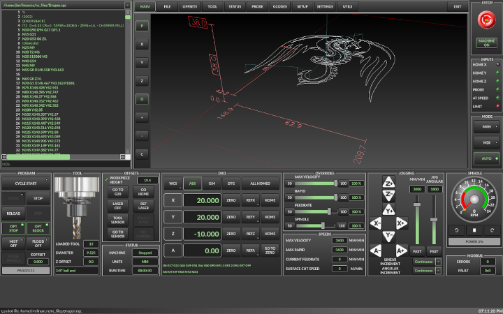

1.1. QtDragon
QtDragon Router
Figure 1. QtDragon - 3 to 5 axis sample (1440x860) in silver theme
QtDragon is resizable from a resolution of 1280x768 to 1680x1200. It will work in window mode on any monitor with higher resolution but not on monitors with lower resolution.

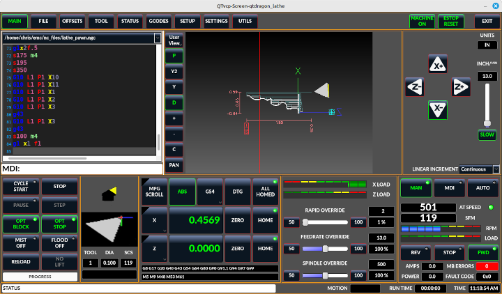

1.2. QtDragon_lathe
QtDragon Lathe
QtDragon_lathe is a modified version of QtDragon more suitable for lathes.
It is resizable from a resolution of 1280x768 to 1680x1200.

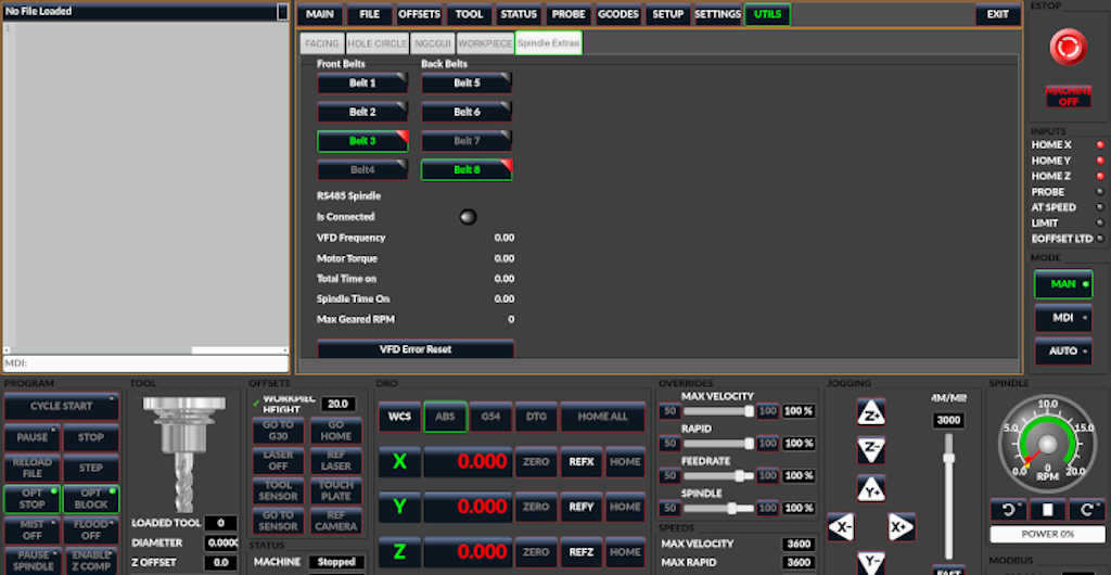

2.10.2. Embedding Spindle Belts Panel
This example panel is designed to display additional RS485 VFD data and also to configure a 4 sheave, 2 belt spindle drive via a series of buttons.
QtDragon spindle_belts Panel - Spindle Belts VCP
[DISPLAY]
EMBED_TAB_NAME = Spindle Belts
EMBED_TAB_COMMAND = qtvcp spindle_belts
EMBED_TAB_LOCATION = tabWidget_utilities

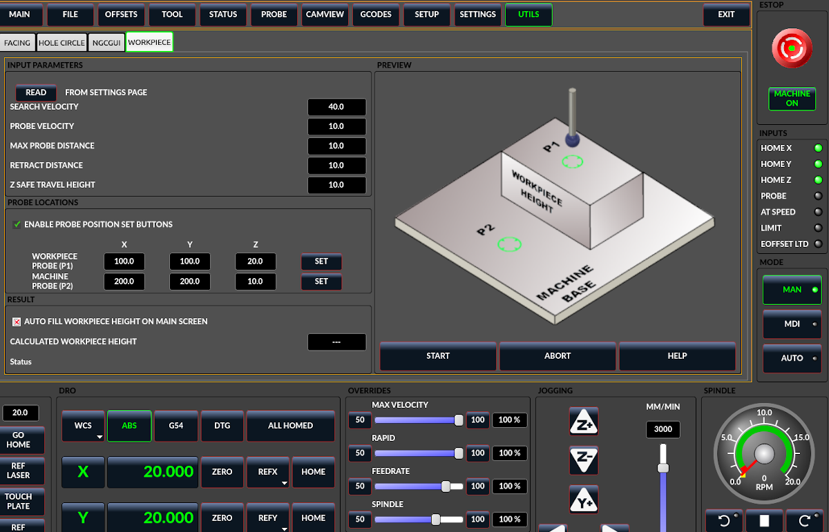

2.14. Probe/Touchplate/Laser Settings
QtDragon has INI entries for two optional probing tab screens available. Comment/uncomment which ever you prefer.
  • Versa probe is a QtVCP ported version of a popular GladeVCP probing panel.
  • Basic Probe is a QtVCP ported version based on the third party basic probe screen.
Both perform similar probing routines, though Versa probe optionally handles auto tool measurement.
[PROBE]
#USE_PROBE = versaprobe
USE_PROBE = basicprobe

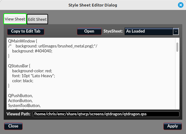

F12 - Style Editor

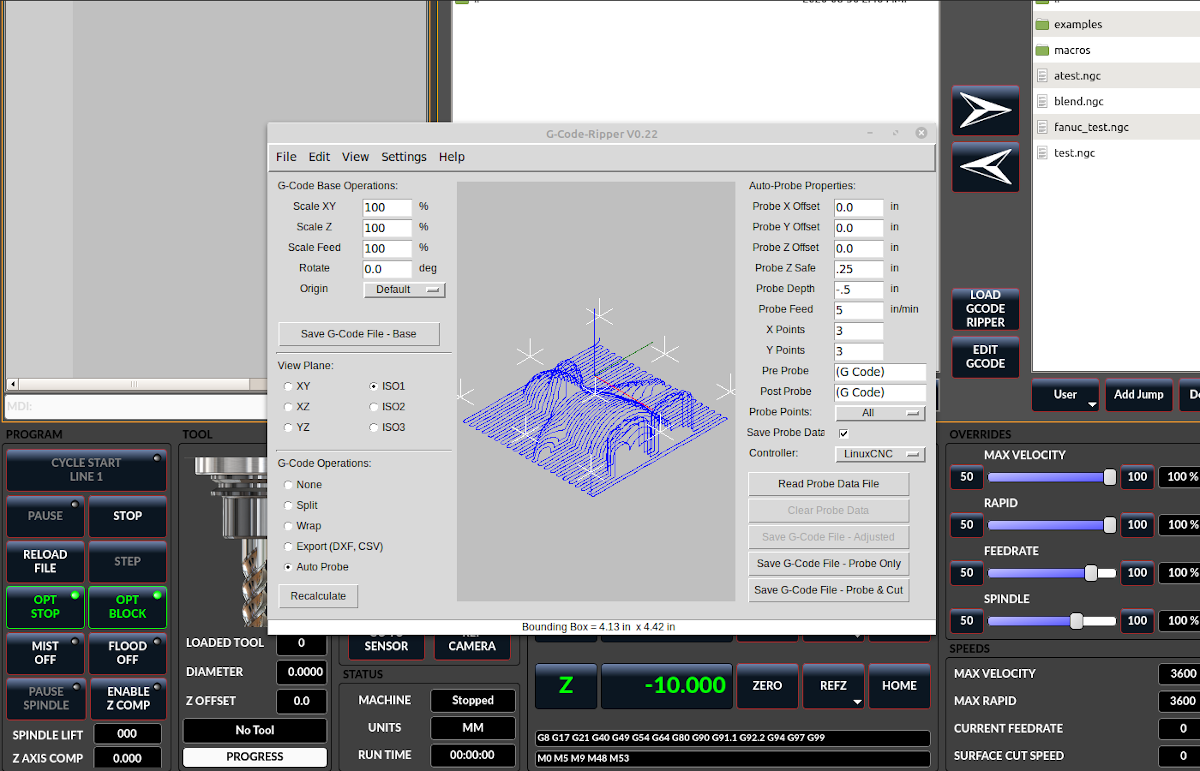

11.1. Using G-code Ripper for Z level Compensation
QtDragon G-code Ripper
Figure 3. QtDragon_hd showing G-code Ripper
Note
G-code Ripper offers many functions that we will not go in to here. This is only available in the QtDragon_hd version.
  • In qtdragon_hd, switch to the file tab and press the load G-code Ripper button.
  • Set origin to match the origin of the G-code file to be probed.
  • Under G-Code Operations, check Auto Probe.
  • File → Open G-Code File (The file you will run after compensation)
  • If necessary, make adjustments and press Recalculate.
  • Press Save G-Code File - Probe Only.
  • Save the generated file to the nc_files folder.
  • Exit gcode_ripper.
  • There should now be a file in the nc_files folder called {something}-probe-only.ngc. Set the file filter to G-Code files, navigate to the nc_files directory and load this file.
  • Without changing the offsets, run this program. Make sure the probe tool is installed. When complete, there will be a file in the config directory called probe_points.txt.
  • In qtdragon_hd, press the Enable Z Comp button to enable compensation. Look at the status line for indication of success or failure. Active compensation will be displayed beside the label: Z Level Comp While jogging that display should change based on the compensation component.
Note
If you use auto raise Z to lift the spindle on pause, you must combine the two with a HAL component and feed that to LinuxCNC’s motion component.
Sample postgui HAL file for combined spindle raise and Z Level compensation

14.5. Work Piece Height Probing
QtDragon_hd height probing
Figure 8. QtDragon_hd - Work piece Height probing
This program probes 2 user specified locations in the Z axis and calculates the difference in heights.
Note
Enable Probe Position Set Buttons
  • When checked, the SET buttons are enabled.
  • This allows the user to automatically fill in the X, Y and Z parameters with the current position as displayed on the DROs.
Autofill Workpiece Height on Main Screen
  • When checked, the calculated height is automatically transferred to the Workpiece Height field in the main screen.
  • Otherwise, the main screen is not affected.
Workpiece Probe At
  • the X, Y and Z coordinates specify where the first probing routine should start, in current WCS
Machine Probe At
  • the X, Y and Z coordinates specify where the second probing routine should start, in current WCS
Z Safe Travel Height
  • The machine is raised to the Z safe travel height before jogging to the X and Y coordinates.
  • The spindle then lowers to the specified Z coordinate.
  • It should be selected so that the tool clears all obstructions while jogging.
START button
  • The machine will jog to the first location and then probe down.
  • The machine then jogs to the second location and probes down again.
  • The difference in probed values is reported as Calculated Workpiece Height.
  • The parameters for search velocity, probe velocity, maximum probe distance and return distance are read from the main GUI Settings page.
ABORT button
  • causes all jog and probe routines currently executing to stop.
HELP button
  • displays this help file.
Note
  • Any 2 points within the machine operating volume can be specified.
  • If the first point is higher than the second, the calculated height will be a positive number.
  • If the first point is lower than the second, the calculated height will be a negative number.
  • Units are irrelevant in this program. The probed values are not saved and only the difference is reported.
Caution
Setting incorrect values can lead to crashes into fixtures on the machine work surface. Initial testing with no tool and safe heights is recommended.

17. Tabs Description
Tabs allow the user to select the most appropriate info/control on the top three panels. If the on screen keyboard is showing and the user wishes to hide it but keep the current tab, they can do that by pressing the HIDE button on the virtual keyboard. In QtDragon, there is a splitter handle between the G-code text display and the G-code graphical display. One can use this to split the size between the two areas. This can be set differently in each tab and in each mode. The positions will be remembered.

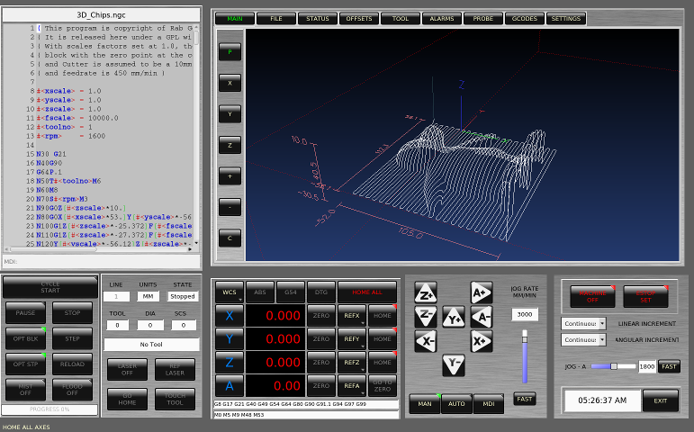

17.1. Main tab
This tab displays the graphical representation of the current program. The side buttons will control the display.
  • User View: Select/restore a user set view of the current program.
  • P,X,Y,Z: Set standard views.
  • D: Toggle display of dimensions.
  • +, -: Zoom controls.
  • C: Clear graphics of tool movement lines.
In qtdragon_hd there are also macro buttons available on the right side. Up to tens buttons can be defined in the INI.
17.2. File Tab
You can use this tab to load or transfer programs. Editing of G-code programs can be selected from this tab. With qtdragon_hd, this is where you can load the G-code Ripper.

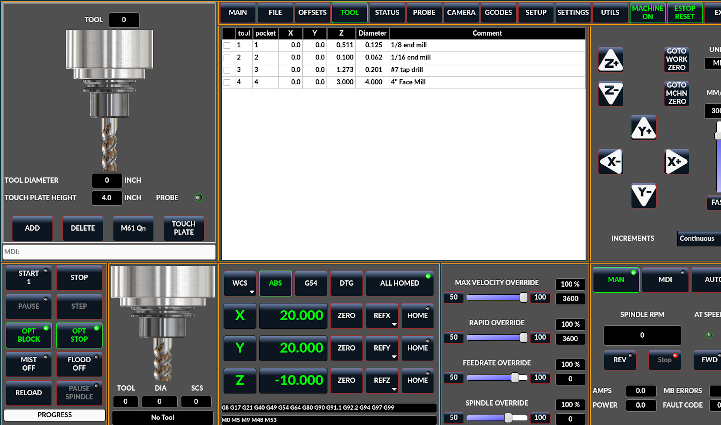

17.4. Tool Tab
You can monitor/modify tool offsets from this tab. Adding and deleting tools from the tool file can also be done from this tab. When this tab is selected the individual home buttons in the DRO area will change to tool offset setting buttons. They will return to home buttons when you select another tab. Pressing this tool button will drop down a when menu of options:
  • Set Current Tool Position
  • Adjust Current Tool Position
  • Zero Current Tool Position
  • Set Tool Offset Directly
  • Reset To Last

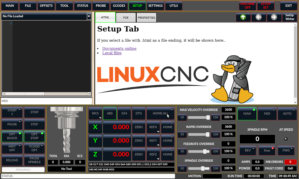

17.9. Setup Tab
It’s possible to load HTML or PDF file (.html / .pdf ending) with setup notes, and will be displayed in the setup tab.
If you load a G-code program and there is an HTML/PDF file of the same name, it will load automatically.
Some program, such as Fusion 360 and Aspire will create these files for you. You can also write your own HTML docs with the included SetUp Writer button.
There are three sub tabs:
  • HTML - any loaded HTML pages are displayed here. The navigation buttons work on this page.
  • PDF - any loaded PDF setup pages are displayed here.
  • PROPERTIES - when a program is loaded its G-code properties are displayed here.
There are navigation buttons for HTML page:
  • The up arrow returns you to the default HTML page.
  • The left arrow moves backward one HTML page.
  • The right arrow moves forward one HTML page.
If you wish to include a custom default HTML page, name it default_setup.html and place it in your configuration folder.
Custom QtVCP panels can be displayed in this tab by setting the EMBED_TAB_LOCATION option to tabWidget_setup.
QtDragon Setup Tab
Figure 9. QtDragon - Setup Tab Sample

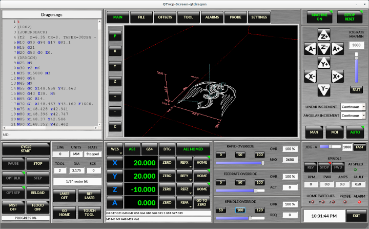

19. Styles
Nearly all aspects of the GUI appearance are configurable via the QtDragon.qss stylesheet file. The file can be edited manually or through the stylesheet dialog widget in the GUI. To call up the dialog, press F12 on the main window. New styles can be applied temporarily and then saved to a new qss file, or overwrite the current qss file.
QtDragon styles
Figure 10. QtDragon - Two Style Examples

21. Customization
A general overview of Customizing Stock Screens.
21.1. Stylesheets
Stylesheets can be leveraged to do a fair amount of customization, but you usually need to know a bit about the widget names. Pressing F12 will display a stylesheet editor dialog to load/test/save modification.
The View Sheet tab will allow you to select and apply what stylesheet QtDragon will use when it’s first loaded.
Press the button Copy to Edit Tab to copy the current stylesheet to the edit tab.
The Edit Sheet tab allows editing, applying and saving of changes od the displayed stylesheet.
QtDragon stylesheet editor
Sometimes these lines will be present and you can change them, otherwise you will need to add them.
For instance, to change the DRO font (look for this entry and change the font name):
DROLabel,
StatusLabel#status_rpm {
    border: 1px solid black;
    border-radius: 4px;
    font: 20pt "Noto Mono";
To change the DRO display font and display format:
DROLabel {
    font: 25pt "Lato Heavy";
    qproperty-imperial_template: '%9.5f';
    qproperty-metric_template: '%10.4f';
    qproperty-angular_template: '%11.2f';
    /*Adjust the menu options */
    qproperty-showLast: true;
    qproperty-showDivide : false;
    qproperty-showGotoOrigin: false;
    qproperty-showZeroOrigin: false;
    qproperty-showSetOrigin: true;
    qproperty-dialogName: CALCULATOR;
Change the axis select button’s click menu items:
AxisToolButton {
    /* Adjust all the menu options */
    qproperty-showLast: false;
    qproperty-showDivide : true;
    qproperty-showGotoOrigin: true;
    qproperty-showZeroOrigin: true;
    qproperty-showSetOrigin: false;
    qproperty-dialog_code_string: CALCULATOR;
To change the text of the mist button to air (add these lines)
#action_mist{
    qproperty-true_state_string: "Air\\nOn";
    qproperty-false_state_string: "Air\\nOff";
To change the Offsets display font and format:
ToolOffsetView {
    font: 20pt "Lato Heavy";
    qproperty-imperial_template: '%9.1f';
    qproperty-metric_template: '%10.1f';
OriginOffsetView {
    font: 12pt "Lato Heavy";
To stop the blur effect with dialogs:
#screen_options {
    qproperty-focusBlur_option: false;
To change status highlight/selection colors:
#screen_options {
    qproperty-user1Color: white;     /*  default status     */
    qproperty-user2Color: #ff9000;   /*  warning status     */
    qproperty-user3Color: #ff8a96;   /*  critical status    */
    qproperty-user4Color: #ffaa00;   /*  MPG select         */
    qproperty-user5Color: #ff0000;   /*  Cycle Start select */
Change the G-code text display colors/fonts:
EditorBase{
background:black;
qproperty-styleColorCursor:white;
qproperty-styleColorBackground:grey;
qproperty-styleColor0: black;
qproperty-styleColor1: darkblue;
qproperty-styleColor2: blue;
qproperty-styleColor3: red;
qproperty-styleColor4: lightblue;
qproperty-styleColor5: white;
qproperty-styleColor6: lightGreen;
qproperty-styleColor7: yellow ;
qproperty-styleColorSelectionText: white;
qproperty-styleColorSelectionBackground: blue;
qproperty-styleFont0: "Times,15,-1,5,90,0,0,1,1,0";
qproperty-styleFont1: "Times,15,-1,5,90,1,0,1,0,0";
qproperty-styleFont2: "Times,15,-1,5,90,0,0,1,1,0";
qproperty-styleFont3: "Times,15,-1,5,90,0,0,1,1,0";
qproperty-styleFont4: "Times,15,-1,5,90,0,0,1,1,0";
qproperty-styleFont5: "Times,15,-1,5,90,0,0,1,1,0";
qproperty-styleFont6: "Times,15,-1,5,90,0,0,1,1,0";
qproperty-styleFont7: "Times,15,-1,5,90,0,0,1,1,0";
To have the manual spindle buttons also incrementally increase/decrease speed:
#action_spindle_fwd{
    qproperty-spindle_up_action: true;
#action_spindle_rev{
    qproperty-spindle_down_action: true;
21.2. Qt Designer and Python code
All aspects of the GUI are fully customization through Qt Designer and/or Python code.
This capability is included with the QtVCP development environment.
The extensive use of QtVCP widgets keeps the amount of required Python code to a minimum, allowing relatively easy modifications.
The LinuxCNC website has extensive documentation on the installation and use of QtVCP libraries.
See QtVCP for more information about QtVCP in general.
Custom modifications can be added by subclassing the handler file. This adds code on top of the original.
QtDragon can also utilize QtVCP’s rc file to do minor python code modifications without using a custom handler file.
See Modifying Screens for more information about customization.
Some widget customization is available for basic probe and versa probe.
QtDragon customized
Figure 11. QtDragon - Customized QtDragon
