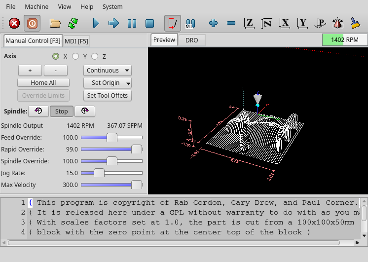

1. Showcase
Few examples of QtVCP built screens and virtual control panels:
