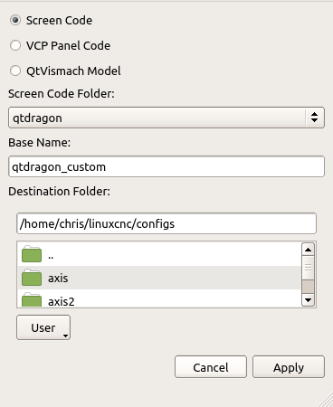

1.1. copy
Used for copying QtVCP’s builtin Screens/VCP Panels/QtVismach code to a folder so one can customize it.
In a terminal run:
qtvcp copy
copy
Dialog - Screen, VCP Panel or QtVismach Code Copy Panel1.2. spindle_belts

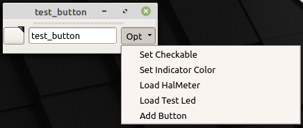

Panel - Test Dial VCP1.4. test_button
This panel has a button that will set a HAL pin.
The button can be selected as a momentary or a toggle button.
A HAL pin will be created that follows the button state.
The button’s indicator color can be adjusted from a drop down menu.
A HAL pin or signal can be selected to follow the button state.
You can add more buttons from the drop down menu.
You can load a Halmeter from the drop down menu.
You can load a test LED from the drop down menu.
The button can be detached from the main windows.
Here is how to load test_button
from a HAL script:
loadusr qtvcp test_button loadusr qtvcp -o 4 test_button
The -o
switch sets how many buttons the panel starts with.
If loading directly from a terminal omit the loadusr
test_button

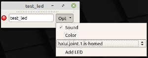

- Test Button VCP1.5. test_led
This panel has an LED that can selected to watch HAL bit pins/signals.
The LED’s color can be adjusted from a drop down menu.
The text box and state can be output as speech if sound is selected.
A
combobox
can be used to automatically select and connect to a pin/signal. -
You can add more LEDs from the drop down menu.
The LED can be detached from the main windows.

test_dial

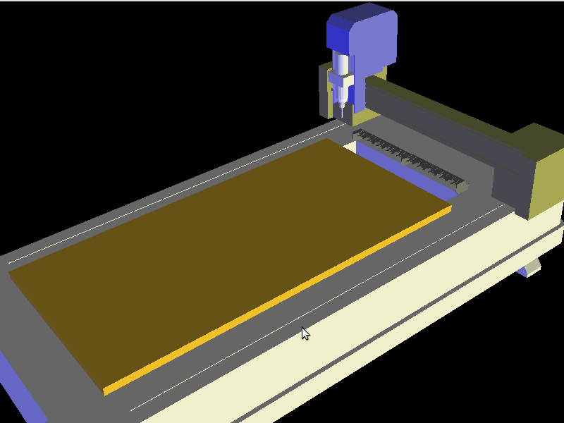

- 3-Axis Mill 3D View Panel2.2. QtVCP vismach_router_atc
3D OpenGL view of a 3-Axis router style, gantry bed milling machine.
This particular panel shows how to define and connect the model parts in the handler file,
rather then importing the pre-built model from QtVCP’s vismach library.
loadusr qtvcp vismach_router_atc
vismach_router_atc

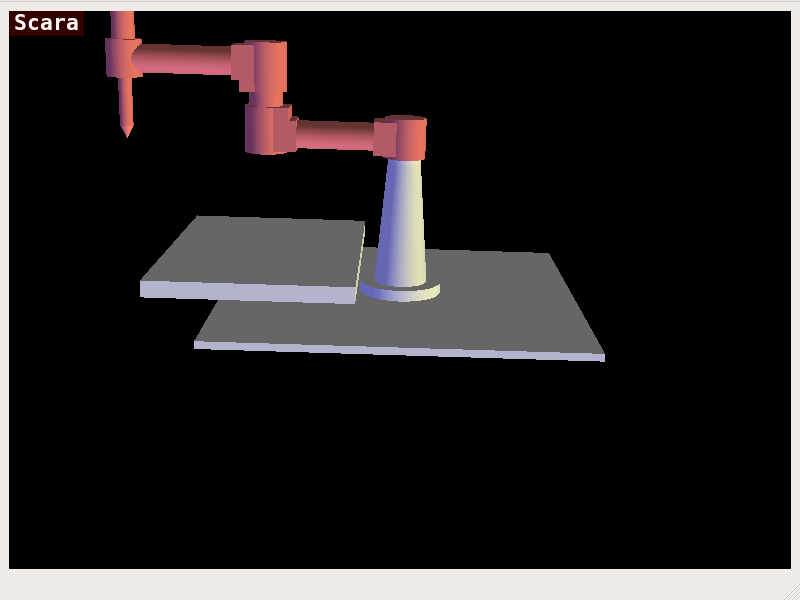

- 3-Axis Gantry Bed Mill 3D View Panel2.3. QtVCP vismach_scara
3D OpenGL view of a SCARA based milling machine.
loadusr qtvcp vismach_scara
vismach_scara

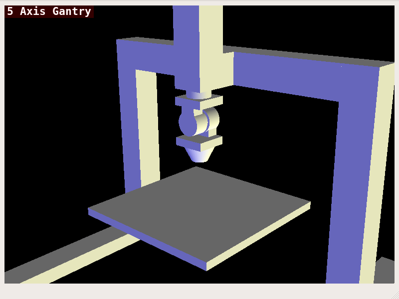

- 4 Axis MillTurn 3D View Panel2.5. QtVCP vismach_mill_5axis_gantry
3D OpenGL view of a 5-Axis gantry type milling machine.
loadusr qtvcp vismach_mill_5axis_gantry
