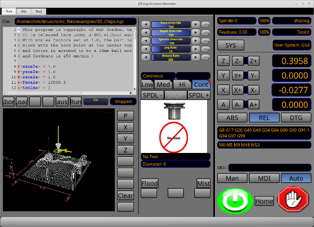

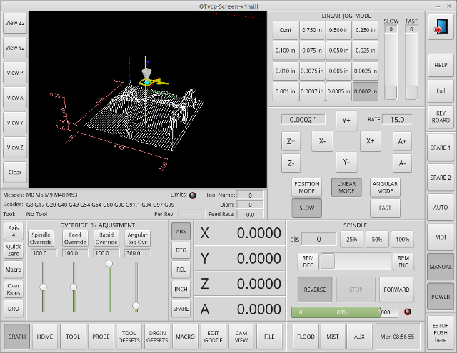

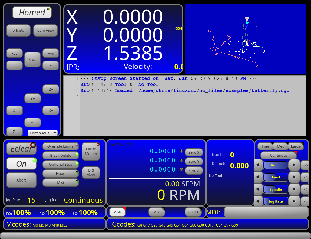

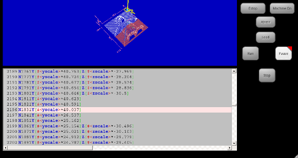

1. Showcase

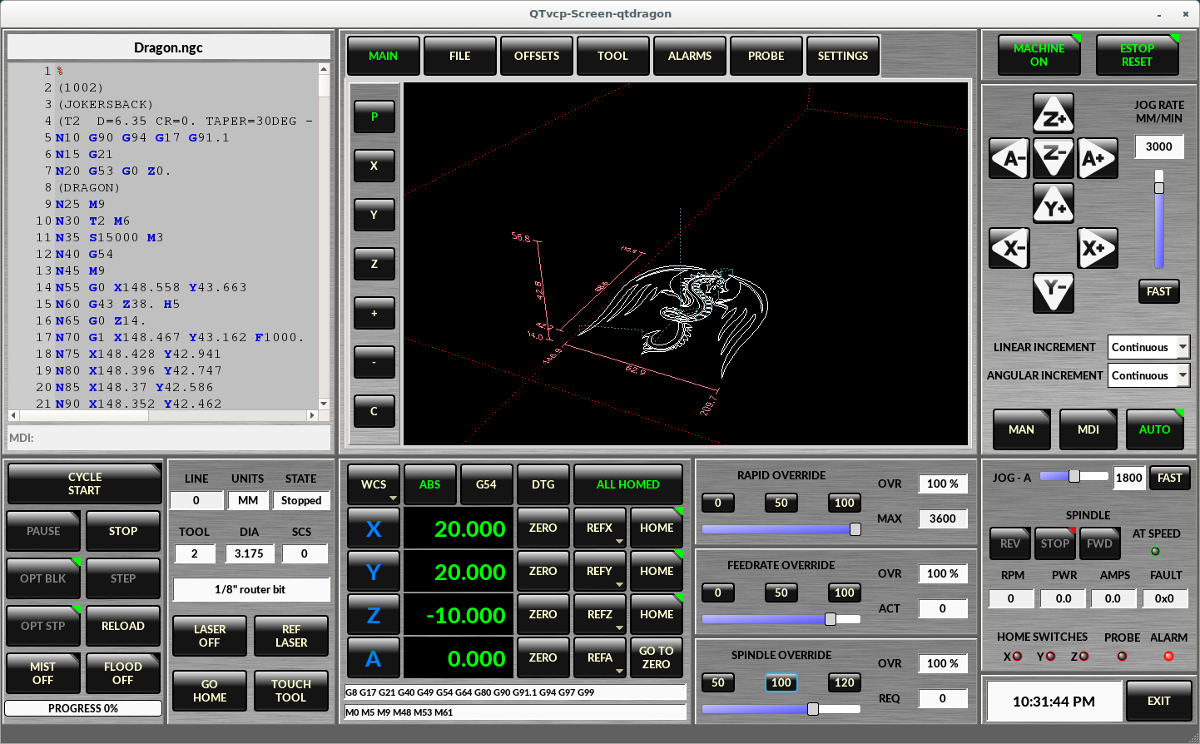

Few examples of QtVCP built screens and virtual control panels:

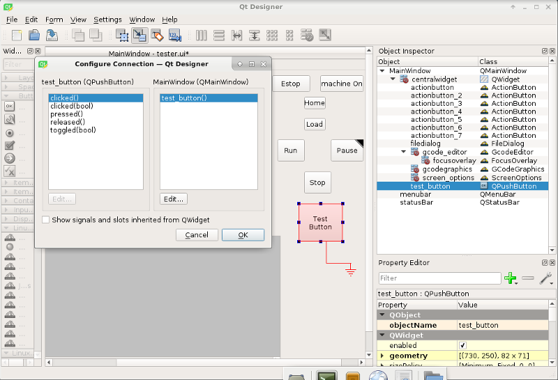

4.2. Get Qt Designer To Include LinuxCNC Widgets
First you must have the Qt Designer installed.
The following commands should add it to your system, or use your package manager to do the same:
sudo apt-get install qttools5-dev-tools qttools5-dev libpython3-dev
qtvcp_plugin.py link to the Qt Designer Search PathThen you must add a link to the qtvcp_plugin.py in one of the folders that Qt Designer will search into.
In a RIP version of LinuxCNC qtvcp_plugin.py will be:
'~/LINUXCNC_PROJECT_NAME/lib/python/qtvcp/plugins/qtvcp_plugin.py'
For a Package installed version it should be:
'usr/lib/python2.7/qtvcp/plugins/qtvcp_plugin.py' or
'usr/lib/python2.7/dist-packages/qtvcp/plugins/qtvcp_plugin.py'
Make a symbolic link to the above file and move it to one of the places Qt Designer searches in.
Qt Designer searches in these two place for links (pick one):
'/usr/lib/x86_64-linux-gnu/qt5/plugins/designer/python' or
'~/.designer/plugins/python'
You may need to create the plugins/python folder.
For a RIP install:
Open a terminal, set the environment for LinuxCNC <1>, then load Qt Designer <2> with :. scripts/rip-environment <1> designer -qt=5 <2> -
For a package install:

4.3. Build The Screen .ui File
MainWindow WidgetWhen Qt Designer is first started there is a 'New Form' dialog displayed.
Pick 'Main Window' and press the 'Create' button.
A MainWindow widget is displayed.
We are going to make this window a specific non resizeable size:
MainWindow Minimum and Maximum Size-
Grab the corner of the window and resize to an appropriate size, say 1000x600.
Right click on the window and click set minimum size.
Do it again and set maximum size.
Our sample widget will now not be resizable.
ScreenOptions WidgetDrag and drop the ScreenOptions widget anywhere onto the main window.
This widget doesn’t add anything visually but sets up some common options.
It’s recommended to always add this widget before any other.
Right click on the main window, not the ScreenOptions widget, and set the layout as vertical to make the ScreenOptions fullsized.
On the right hand side there is a panel with tabs for a Property editor and an Object inspector.
On the Object inspector click on the ScreenOptions.
Then switch to the Property Editor and, under the ScreenOptions heading, toggle filedialog_option.
Drag and drop a GCodeGraphics widget and a GcodeEditor widget.
Place and resize them as you see fit leaving some room for buttons.
Add 7 action buttons on to the main window.
If you double click the button, you can add text.
Edit the button labels for Estop, Machine On, Home, Load, Run, Pause and stop.
Action buttons default to no action so we must change the properties for defined functions. You can edit the properties:
directly in the property editor on the right side of Qt Designer, or
conveniently, left double clicking on the button to launch a properties dialog that allows selecting actions while only displaying relevant data to the action.
We will describe the convenient way first:
Right click the Machine On button and select Set Actions.
When the dialog displays, use the combobox to navigate to
MACHINE CONTROLS - Machine On. -
In this case there is no option for this action so select OK.
Now the button will turn the machine on when pressed.
And now the direct way with Qt Designer’s property editor:
Select the Machine On button.
Go to the Property Editor on the right side of Qt Designer.
Scroll down until you find the ActionButton heading.
Click the
machine_onaction checkbox you will see in the list of properties and values.
The button will now control machine on/off.
Do the same for all the other button with the addition of:

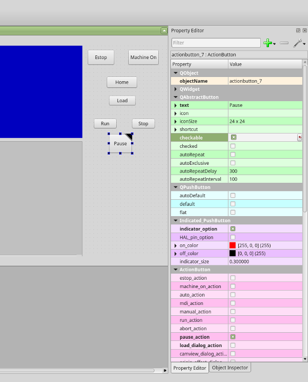

With the Home button we must also change the
joint_numberproperty to-1.
This tells the controller to home all the axes rather then a specific axis. -
With the Pause button:
Under the
Indicated_PushButtonheading check theindicator_option. -
Under the
QAbstactButtonheading checkcheckable.
.ui FileWe then need to save this design as tester.ui in the sim/qtvcp folder.
We are saving it as tester as that is a file name that QtVCP recognizes and will use a built in handler file to display it.

6.2. Using Qt Designer to add Slots
When you have loaded your screen into Qt Designer, add a plain PushButton to the screen.
You could change the name of the button to something interesting like test_button.
There are two ways to edit connections - This is the graphical way.
There is a button in the top tool bar of Qt Designer for editing signals. After pushing it, if you click-and-hold on the button it will show an arrow (looks like a ground signal from electrical schematic).
Slide this arrow to a part of the main window that does not have widgets on it.
A Configure Connections dialog will pop up.
The list on the left are the available signals from the widget.
The list on the right are the available slots on the main window and you can add to it.
Pick the signal
clicked()- this makes the slots side available. -
Click Edit on the slots list.
A Slots/Signals of MainWindow dialog will pop up.
On the slots list at the top there is a + icon - click it.
You can now edit a new slot name.
Erase the default name
slot()and change it totest_button() -
Press the OK button.
You’ll be back to the Configure Connections dialog.
Now you can select your new slot in the slot list.
Then press OK and save the file.
