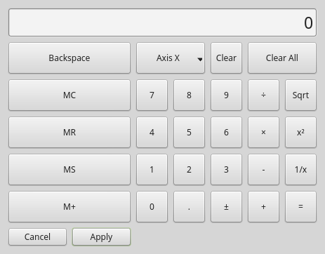

2.4. AxisToolButton - Select and Set Axis Widget
This allows one to select and set an axis.
If the button is set checkable, it will indicate which axis is selected.
If you press and hold the button a pop up menu will show allowing one to:
Zero the axis
Divide the axis by 2
Set the axis arbitrarily
Reset the axis to the last number recorded
You must have selected an entry dialog that corresponds to the dialog_code_string, usually this is selected from the screenOptions widget.
You can select the property halpin_option, it will then set a HAL pin true when the axis is selected. The property joint_number should be set to the appropriate joint number. The property axis_letter should be set to the appropriate axis letter.
The property dialog_code_string can be changed to ENTRY or CALCULATOR to call a typing only entry dialog or a touch/typing calculator type entry dialog.
It is based on PyQt’s QToolButton.

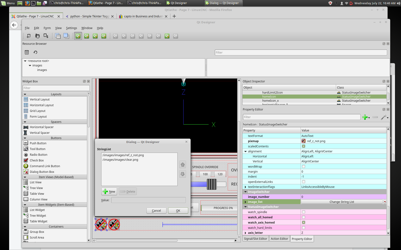

Here is an example of using it to display an icon of Z axis homing state:
In the properties section notice that:
watch_axis_homedis checked -
axis_letteris set to Z
If you double click the image_list a dialog will show and allow you to add image paths to.
If you have one image as an icon and one clear image then that will look like it shows and hides the icon.
Selecting image paths can be done by selecting the pixmap property and selecting an image.
The pixmap setting is for test display only and will be ignored outside of Qt Designer. |
Right click the image name and you should see Copy path.
Click Copy path.
Now double click the image list property so the dialog shows.
Click the New button.
Paste the image path in the entry box.
Do that again for the next image.
Use a clear image to represent a hidden icon.
You can test the images display from the image list by changing the image number. In this case 0 is unhomed and 1 would be homed.
This is for test display only and will be ignored outside of Qt Designer.

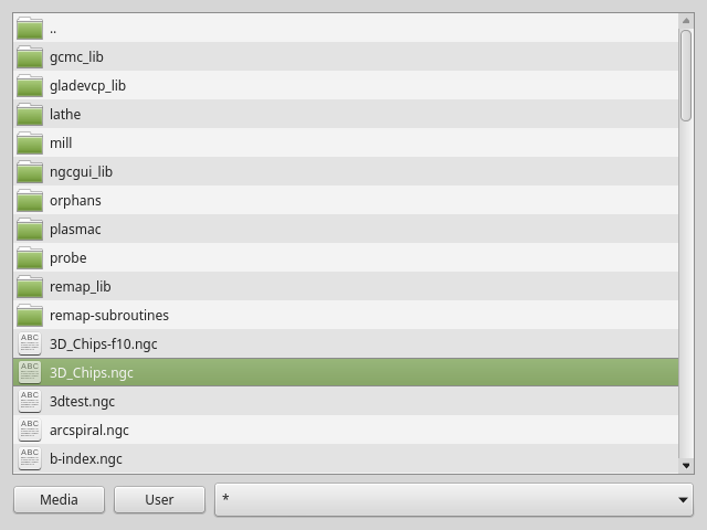

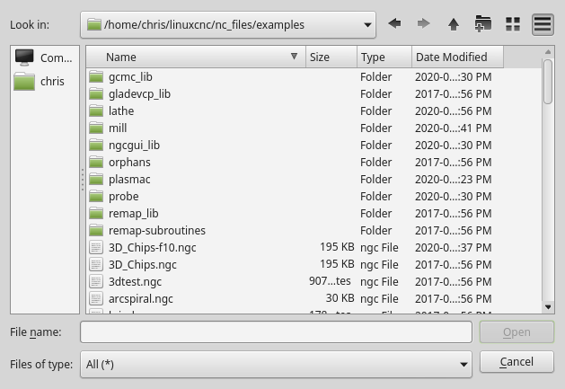

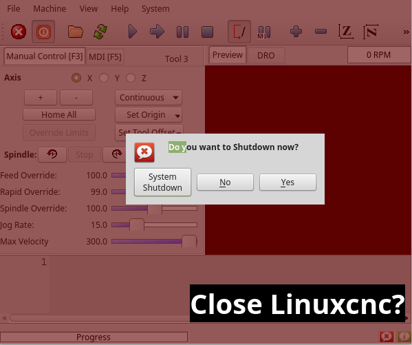

2.15. ScreenOption - General Options Setting widget
This widget doesn’t add anything visually to a screen but sets up important options.
This is the preferred way to use these options.
These properties can be set in Qt Designer, in Python handler code or (if appropriate) in stylesheets.
These include:
halCompBaseName -
If left empty QtVCP will use the screen’s name as the HAL component’s basename.
If set, QtVCP will use this string as the HAL component’s basename.
If the-ccommand line option is used when loading QtVCP, it will use the name specified on the command line - it overrides all above options.
If you programmatically set the basename in thehandlerfile- it will override all above options.
This property cannot be set in stylesheets. -
notify_option -
Hooking into the desktop notification bubbles for error and messages.
notify_max_messages -
Number of messages shown on screen at one time.
catch_close_option -
Catching the close event to pop up a 'are you sure' prompt.
close_overlay_color -
Color of transparent layer shown when quitting.
catch_error_option -
Monitoring of the LinuxCNC error channel.
This also sends the message throughSTATUSto anything that registers. -
play_sounds_option -
Playing sounds using
beep,espeakand the system sound. -
use_pref_file_option -
Setting up a preferences file path.
Using the magic wordWORKINGFOLDERin the preference file path will be replaced with the launched configuration path, e.g.WORKINFOLDER/my_preferences. -
use_send_zmq_option -
Used to initiate ZMQ based outgoing messages.
use_receive_zmq_messages -
Used to initiate ZMQ based in coming messages.
These messages can be used to call functions in the handler file, allowing external programs to integrate tightly with QtVCP based screens. -
embedded_program_option -
Embed programs defined in the INI.
default_embed_tab -
This is the property for a default location to embed external programs.
It should be set to name of a tab page widget in Qt Designer. -
focusOverlay_option -
Focus_overlay will put a transparent image or colored panel over the main screen to emphasize focus to an external event - typically a dialog.
messageDialog_option -
Sets up the message dialog - used for general messages.
message_overlay_color -
Color of transparent layer shown when the message dialog is shown.
closeDialog_option -
Sets up the standard close screen prompt dialog.
entryDialog_option -
Sets up the numerical entry dialog.
entryDialogSoftKey_option -
Sets up a floating software keyboard when entry dialog is focused.
entry_overlay_color -
Color of transparent layer shown when the entry dialog is shown.
toolDialog_option -
Sets up the manual tool change dialog, including HAL pin.
tool_overlay_color -
Color of transparent layer shown when the tool dialog is shown.
ToolUseDesktopNotify -
Option to use desktop notify dialogs for manual tool change dialog.
ToolFrameless -
Frameless dialogs can not be easily moved by users.
fileDialog_option -
Sets up the file choosing dialog.
file_overlay_color -
Color of transparent layer shown when the file dialog is shown.
keyboardDialog_option -
Sets up a keyboard entry widget.
keyboard_overlay_color -
Color of transparent layer shown when the keyboard dialog is shown.
vesaProbe_option -
Sets up the Versa style probe dialog.
versaProbe_overlay_color -
versaProbedialog is shown. -

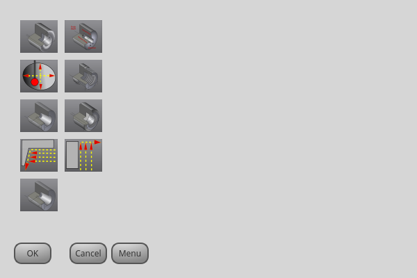

macroTabDialog_option -
Sets up the macro selection dialog.
macroTab_overlay_color -
macroTabdialog is shown. -
camViewDialog_option -
Sets up the camera alignment dialog.
camView_overlay_color -
camViewdialog is shown. -
toolOffset_option -
Sets up the tool offset display/editor dialog.
toolOffset_overlay_color -
toolOffsetdialog is shown. -

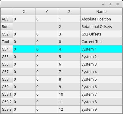

originOffset_option -
Sets up the origin display/editor dialog.
originOffset_overlay_color -
originOffsetdialog is shown. -
calculatorDialog_option -
Sets up the calculator entry dialog.
calculator_overlay_color -
Color of transparent layer shown when the calculator dialog is shown.

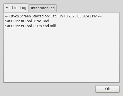

machineLogDialog_option -
Sets up a dialog to display logs from the machine and QtVCP.
machineLog_overlay_color -
machineLogdialog is shown. -
runFromLineDialog_option -
Sets up a dialog to display starting options when starting machine execution from a arbitrary line.
runFromLine_overlay_color -

The screen designer chooses the default settings of the screenOptions widget.
Once chosen, most won’t ever need to be changed. But if needed, some can be changed in the handler file or in stylesheets.
In the handler file:
Here we reference the widget by the Qt Designer user defined name:# rød, grønn, blå, alfa 0-255 color = QtGui.QColor(0, 255, 0, 191) self.w.screen_options.setProperty('close_overlay_color', color) self.w.screen_options.setProperty('play_sounds_option',False)
In style sheets:
Here we can reference the widget by Qt Designer user defined name or by widget class name./* red, green, blue 0-255, alpha 0-100% or 0.0 to 1.0 */ /* the # sign is used to refer to Qt Designer defined widget name */ /* matches/applied to only this named widget */ #screen_options { qproperty-close_overlay_color: rgba(0, 255, 0, 0.75) }
/* red, green, blue 0-255, alpha 0-100% or 0.0 to 1.0 */ /* use widget class name */ /* matches/applied to all widgets of this class */ ScreenOptions { qproperty-close_overlay_color: rgba(0, 255, 0, 0.75) }
Some settings are only checked on startup so will not cause changes after startup. In these cases you would need to make the changes in Qt Designer only.
If the preference file option is selected, screenOption widget will make an INI based preference file.
While other QtVCP widgets will add to this list, the screenOptions widget will add these entries under the following headings:

shutdown_check(bool) -
Whether to pop a confirmation dialog.

[SHUTDOWN_OPTIONS] -
shutdown_play_sound(bool) -
shutdown_alert_sound_type(str) -
Sound to play when messages displayed. See notes below.
shutdown_exit_sound_type(str) -
shutdown_msg_title(str) -
Short title string to display in dialog.
shutdown_msg_focus_text(str) -
Large text string to superimpose in focus layer.
shutdown_msg_detail(str) -
Longer descriptive string to display in dialog.

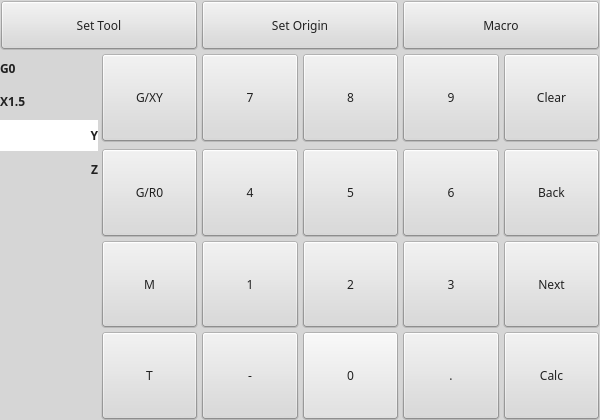

2.23. MDITouchy - Touch Screen MDI Entry Widget
This widget displays buttons and entry lines to use for entering MDI commands.
Based on LinuxCNC’s Touchy screen’s MDI entry process, its large buttons are most useful for touch screens.
To use MDITouchy:
First press one of the
G/XY,G/RO,MorTbutton. On the left will show the entry fields that can be filled out. -
Then press
NextandBackto navigate between fields. -
Calcwill pop up a calculator dialog. -
Clearclears the current entry. -
Set Toolwill call for a tool change. -
Set Originwill allow setting the origin of the current G6x system. -
Macrowill call any available macro ngc programs.
The widget requires an explicit call to MDITouchy Python code to actually run the MDI command:
For handler file code
If the widget was named mditouchy in Qt Designer, the command below would run the displayed MDI command:self.w.mditouchy.run_command()
For action button use
If the widget was named mditouchy in Qt Designer, use the action button’s Call Python commands option and enter:INSTANCE.mditouchy.run_command()
The macro button cycles though macros defined in the INI [DISPLAY] heading.
Add one or more MACRO lines of the following format:
MACRO = macro_name [param1] [... paramN]
In the example below, increment is the name of the macro, and it accepts two parameters, named xinc and yinc.
MACRO = incerment xinc yinc
Now, place the macro in a file named macro_name.ngc in the PROGRAM_PREFIX directory, or into any directory in the SUBROUTINE_PATH specified in the INI file.
Keeping on with the example above, it would be named increment.ngc and its content could look like:
O<increment> sub G91 G0 X#1 Y#2 G90 O<increment> endsub
Notice the name of the sub matches the file name and macro name exactly, including case.
When you invoke the macro by pressing the Macro button you can enter values for parameters (xinc and yinc in our example).
These are passed to the macro as positional parameters: #1, #2… #N respectively.
Parameters you leave empty are passed as value 0.
If there are several different macros, press the Macro button repeatedly to cycle through them.
In this simple example, if you enter -1 for xinc and invoke the running of the MDI cycle, a rapid G0 move will be invoked, moving one unit to the left.
This macro capability is useful for edge/hole probing and other setup tasks, as well as perhaps hole milling or other simple operations that can be done from the panel without requiring specially-written G-code programs.
2.24. OriginOffsetView - Origins View and Setting Widget
This widget allows one to visualize and modify User System Origin offsets directly.

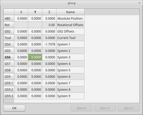

It will update LinuxCNC’s Parameter file for changes made or found.
The settings can only be changed in LinuxCNC after homing and when the motion controller is idle.
The display and entry will change between metric and imperial, based on LinuxCNC’s current G20 / G21 setting.
The current in-use user system will be highlighted.
Extra actions can be integrated to manipulate settings.
These actions depend on extra code added either to a combined widget, like originoffsetview dialog, or the screens handler code.
Typical actions might be Clear Current User offsets or Zero X.
Clicking on the columns and rows allows one to adjust the settings.
A dialog can be made to popup for data or text entry.
The comments section will be recorded in the preference file.
It is based on PyQt’s QTableView, QAbstractTableModel, and ItemEditorFactory.
Properties, functions and styles of the PyQt base objects are always available.
OriginOffsetView has the following properties:
dialog_code_string -
Sets which dialog will pop up with numerical entry.
test_dialog_code_string -
Sets which dialog will pop up with text entry.
metric_template -
Metric numerical data format.
imperial_template -
Imperial numerical data format.
styleCodeHighlight -
Current in-use user system highlight color.
These can be set in:
Qt Designer, in
Python handler code
self.w.originoffsetview.setProperty('dialog_code','CALCULATOR') self.w.originoffsetview.setProperty('metric_template','%10.3f')
Or (if appropriate) in stylesheets
OriginOffsetView{ qproperty-styleColorHighlist: lightblue; }

2.28. StatusImageSwitcher - Controller Status Image Switching Widget
This widget will display images based on LinuxCNC status.
You can watch:
the state of the spindle,
the state of all homed,
the state of a certain axis homed,
the state of hard limits.
It is based on PyQt’s FIXME
2.29. FileManager - File Loading Selector Widget
This widget is used to select files to load.
It has a the ability to scroll the names with hardware such as a MPG.
One can class patch the function load(self,fname) to customize file loading.
The function getCurrentSelected() will return a Python tuple, containing the file path and whether it is a file.
temp = FILEMANAGER.getCurrentSelected() print('filepath={}'.format(temp[0])) if temp[1]: print('Is a file')
doubleClickSelection(bool) -
Determines whether or not to require double clicking on a folder.
Single clicking a folder (False) is enabled by default and is intended for touch screen users.
The following shows an example of how to set this property:#filemanager { qproperty-doubleClickSelection: True; }
showListView(bool) -
Determines whether or not to show the file/folder structure in list form.
Table view (False) is enabled by default.
The following shows an example of how to set this property:#filemanager { qproperty-showListView: True; }

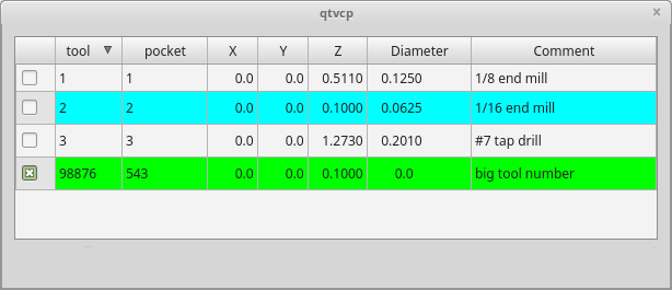

2.31. ToolOffsetView - Tools Offsets View And Edit Widget
This widget displays and allows one to modify tools offsets.
It will update LinuxCNC’s tool table for changes made or found.
The tool settings can only be changed in LinuxCNC after homing and when the motion controller is idle.
The display and entry will change between metric and imperial based on LinuxCNC’s current G20/G21 setting.
The current in-use tool will be highlighted, and the current selected tool will be highlighted in a different color.
The checkbox beside each tool can be used to select too for an action that depends on extra code added either to a combined widget, like the toolOffsetView dialog or the screens handler code.
Typical actions are load selected tool, delete selected tools, etc.
The comments section will typically be displayed in the manual tool change dialog.
If using a lathe configuration, there can be columns for X and Z wear.
To use these columns to adjust the tool wear, it requires a remapped tool change routine.
ToolOffsetView has properties that can be set in Qt Designer, in Python handler code or (if appropriate) in stylesheets:
metric_template -
imperial_template -
Current tool-in-use highlight color.
styleCodeSelected -
Selected highlight color.
In a handler file:
self.w.tooloffsetview.setProperty('dialog_code','CALCULATOR') self.w.tooloffsetview.setProperty('metric_template','%10.3f')
and in style sheets:
ToolOffsetView{ qproperty-styleColorHighlist: lightblue; qproperty-styleColorSelected: #444; }
ToolOffsetView has some functions useful for screen builders to add actions:
add_tool() -
Adds a blank dummy tool (99) that the user can edit to suit.
delete_tools() -
Deletes the currently checkbox selected tools.
get_checked_list() -
Returns a list of tools selected by checkboxs.
set_all_unchecked() -
Uncheck all selected tools.
self.w.tooloffsetview.add_tool() self.w.tooloffsetview.delete_tools() toolList = self.w.tooloffsetview.get_checked_list() self.w.tooloffsetview.set_all_unchecked()

3.3. FileDialog - Load and Save File Chooser Dialog Widget
This is used to load G-code files.
If there is a Focus Overlay widget present, it will signal it to display.
When using STATUS 's request-dialog function, the default launch names are LOAD or SAVE.
There are options that can be set when requesting a dialog, these would be added to the message dict:
EXTENSIONS -
FILENAME -
DIRECTORY -
An example Python call, for a load dialog:
mess = {'NAME':'LOAD','ID':'_MY_DIALOG_', 'TITLE':'Load Some text File', 'FILENAME':'~/linuxcnc/nc_files/someprogram.txt', 'EXTENSIONS':'Text Files (*.txt);;ALL Files (*.*)' } ACTION.CALL_DIALOG(mess)
And for a save dialog
mess = {'NAME':'SAVE','ID':'_MY_DIALOG_', 'TITLE':'Save Some text File', 'FILENAME':'~/linuxcnc/nc_files/someprogram.txt', 'EXTENSIONS':'Text Files (*.txt);;ALL Files (*.*)' } ACTION.CALL_DIALOG(mess)
It is based on PyQt’s QMessagebox.
3.4. OriginOffsetDialog - Origin Offset Setting Dialog Widget
This widget allows one to modify User System origin offsets directly in a dialog form.
If there is an Focus Overlay widget present, it will signal it to display.
When using STATUS 's request-dialog function, the default launch name is ORIGINOFFSET.
It is based on PyQt’s QDialog.

3.6. MacroTabDialog - Macro Launch Dialog Widget
This is a dialog to display the macrotab widget.
MacroTab displays a choice of macro programs to run using icons.
When using ``STATUS``'s request-dialog function, the default launch name is MACROTAB.

3.9. CalculatorDialog - Calculator Dialog Widget
This is a dialog to display a calculator for numeric entry, such as origin offset.
It returns the entry via STATUS messages using a Python DICT.
The DICT contains at minimum, the name of the dialog requested and an ID code.
When using ``STATUS``'s request-dialog function, the default launch name is CALCULATOR.

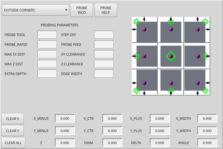

3.11. VersaProbeDialog - Part Touch Probing Dialog Widget
This is a dialog to display a part probing screen based on Verser Probe v2.
3.12. MachineLogDialog - Machine and Debugging Logs Dialog Widget
This is a dialog to display the machine log and QtVCP’s debugging log.

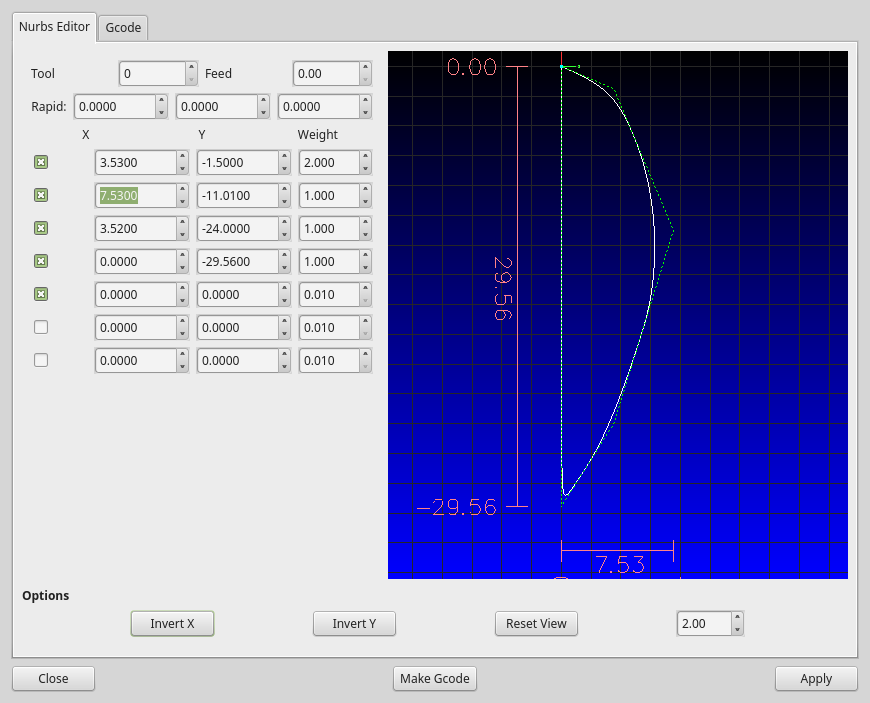

4.1. NurbsEditor - NURBS Editing Widget
The Nurbs editor allows you to manipulate a NURBS based geometry on screen and then convert NURBS to G-code.
You can edit the G-code on screen and then send it to LinuxCNC.
