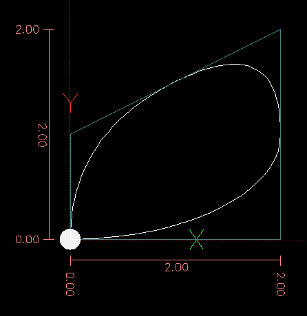

G5 Sample subsequent cubic spline
G5 P0 Q-3 X2 Y2
It is an error if:
  • P and Q are not both specified.
  • Just one of I or J are specified.
  • I or J are unspecified in the first of a series of G5 commands.
  • An axis other than X or Y is specified.
  • The active plane is not G17.

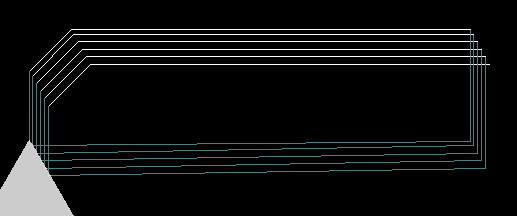

The G70 cycle is intended to be used after the shape of the profile given in the subroutine with number Q has been cut with G71 or G72.
  • Preliminary motion.
    • If Z or X are used a rapid move to that position is done. This position is also used between each finishing pass.
    • Then a rapid move to the start of the profile is executed.
    • The path given in Q- is followed using the G1 and [gcode:g2-g3] commands.
    • If a next pass is required there is another rapid to the intermediate location, before a rapid is done to the start of the profile.
    • After the final pass, the tool is left at the end of the profile including E-.
  • Multiple passes. The distance between the pass and the final profile is (pass-1)*(D-E)/P+E. Where pass the pass number and D,E and P are the D/E/P numbers.
  • The distance is computed using the starting position of the cycle, with a positive distance towards this point.
  • Fillet and chamfers in the profile. It is possible to add fillets or chamfers in the profile, see [gcode:g71-g72] for more details.
