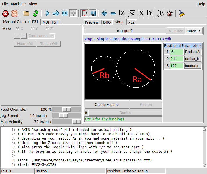

The simplest application is found as:
Sample Configurations/sim/axis/ngcgui/ngcgui_simple

ngcgui.ngc - An easy to understand example using subroutines

simp.ngc - a simple subroutine example that creates two circles

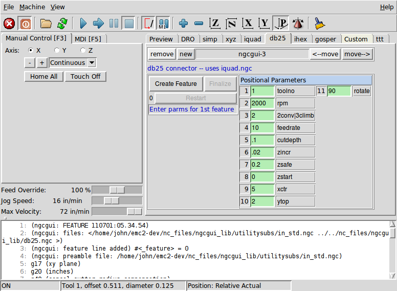

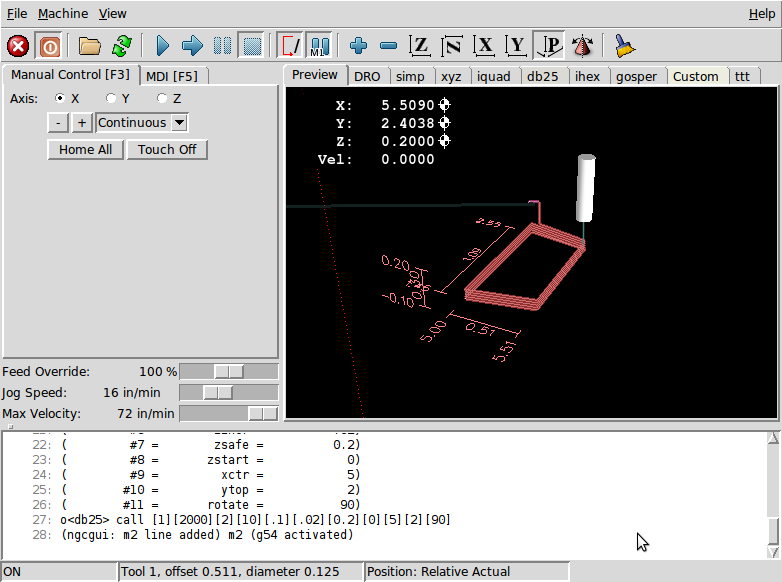

To try a demonstration, select a sim configuration and start the LinuxCNC program.
If using the AXIS GUI, press the E-Stop
then Machine Power
then Home All. Pick a NGCGUI tab, fill in
any empty blanks with sensible values and press
Create Feature then Finalize. Finally press the Run
button to watch it run. Experiment
by creating multiple features and features from different tab pages.

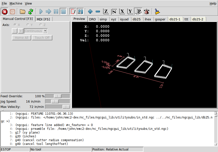

To create several subroutines concatenated into a single file, go to each tab fill in the blanks, press Create Feature then using the arrow keys move any tabs needed to put them in order. Now press Finalize and answer the prompt to create
Other GUIs will have similar functionality but the buttons and names may be different.

7. DB25 Example
The following shows the DB25 subroutine. In the first photo you see where you fill in the blanks for each variable.
This photo shows the backplot of the DB25 subroutine.
This photo shows the use of the new button and the custom tab to create three DB25 cutouts in one program.

Comments and presets may be included.
(info: simp -- simple exemple de sous-programme -- Ctrl-U pour éditer)
o<simp> sub
#<ra> = #1 (=.6 Rayon A) ;Example de paramètre avec un commentaire
#<radius_b> = #2 (=0.4) ;Example de paramètre sans commentaire
#<feedrate> = #3 (Feedrate) ;Example de paramètre sans preset
g0x0y0z1
g3 i#<ra> f#<feedrate>
g3 i[0-#<radius_b>]
o<simp> endsub
