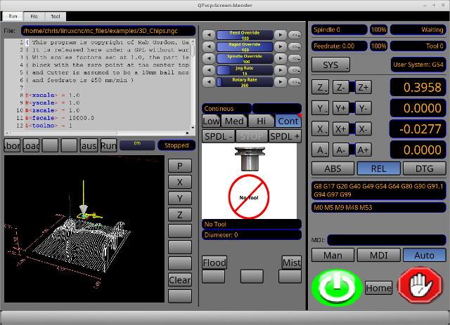

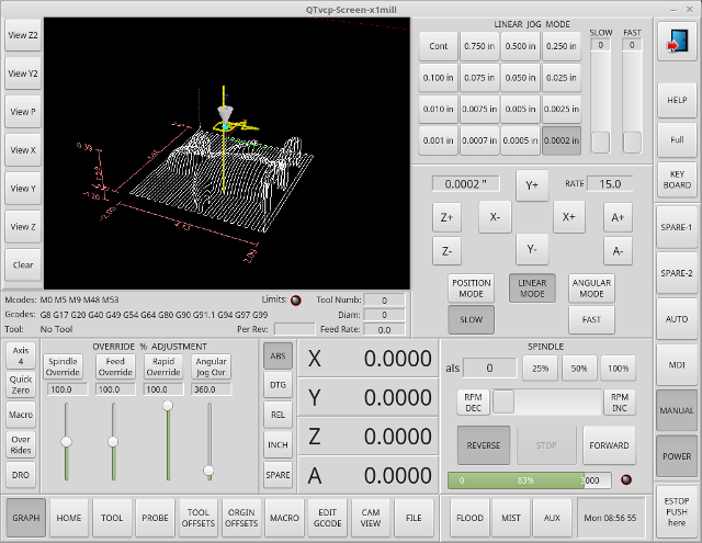

![QTDragon Router](images/silverdragon.png)

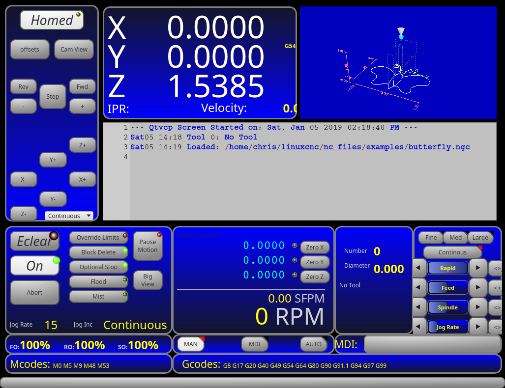

![QTscreen Mill](images/qt_cnc.png)
![QTscreen Qtaxis](images/qtaxis.png)
![QTscreen Blender](images/blender.png)
![QTscreen x1mill](images/x1mill.png)

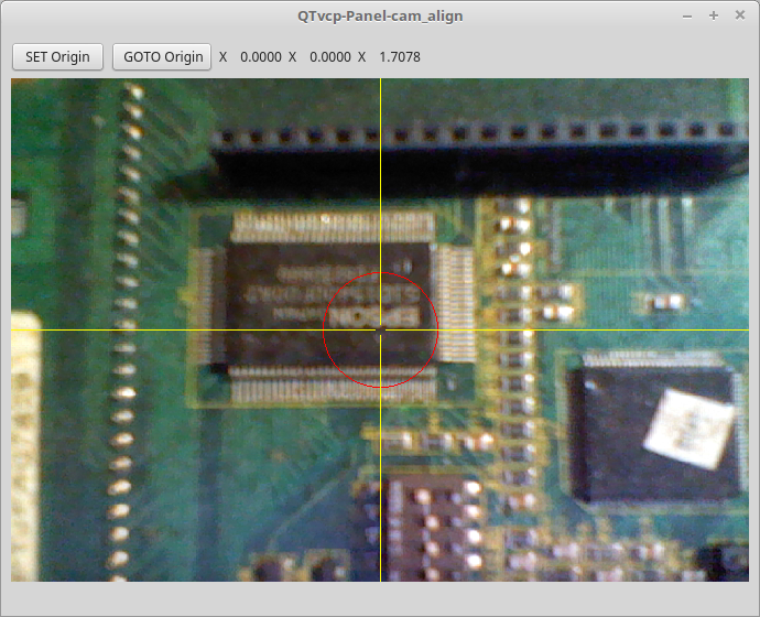

![QTscreen x1mill](images/qtvcp-cam-align.png)

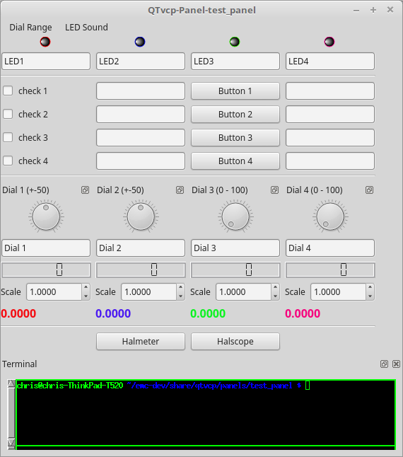

![Test Panel](images/test_panel.png)

1.3. QTDesigner UI File
A designer file is a text file organized in the XML standard that describes the
layout and the widgets of the screen. Pyqt5 uses this file to build the display
and react to those widgets. The QTDesigner editor makes it relatively easy to build
and edit this file.

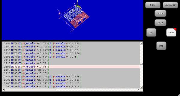

Drag and drop a GCodeGraphics widget and a GcodeEditor widget.
Place and resize them as you see fit leaving some room for buttons.
Now we will add action buttons.
Add 7 action buttons on to the main window. If you double click the button, you
can add text. Edit the button labels for Estop, Machine On, Home, Load,
Run, Pause and stop.

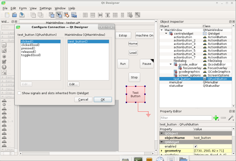

Action buttons default to no action so we must change the properties for defined functions.
You can edit the properties directly in the property editor on the right side of designer.
A convenient alternating is left double clicking on the button This will launch a Dialog
that allows selecting actions while only display relevant data to the action.
We will describe the convenient way first:
Right click the Machine On button and select Set Actions. When the Dialog displays,
use the combobox to navigate to MACHINE CONTROLS - Machine On. In this case there there
is no option for this action so select ok. Now the button will turn the machine on when pressed

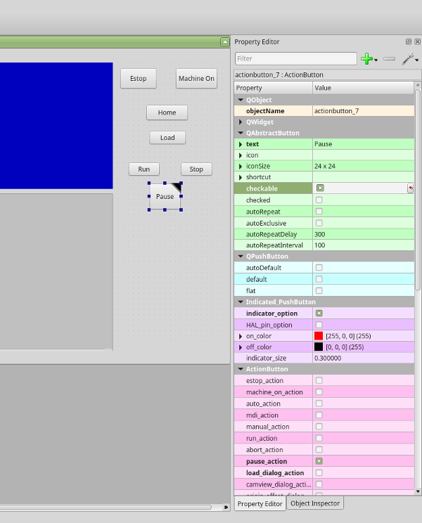

And now the direct way with Designer’s property editor
Select the Machine On button. Now go to the Property Editor on the right
side of Designer. Scroll down until you find the ActionButton heading.
You will see a list of properties and values. find the machine on action and
click the checkbox. the button will now control machine on/off.
Do the same for all the other button with the addition of:
With the Home button we must also change the joint_number property to -1,
Which tells the controller to home all the axes rather then a specific axis.
With the Pause button under the heading Indicated_PushButton check the
indicator_option and under the QAbstactButton heading check checkable
![designer button property](images/designer_button_property.png)

4.2. Using Designer to add slots
When you have loaded your screen into designer add a plain PushButton to the screen.
You could change the name of the button to something interesting like test_button
There are two ways to edit connections - This is the graphical way
There is a button in the top tool bar of designer for editing signals.
After pushing it, if you click-and-hold on the button it will show a arrow
(looks like a ground signal from electrical schematic)
Slide this arrow to a part of the main window that does not have widgets on it.
A Configure Connections dialog will pop up.
The list on the left are the available signals from the widget.
The list on the right is the available slots on the main window and you can add to it.
Pick the signal clicked() - this makes the slots side available.
click edit on the slots list.
A Slots/Signals of MainWindow dialog will pop up.
On the slots list at the top there is a plus icon - click it.
you can now edit a new slot name.
Erase the default name slot() and change it to test_button()
press the ok button.
You’ll be back to the Configure Connections dialog.
now you can select your new slot in the slot list.
then press ok and save the file.
