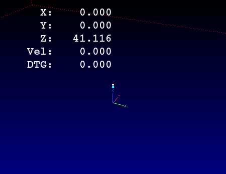

2.8. GCodeGraphics Widget
![QTvcp Gcode Graphics](images/qtvcp_gcodeGraphics.png)
This Displays the current Gcode in a graphical form.
_view _dro _dtg _metric overlay _offsets background_color
2.8.1. ACTION functions
The ACTION library can control the gcode graphics widget.
ACTION.RELOAD_DISPLAY() -reload the current program which recalculates the origin/offsets.
ACTION.SET_GRAPHICS_VIEW(view) The following commands can be sent:
clear
zoom-in
zoom-out
pan-up
pan-down
pan-right
pan-left
rotate-cw
rotate-ccw
rotate-up
rotate-down
overlay-dro-on
overlay-dro-off
overlay-offsets-on
overlay-offsets-off
alpha-mode-on
alpha-mode-off
inhibit-selection-on
inhibit-selection-off
dimensions-on
dimensions-off
grid-size
P
X
Y
Y2
Z
Z2
ACTION.ADJUST_PAN(X,Y) -directly set the relative pan of view in x and y direction
ACTION.ADJUST_ROTATE(X,Y) -directly set the relative rotation of view in x and y direction
It is based on pyQT’s opengl widget.

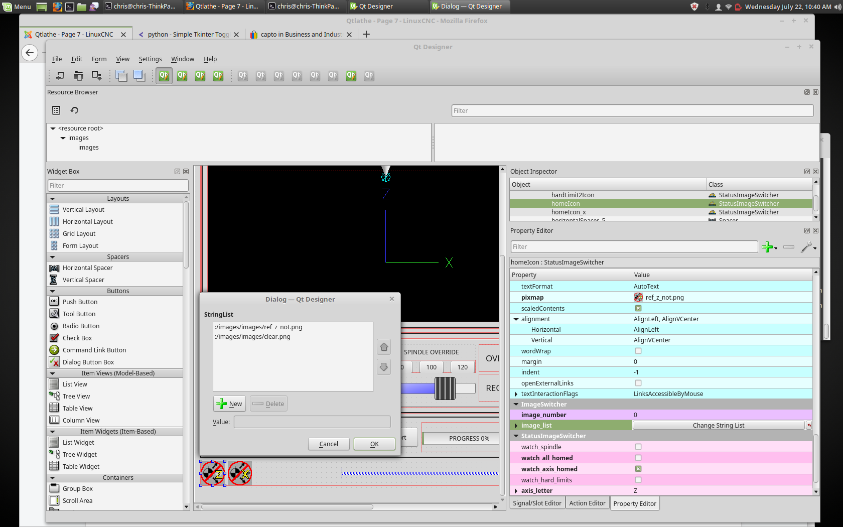

Here is an example of using it to display an icon of Z axis homing state:
![QTvcp Status Image Switcher](images/statusImageSwitcher.png)
In the properties section notice that:
watch axis homed is checked
axis letter is set to Z
If you double click the image list a dialog will show and allow you to add image paths to.
If you have one image as an icon and one clear image then that will look like it shows and hides the icon.
Selecting image paths can be done by selecting the pixmap property and selecting an image.
Note: The pixmap setting is for test display only and will be ignored outside of Designer.
Right click the image name and you should see copy path
Click copy path
Now double click the image list property so the dialog shows.
Click the New button
Paste the image path in the entry box
Do that again for the next image - use a clear image to represent a hidden icon.
You can test display the images from the image list by changing the image number
In this case 0 is unhomed 1 would be homed
This is for test display only and will be ignored outside of Designer.

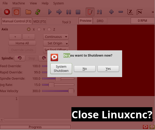

closeDialog_option: sets up the standard close screen prompt dialog

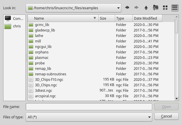

fileDialog_option: sets up the file choosing dialog.

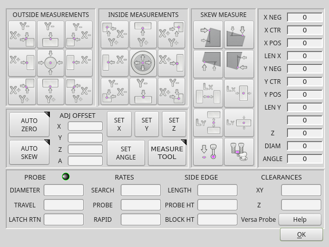

vesaProbe_option: sets up the vera style probe dialog

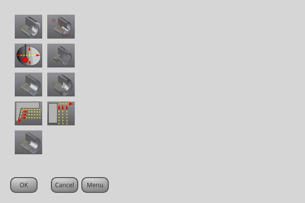

macroTabeDialog_option: sets up the macro selection dialog

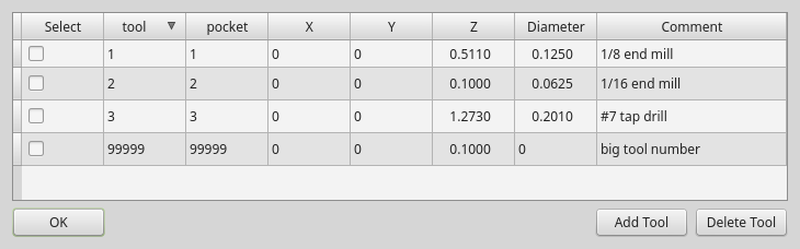

toolOffset_option: sets up the tool offset display/editor dialog

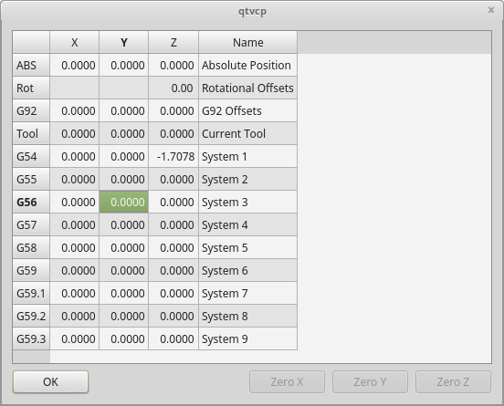

originOffset_option: sets up the origin display/editor dialog

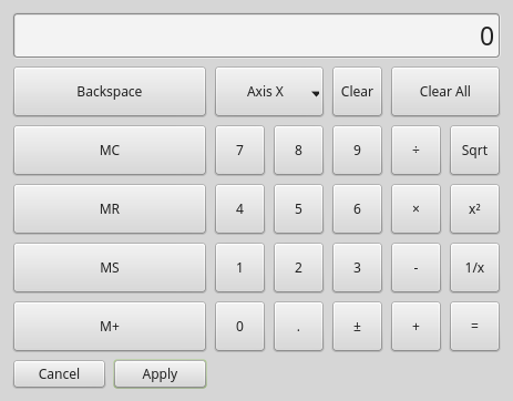

calculatorDialog_option: sets up the calcylatory entry dialog

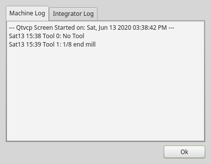

machineLogDialog_option: sets up a dialog to display logs from the machine and qtvcp

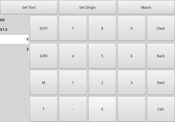

2.22. MDITouchy
![QTvcp MDI Touchy](images/qtvcp_mdiTouchy.png)
This widget display button and entry lines for use with entering MDI commands.
It is based on Linuxcnc’s Touchy screen’s MDI entry process.
It’s large buttons are most useful for touch screens.
To use MDITouchy, first press one of the G/XY, G/RO, M or T button.
On the left, will show the current line that can be filled out, then press Next for the next line.
Calc will pop up a calculator dialog.
Clear clears th ecurrent entry.
Back allows you to change previous line entries.
The widget requires an explicied call to MDITouchu’s python code to actually run the MDI command
For handler file code: if the widget was named mditouchy in designer, this command would
run the displayed MDI command.
self.w.mditouchy.run_command()
For action button use: if the widget was named mditouchy in designer,
use the action button’s Call python commands option and enter:
INSTANCE.mditouchy.run_command()
The macro button will cycle though macro’s defined in the INI heading [DISPLAY]
add one or more 'MACRO = ' lines. Each should be of the format:
MACRO = increment xinc yinc
In this example, increment is the name of the macro, and it accepts two parameters, named xinc and yinc.
Now, place the macro in a file named increment.ngc, in the
PROGRAM_PREFIX directory or any directory in the SUBROUTINE_PATH.
(specified in the INI file)
It should look like:
O<increment> sub
G91 G0 X#1 Y#2
G90
O<increment> endsub
Notice the name of the sub matches the file name and macro name exactly,
including case.
When you invoke the macro by pressing the Macro button
you can enter values for xinc and yinc. These are
passed to the macro as #1 and #2 respectively. Parameters you
leave empty are passed as value 0.
If there are several different macros, press the Macro button
repeatedly to cycle through them.
In this simple example, if you enter -1 for xinc and invoke the running of the
MDI cycle, a rapid G0 move will be invoked, moving one unit to
the left.
This macro capability is useful for edge/hole probing and other setup
tasks, as well as perhaps hole milling or other simple operations
that can be done from the panel without requiring specially-written
gcode programs.
2.23. OriginOffsetView Widget
This widget allows one to modify User System origin offsets directly
It will update the table for changes made internally by linuxcnc.

2.25. MachineLog

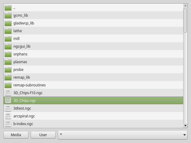

This widget is used to select files to load.
It has a the ability to scroll the names with hardware such as a MPG.
one can class patch the function load(self,fname): to customize file loading.
the function getCurrentSelected() will return a python touple, containing
the file path and whether it’s a file.
temp = FILEMANAGER.getCurrentSelected() print 'filepath={}'.fomat(temp[0]) if temp[1]: print 'Is a file'

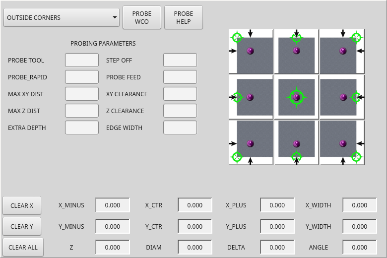

2.30. BasicProbe
![QTvcp basicProbe widget](images/qtvcp_basicProbe.png)
Widget for probing on a mill.
requires extra analog motion pins for probe settings.

3.3. Dialog File Chooser Widget
![QTvcp file dialog](images/qtvcp_fileDialog.png)
This is used to load Gcode files
If there is a Focus Overlay widget present, it will signal it to display.
When using STATUS’s request-dialog function, the default launch names are LOAD or SAVE
There are options that can be set when requesting a dialog, these would be added to
the message dict.
EXTENSIONS
FILENAME
DIRECTORY
An example python call, for a load dialog:
mess = {'NAME':'LOAD','ID':'_MY_DIALOG_', 'TITLE':'Load Some text File', 'FILENAME':'~/linuxcnc/nc_files/someprogram.txt', 'EXTENSIONS':'Text Files (*.txt);;ALL Files (*.*)' } ACTION.CALL_DIALOG(mess)
And for saving
mess = {'NAME':'SAVE','ID':'_MY_DIALOG_', 'TITLE':'Save Some text File', 'FILENAME':'~/linuxcnc/nc_files/someprogram.txt', 'EXTENSIONS':'Text Files (*.txt);;ALL Files (*.*)' } ACTION.CALL_DIALOG(mess)
It is based on pyQT’s QMessagebox
3.4. Dialog Origin Offset Widget
![QTvcp origin Offset Page](images/qtvcp_offsetpage.png)
It is in a dialog form
If there is an Focus Overlay widget present, it will signal it to display.
When using STATUS’s request-dialog function, the default launch name is ORIGINOFFSET
It is based on pyQT’s QDialog
3.5. Dialog tool Offset Widget
![QTvcp Tool Offset Page](images/qtvcp_toolOffset.png)
This widget allows one to modify Tool offsets directly
When using STATUS’s request-dialog function, the default launch name is TOOLOFFSET
3.6. Dialog MacroTab
This is a dialog for displaying the macrotab widget.
Macrotab displays a choice of macro programs to run using icons.
When using STATUS’s request-dialog function, the default launch name is MACROTAB

3.9. Dialog Calculator
![QTvcp Calculator](images/qtvcp_calculator.png)
This is a dialog to display a calculator for numeric entry, such as origin offset.
It returns the entry via STATUS messages using a python DICT.
The DICT contains at minimum, the name of the dialog requested and an id code.
When using STATUS’s request-dialog function, the default launch name is CALCULATOR

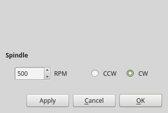

3.10. Dialog Run From Line
![QTvcp Run-from-line](images/qtvcp_runFromLine.png)
Dialog to preset spindle settings before running a program from a specific line.
3.11. Dialog VersaProbe
![QTvcp Versa Probe](images/qtvcp_versaProbe.png)
This is a dialog to display A probing screen based on Versa Probe.
