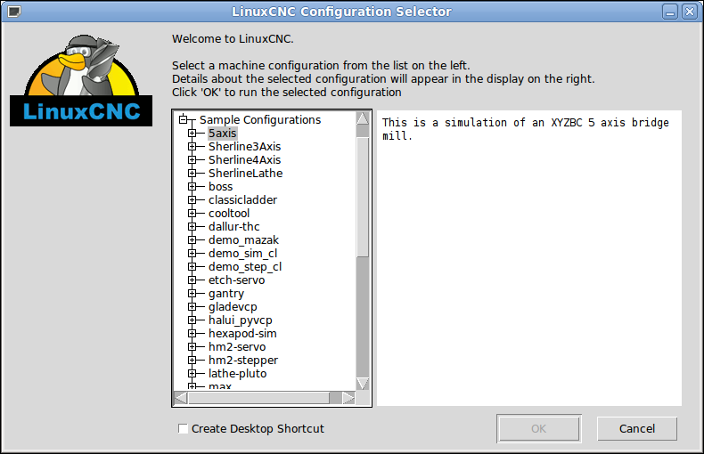

LinuxCNC配置选择器
Figure 1. LinuxCNC Configuration Selector
Click any of the listed configurations to display specific information about it. Double-click a configuration or click OK to start the configuration. Select Create Desktop Shortcut and then click OK to add an icon on the Ubuntu desktop to directly launch this configuration without showing the Configuration Selector screen. 单击任何列出的配置以显示有关它的特定信息。 双击配置或单击“确定”以启动配置。 选择“创建桌面快捷方式”, 然后单击“确定”在Ubuntu桌面上添加图标以直接启动此配置, 而不显示“配置选择器”屏幕。
When you select a configuration from the Sample Configurations section, it will automaticly place a copy of that config in the linuxcnc/configs directory. 当从“示例配置”选择配置时,它将自动将该配置的副本放置在linuxcnc/configs目录下。
