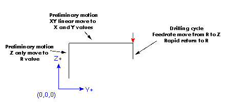

Example 1 - Absolute Position G81
Suppose the current position is (X1, Y2, Z3) and the following line of NC code is interpreted.
G90 G98 G81 X4 Y5 Z1.5 R2.8
This calls for absolute distance mode (G90) and OLD_Z retract mode (G98) and calls for the G81 drilling cycle to be performed once.
The X value and X position are 4.
The Y value and Y position are 5.
The Z value and Z position are 1.5.
The R value and clear Z are 2.8. OLD_Z is 3.
The following moves take place:
  1. a rapid move parallel to the XY plane to (X4, Y5)
  2. a rapid move move parallel to the Z-axis to (Z2.8).
  3. move parallel to the Z-axis at the feed rate to (Z1.5)
  4. a rapid move parallel to the Z-axis to (Z3)
images/G81ex1.png

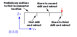

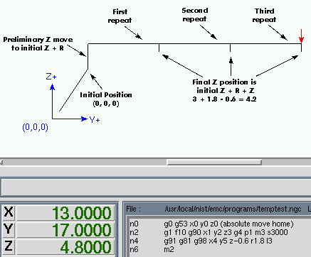

Example 2 - Relative Position G81
G91 G98 G81 X4 Y5 Z-0.6 R1.8 L3
This calls for incremental distance mode (G91) and OLD_Z retract mode (G98). It also calls for the G81 drilling cycle to be repeated three times. The X value is 4, the Y value is 5, the Z value is -0.6 and the R value is 1.8. The initial X position is 5 (=1+4), the initial Y position is 7 (=2+5), the clear Z position is 4.8 (=1.8+3), and the Z position is 4.2 (=4.8-0.6). OLD_Z is 3.
The first preliminary move is a maximum rapid move along the Z axis to (X1,Y2,Z4.8), since OLD_Z < clear Z.
The first repeat consists of 3 moves.
  1. a rapid move parallel to the XY-plane to (X5, Y7)
  2. move parallel to the Z-axis at the feed rate to (Z4.2)
  3. a rapid move parallel to the Z-axis to (X5, Y7, Z4.8)
The second repeat consists of 3 moves. The X position is reset to 9 (=5+4) and the Y position to 12 (=7+5).
  1. a rapid move parallel to the XY-plane to (X9, Y12, Z4.8)
  2. move parallel to the Z-axis at the feed rate to (X9, Y12, Z4.2)
  3. a rapid move parallel to the Z-axis to (X9, Y12, Z4.8)
The third repeat consists of 3 moves. The X position is reset to 13 (=9+4) and the Y position to 17 (=12+5).
  1. a rapid move parallel to the XY-plane to (X13, Y17, Z4.8)
  2. move parallel to the Z-axis at the feed rate to (X13, Y17, Z4.2)
  3. a rapid move parallel to the Z-axis to (X13, Y17, Z4.8)
images/G81ex2.png
Example 3 - Relative Position G81
Now suppose that you execute the first G81 block of code but from (X0, Y0, Z0) rather than from (X1, Y2, Z3).
Since OLD_Z is below the R value, it adds nothing for the motion but since the initial value of Z is less than the value specified in R, there will be an initial Z move during the preliminary moves.
images/G81.png
Example 4 - Absolute G81 R > Z
This is a plot of the path of motion for the second g81 block of code.
Since this plot starts with (X0, Y0, Z0), the interpreter adds the initial Z0 and R1.8 and rapid moves to that location. After that initial Z move, the repeat feature works the same as it did in example 3 with the final Z depth being 0.6 below the R value.
images/G81a.png
