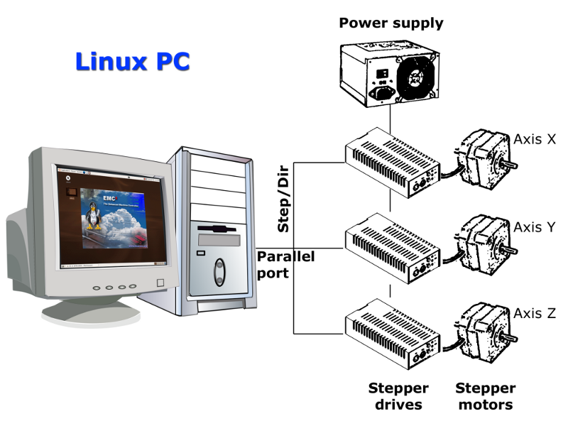

The below illustration is a simple block diagram showing what a typical 3-axis CNC mill with stepper motors might look like:
![Simple LinuxCNC Controlled Machine](images/whatstep1.png)
A computer running LinuxCNC sends a sequence of pulses via the parallel port to the stepper drives, each of which has one stepper motor connected to it. Each drive receives two independent signals; one signal to command the drive to move its associated stepper motor in a clockwise or anti-clockwise direction, and a second signal that defines the speed at which that stepper motor rotates.
While a stepper motor system under parallel port control is illustrated, a LinuxCNC system can also take advantage of a wide variety of dedicated hardware motion control interfaces for increased speed and I/O capabilities. A full list of interfaces supported by LinuxCNC can be found on the Supported Hardware page of the Wiki.

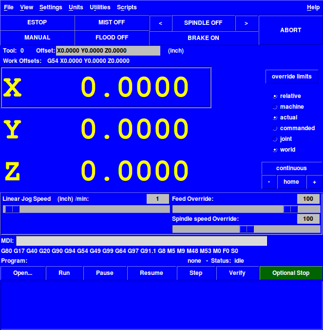

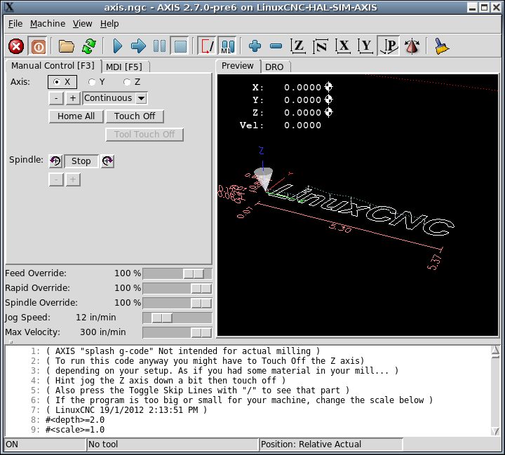

- AXIS
AXIS, the standard keyboard GUI interface. This is also the default GUI launched when a Configuration Wizard is used to create a desktop icon launcher:
![AXIS, the standard keyboard GUI interface](../gui/images/axis.png)

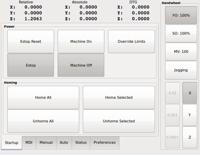

- Touchy
Touchy, a touch screens GUI:
![Touchy, a touch screen GUI](../gui/images/touchy.png)

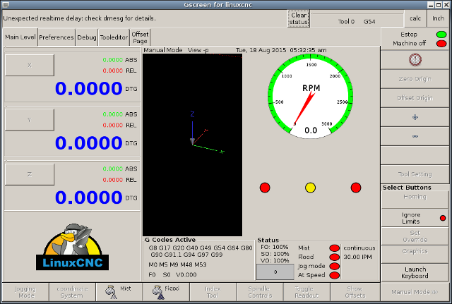

- Gscreen
Gscreen, a user-configurable touch screen GUI:
![Gscreen, a configurable base touch screen GUI](../gui/images/gscreen-mill.png)

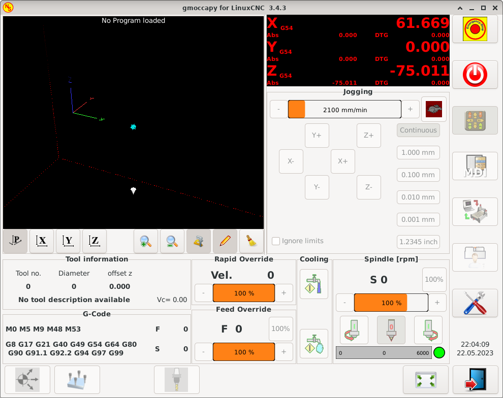

- GMOCCAPY
GMOCCAPY, a touch screen GUI based on Gscreen. GMOCCAPY is also designed to work equally well in applications where a keyboard and mouse are the preferred methods of controlling the GUI:
![GMOCCAPY, a touch screen GUI based on Gscreen](../gui/images/gmoccapy_3_axis.png)

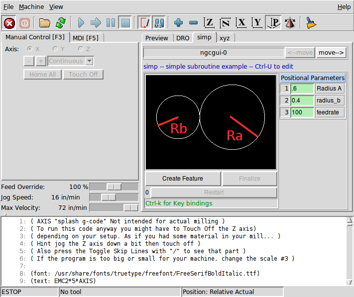

- NGCGUI
NGCGUI, a subroutine GUI that provides wizard-style programming of G code. NGCGUI may be run as a standalone program or embedded into another GUI as a series of tabs. The following screenshot shows NGCGUI embedded into AXIS:
![NGCGUI, a graphical interface integrated into AXIS](../gui/images/ngcgui.png)

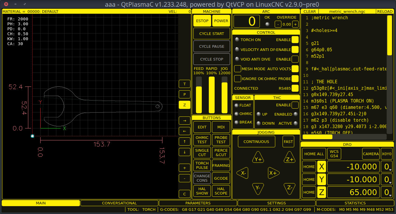

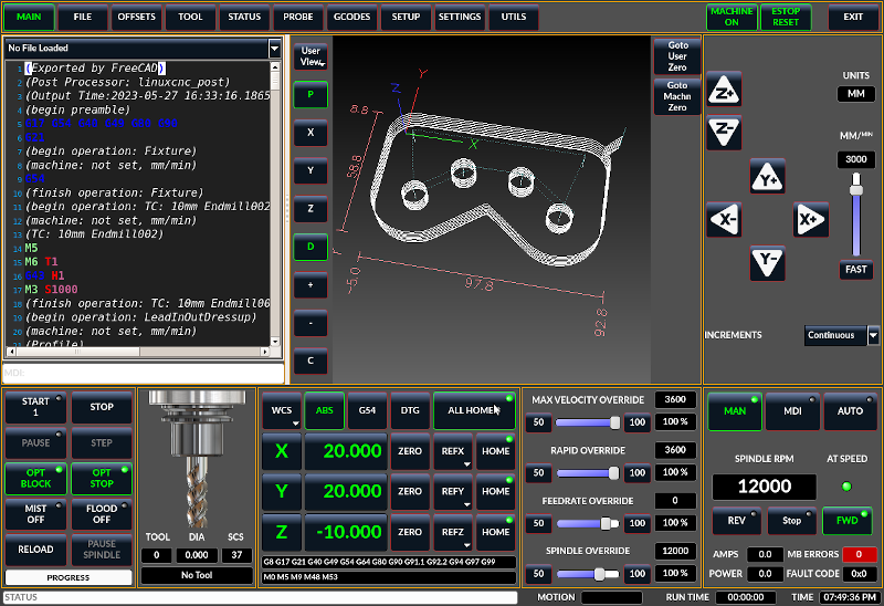

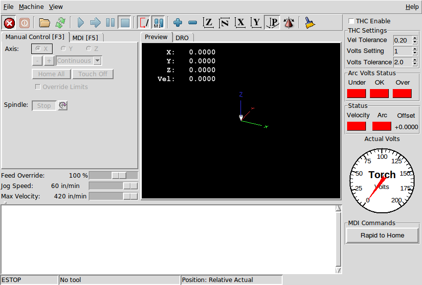

- QtPlasmaC
QtPlasmaC, a touch screen plasma cutting GUI based on QtVCP using the PyQt5 library. It comes in three aspect ratios, 16:9, 4:3, and 9:16.
![QtPlasmaC, a touch screen plasma cutting GUI based on QtVCP](../plasma/images/qtplasmac_16x9.png)

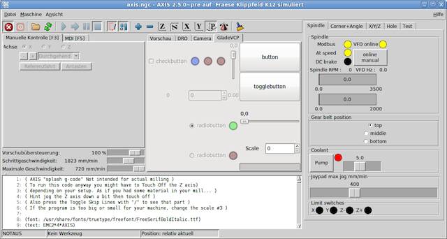

- GladeVCP
GladeVCP, a Glade-based virtual control panel that can be added to the AXIS or Touchy GUIs. GladeVCP has the advantage over PyVCP in that it is not limited to the display or control of HAL virtual signals, but can include other external interfaces outside LinuxCNC such as window or network events. GladeVCP is also more flexible in how it may be configured to appear on the GUI:
![GladeVCP embedded into AXIS](../gui/images/axis-gladevcp.png)

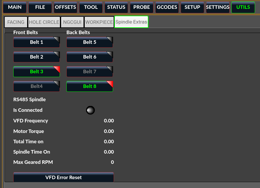

- QtVCP
QtVCP, a PyQt5-based virtual control panel that can be added to most GUIs or run as a standalone panel. QtVCP has the advantage over PyVCP in that it is not limited to the display or control of HAL virtual signals, but can include other external interfaces outside LinuxCNC such as window or network events by extending with python code. QtVCP is also more flexible in how it may be configured to appear on the GUI with many special widgets:
![QtVCP panel embedded into QtDragon](../gui/images/qtvcp_spindle_belts.png)
