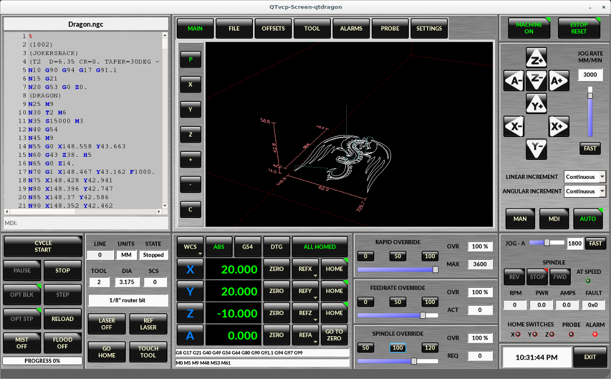

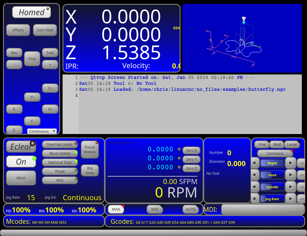

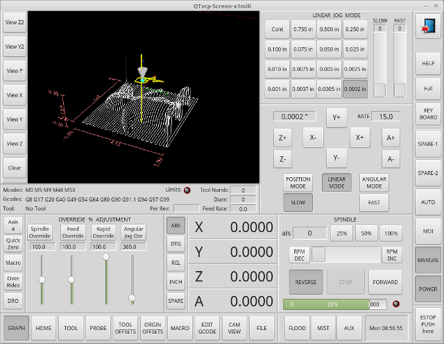

1. Showcase
Few examples of QtVCP built screens and virtual control panels:
![QtDragon Router](images/silverdragon.png)
![Qtscreen Mill](images/qt_cnc.png)
![Qtscreen QtAxis](images/qtaxis.png)

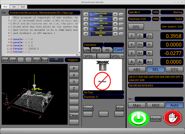

![Qtscreen Blender](images/blender.png)
![Qtscreen x1mill](images/x1mill.png)
![Qtscreen x1mill](images/qtvcp-cam-align.png)
![Test Panel](images/test_panel.png)

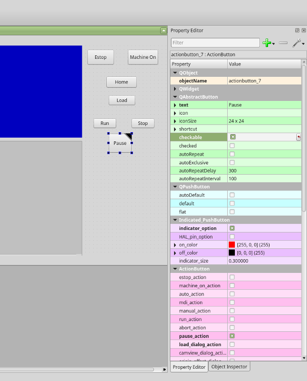

2.3. Qt Designer UI File
A Qt Designer file is a text file organized in the XML standard that describes the layout and widgets of the screen.
PyQt5 uses this file to build the display and react to those widgets.
The Qt Designer editor makes it relatively easy to build and edit this file.

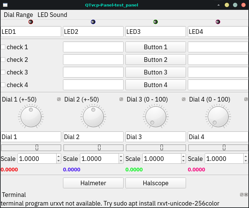

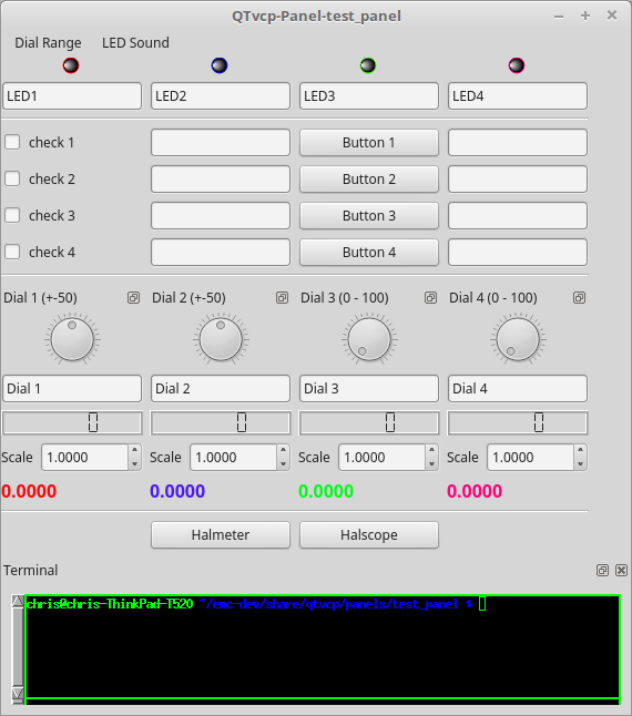

test_panel
Collection of useful widgets for testing HAL components, including speech of LED state.
Figure 8. QtVCP HAL Test Builtin Panel -

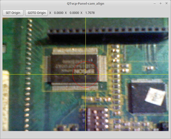

cam_align
A camera display widget for rotational alignment.
Figure 9. cam_align - Camera Alignment VCP -

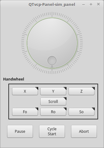

sim_panel
A small control panel to simulate MPG jogging controls etc.
For simulated configurations.Figure 10. QtVCP Sim Builtin Panel -

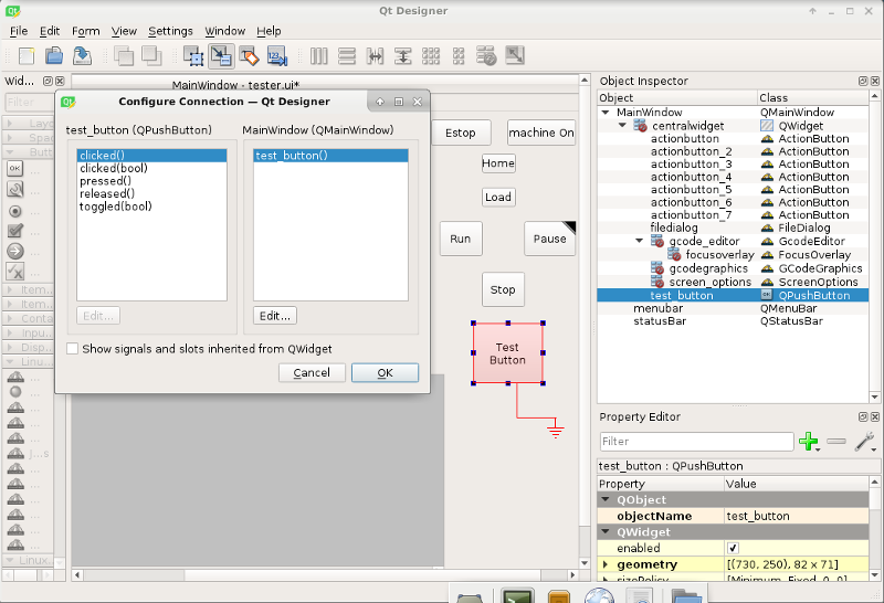

4. Build A Simple Clean-sheet Custom Screen
![QtVCP Ugly custom screen](images/qtvcp_tester.png)
4.1. Overview
To build a panel or screen:
Use Qt Designer to build a design you like and save it to your configuration folder with a name of your choice, ending with

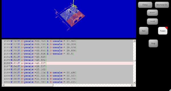

4.3. Build The Screen .ui
File
MainWindow
WidgetWhen Qt Designer is first started there is a 'New Form' dialog displayed.
Pick 'Main Window' and press the 'Create' button.
A MainWindow
widget is displayed.
We are going to make this window a specific non resizeable size:
MainWindow
Minimum and Maximum Size-
Grab the corner of the window and resize to an appropriate size, say 1000x600.
Right click on the window and click set minimum size.
Do it again and set maximum size.
Our sample widget will now not be resizable.
ScreenOptions
WidgetDrag and drop the ScreenOptions
widget anywhere onto the main window.
This widget doesn’t add anything visually but sets up some common options.
It’s recommended to always add this widget before any other.
Right click on the main window, not the ScreenOptions
widget, and set the layout as vertical to make the ScreenOptions
fullsized.
On the right hand side there is a panel with tabs for a Property editor and an Object inspector.
On the Object inspector click on the ScreenOptions.
Then switch to the Property Editor and, under the ScreenOptions heading, toggle filedialog_option
Drag and drop a GCodeGraphics
widget and a GcodeEditor
widget.
Place and resize them as you see fit leaving some room for buttons.
Add 7 action buttons on to the main window.
If you double click the button, you can add text.
Edit the button labels for Estop, Machine On, Home, Load, Run, Pause and stop.
Action buttons default to no action so we must change the properties for defined functions. You can edit the properties:
directly in the property editor on the right side of Qt Designer, or
conveniently, left double clicking on the button to launch a properties dialog that allows selecting actions while only displaying relevant data to the action.
We will describe the convenient way first:
Right click the Machine On button and select Set Actions.
When the dialog displays, use the combobox to navigate to
MACHINE CONTROLS - Machine On
In this case there is no option for this action so select OK.
Now the button will turn the machine on when pressed.
And now the direct way with Qt Designer’s property editor:
Select the Machine On button.
Go to the Property Editor on the right side of Qt Designer.
Scroll down until you find the ActionButton heading.
Click the
machine_on
action checkbox you will see in the list of properties and values.
The button will now control machine on/off.
Do the same for all the other button with the addition of:
With the Home button we must also change the
joint_number
property to-1
This tells the controller to home all the axes rather then a specific axis. -
With the Pause button:
Under the
Indicated_PushButton
heading check theindicator_option
Under the
QAbstactButton
heading checkcheckable
![Qt Designer: Selecting Pause Button's Properties](images/designer_button_property.png)
.ui
FileWe then need to save this design as tester.ui
in the sim/qtvcp
folder.
We are saving it as tester as that is a file name that QtVCP recognizes and will use a built in handler file to display it.

6.2. Using Qt Designer to add Slots
When you have loaded your screen into Qt Designer, add a plain PushButton
to the screen.
You could change the name of the button to something interesting like test_button.
There are two ways to edit connections - This is the graphical way.
There is a button in the top tool bar of Qt Designer for editing signals. After pushing it, if you click-and-hold on the button it will show an arrow (looks like a ground signal from electrical schematic).
Slide this arrow to a part of the main window that does not have widgets on it.
A Configure Connections dialog will pop up.
The list on the left are the available signals from the widget.
The list on the right are the available slots on the main window and you can add to it.
Pick the signal
clicked()
- this makes the slots side available. -
Click Edit on the slots list.
A Slots/Signals of MainWindow dialog will pop up.
On the slots list at the top there is a + icon - click it.
You can now edit a new slot name.
Erase the default name
slot()
and change it totest_button()
Press the OK button.
You’ll be back to the Configure Connections dialog.
Now you can select your new slot in the slot list.
Then press OK and save the file.
![Qt Designer Signal/Slot Selection](images/designer_slots.png)
6.3. Python Handler Changes
Now you must add the function to the handler file.
The function signature is def slot_name(self):
For our example, we will add some code to print the widget name:
def test_button(self): name = self.w.sender().text() print(name)
Add this code under the section named:
####################### # callbacks from form # #######################
In fact it doesn’t matter where in the handler class you put the commands but by convention this is where to put it.
Save the handler file.
Now when you load your screen and press the button it should print the name of the button in the terminal.
