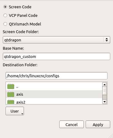

1.1. copy
Used for copying QtVCP’s builtin Screens/VCP Panels/QtVismach code to a folder so one can customize it.
In a terminal run:
qtvcp copy
![QtVCP copy Dialog - Screen, Panel or Vismach Code Copy Panel](images/qtvcp_copy_dialog.png)
copy
Dialog - Screen, VCP Panel or QtVismach Code Copy Panel1.2. spindle_belts

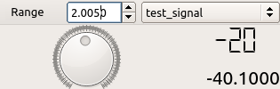

1.3. test_dial
This panel has a dial that adjusts S32 and Float HAL output pins.
The dial’s range can be adjusted from a drop down menu.
The output can be scaled with the
spinbox
A
combobox
can be used to automatically select and connect to a signal.
loadusr qtvcp test_dial
![QtVCP test_dial Panel - Test Dial VCP](images/qtvcp_test_dial.png)
test_dial

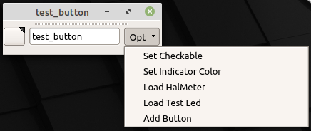

Panel - Test Dial VCP1.4. test_button
This panel has a button that will set a HAL pin.
The button can be selected as a momentary or a toggle button.
The button’s indicator color can be adjusted from a drop down menu.
You can add more buttons from the drop down menu.
You can load a Halmeter from the drop down menu.
You can load a test LED from the drop down menu.
The button can be detached from the main windows.
Here is how to load test_button
from a HAL script:
loadusr qtvcp test_button loadusr qtvcp -o 4 test_button
The -o
switch sets how many buttons the panel starts with.
If loading directly from a terminal omit the loadusr
![QtVCP test_button - Test Button VCP](images/qtvcp_test_button.png)
test_button

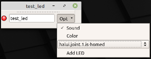

- Test Button VCP1.5. test_led
This panel has an LED that can selected to watch HAL bit pins/signals.
The LED’s color can be adjusted from a drop down menu.
The text box and state can be output as speech if sound is selected.
A
combobox
can be used to automatically select and connect to a pin/signal. -
You can add more LEDs from the drop down menu.
The LED can be detached from the main windows.
Here is how to load test_led
from a HAL script:
loadusr qtvcp test_led loadusr qtvcp -o 4 test_led
The -o
switch sets how many LEDs the panel starts with.
If loading directly from a terminal omit the loadusr.

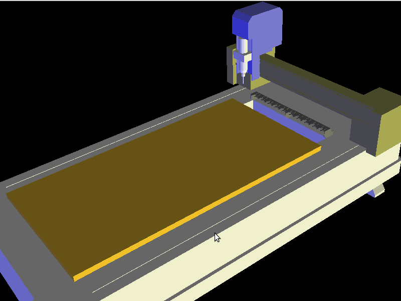

- 3-Axis Mill 3D View Panel2.2. QtVCP vismach_router_atc
3D OpenGL view of a 3-Axis router style, gantry bed milling machine.
This particular panel shows how to define and connect the model parts in the handler file,
rather then importing the pre-built model from QtVCP’s vismach library.
loadusr qtvcp vismach_router_atc

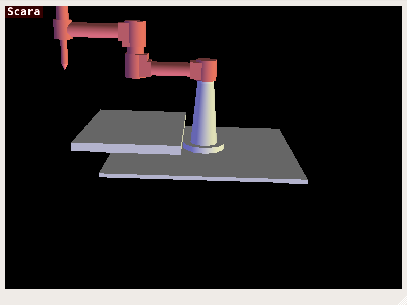

- 3-Axis Gantry Bed Mill 3D View Panel2.3. QtVCP vismach_scara
3D OpenGL view of a SCARA based milling machine.
loadusr qtvcp vismach_scara
![QtVCP vismach_scara - SCARA Mill 3D View Panel](images/qtvismach_scara.png)
vismach_scara

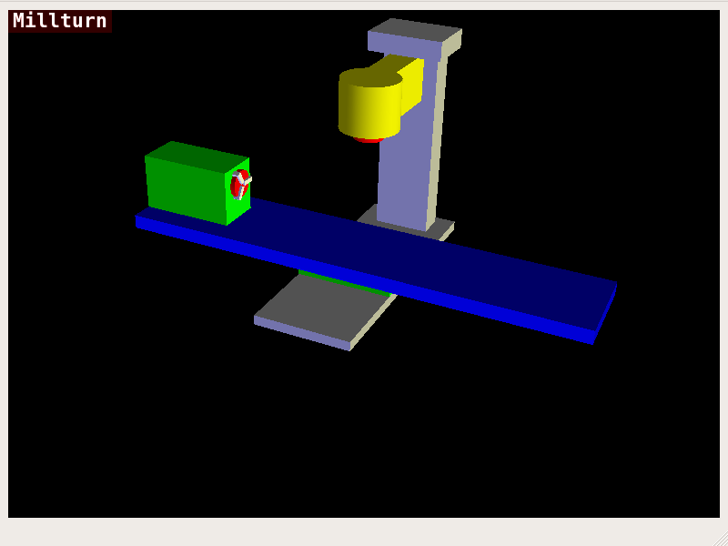

- SCARA Mill 3D View Panel2.4. QtVCP vismach_millturn
3D OpenGL view of a 3-Axis milling machine with an A axis/spindle.
loadusr qtvcp vismach_millturn
![QtVCP vismach_millturn - 4 Axis MillTurn 3D View Panel](images/qtvismach_millturn.png)
vismach_millturn

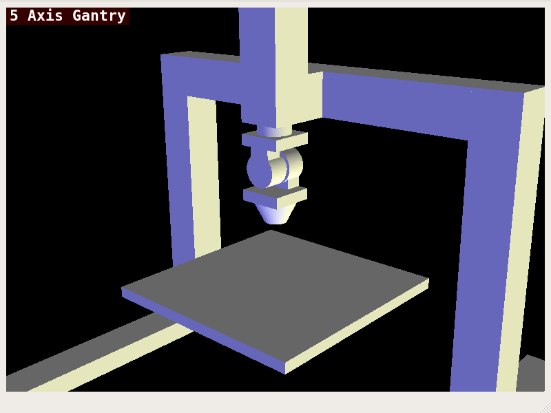

- 4 Axis MillTurn 3D View Panel2.5. QtVCP vismach_mill_5axis_gantry
3D OpenGL view of a 5-Axis gantry type milling machine.
loadusr qtvcp vismach_mill_5axis_gantry
![QtVCP vismach_mill_5axis_gantry - 5-Axis Gantry Mill 3D View Panel](images/qtvismach_5axis_gantry.png)

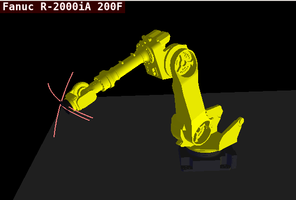

- 5-AxIs Gantry Mill 3D View Panel2.6. QtVCP vismach_fanuc_200f
3D openGL view of a 6 joint robotic arm.
loadusr qtvcp vismach_fanuc_200f
