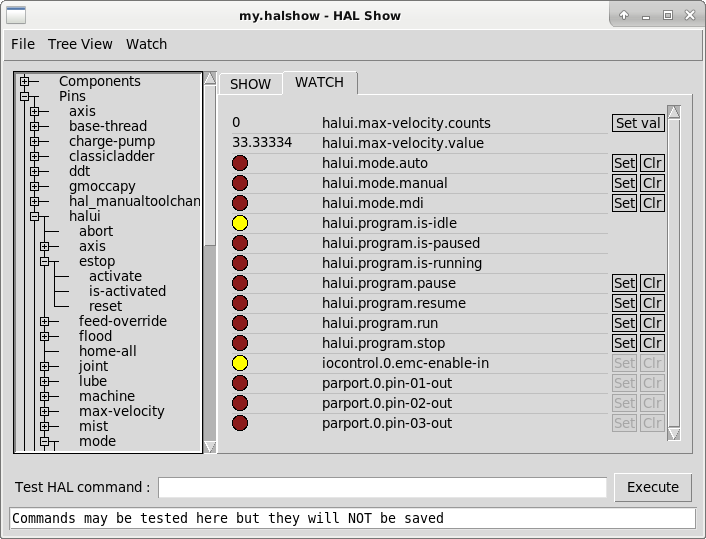

3. Halshow
halshow
(complete usage description) can be started from the command line
to show details for selected components, pins, parameters, signals, functions, and threads of a running HAL.
The WATCH tab provides a continuous display of selected pin, parameters, and signal items.
The File menu provides buttons to save the watch items to a watch list and to load an existing watch list.
The watch list items can also be loaded automatically on startup.
For command line usage:
halshow --help
Usage:
halshow [Options] [watchfile]
Options:
--help (this help)
--fformat format_string_for_float
--iformat format_string_for_int
Notes:
Create watchfile in halshow using: 'File/Save Watch List'.
LinuxCNC must be running for standalone usage.
![Halshow Watch Tab](images/halshow-4.png)
A watchfile created using the File/Save Watch List menu item is formatted as a single line with tokens "pin+", "param+", "sig=+", followed by the appropriate pin, param, or signal name. The token-name pairs are separated by a space character.
pin+joint.0.pos-hard-limit pin+joint.1.pos-hard-limit sig+estop-loop
A watchfile created using the File/Save Watch List (multiline) menu item is formatted with separate lines for each item identified with token-name pairs as described above.
sig+estop-loop
When loading a watchfile with the File/Load Watch List menu item, the token-name pairs may appear as single or multiple lines. Blank lines and lines beginning with a # character are ignored.
