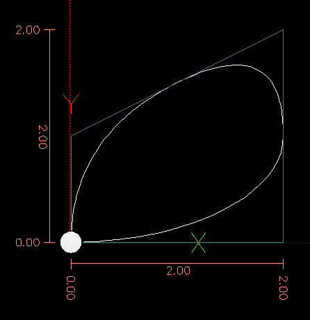

7. G5 Cubic Spline
G5 X- Y- <I- J-> P- Q-
  • I - X incremental offset from start point to first control point
  • J - Y incremental offset from start point to first control point
  • P - X incremental offset from end point to second control point
  • Q - Y incremental offset from end point to second control point
G5 creates a cubic B-spline in the XY plane with the X and Y axes only. P and Q must both be specified for every G5 command.
For the first G5 command in a series of G5 commands, I and J must both be specified. For subsequent G5 commands, either both I and J must be specified, or neither. If I and J are unspecified, the starting direction of this cubic will automatically match the ending direction of the previous cubic (as if I and J are the negation of the previous P and Q).
For example, to program a curvy N shape:
G5 Sample initial cubic spline
G90 G17
G0 X0 Y0
G5 I0 J3 P0 Q-3 X1 Y1
A second curvy N that attaches smoothly to this one can now be made without specifying I and J:
G5 Sample subsequent cubic spline
G5 P0 Q-3 X2 Y2
It is an error if:
  • P and Q are not both specified.
  • Just one of I or J are specified.
  • I or J are unspecified in the first of a series of G5 commands.
  • An axis other than X or Y is specified.
  • The active plane is not G17.

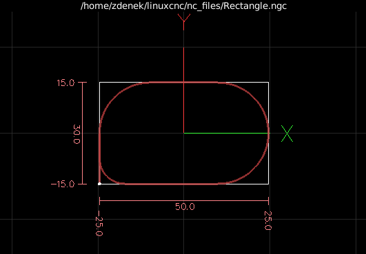

G64 With big Q- value
G64 P0.015 Q6

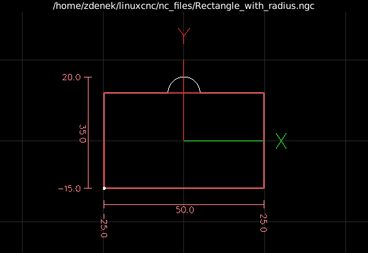

G64 Rectangle with radius before milling
Figure 4. G64 Rectangle with radius before milling

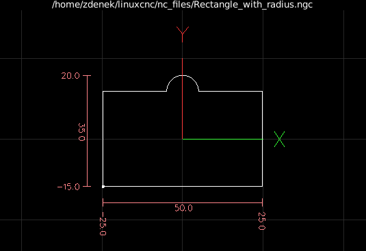

G64 Rectangle with radius after milling
Figure 5. G64 Rectangle with radius after milling

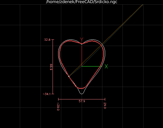

G64 P0.015 Q2
G64 Heart
Figure 6. G64 Heart
