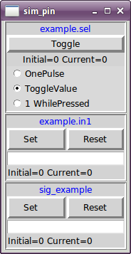

sim_pin is a command line utility to display and update any number of writable pins, parameters or signals. Usage:
Usage: sim_pin name1 [name2 ...] & Note: LinuxCNC (or a standalone Hal application) must be running A named item can specify a pin, param, or signal The item must be writable, e.g.: pin: IN or I/O (and not connected to a signal) param: RW signal: connected to a writable pin Hal item types bit,s32,u32,float are supported When a bit item is specifed, a pushbutton is created to manage the item in one of three manners specified by radio buttons: toggle: Toggle value when button pressed pulse: Pulse item to 1 once when button pressed hold: Set to 1 while button pressed The bit pushbutton mode can be specifed on the command line by formatting the item name: namei/mode=[toggle | pulse | hold]
For complete information, see the man page:
man sim_pin
Example (with LinuxCNC running):
halcmd loadrt mux2 names=example; halcmd net sig_example example.in0 sim_pin example.sel example.in1 sig_example &

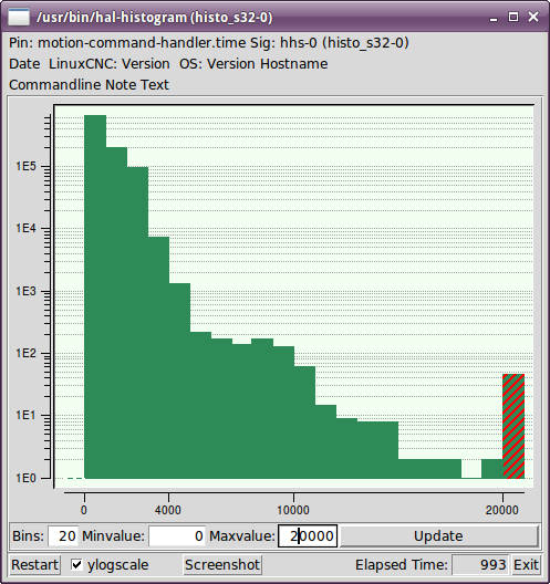

7. Hal Histogram
hal-histogram is a command line utility to display histograms for hal pins.
Usage: hal-histogram --help | -? or hal-histogram [Options] [pinname] Options: --minvalue minvalue (minimum bin, default: 0) --binsize binsize (binsize, default: 100) --nbins nbins (number of bins, default: 50) --logscale 0|1 (y axis log scale, default: 1) --text note (text display, default: "" ) --show (show count of undisplayed nbins, default off) --verbose (progress and debug, default off) Notes: 1) LinuxCNC (or another Hal application) must be running 2) If no pinname is specified, default is: motion-command-handler.time 3) This app may be opened for 5 pins 4) pintypes float, s32, u32, bit are supported 5) The pin must be associated with a thread supporting floating point For a base thread, this may require using: loadrt motmod ... base_thread_fp=1
