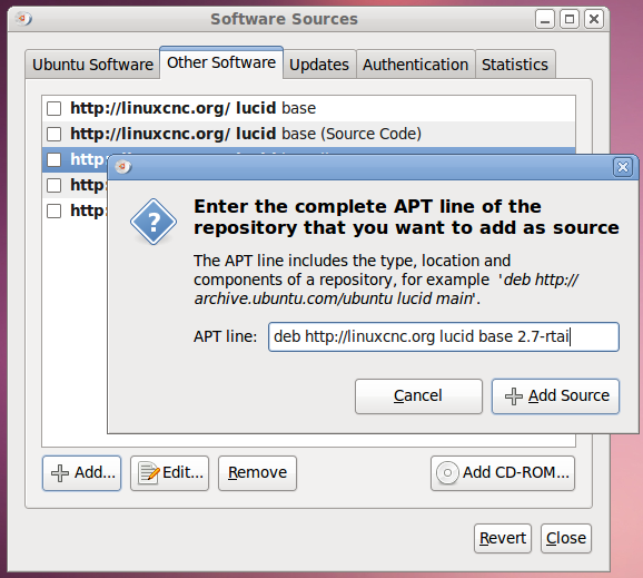

  • In the Software Sources window, select the Other Software tab.
  • Delete or un-check all the old linuxcnc.org entries (leave all non-linuxcnc.org lines as they are).
  • Click the Add button and add a new apt line. The line will be slightly different on the different platforms:
Platform apt source line
Debian Wheezy
deb http://linuxcnc.org wheezy base 2.7-rtai
Ubuntu Precise
deb http://linuxcnc.org precise base 2.7-rtai
Ubuntu Lucid
deb http://linuxcnc.org lucid base 2.7-rtai
images/upgrading-to-2.7.png
  • Click Add Source, then Close in the Software Sources window. If it pops up a window informing you that the information about available software is out-of-date, click the Reload button.
