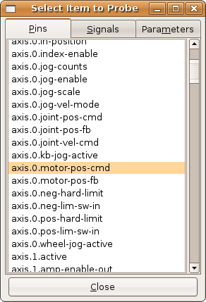

2. Halmeter
Halmeter is a voltmeter for the HAL.
It lets you look at a pin, signal, or parameter, and displays the current value of that item.
It is pretty simple to use.
Start it by typing halmeter in an X windows shell.
Halmeter is a GUI application.
It will pop up a small window, with two buttons labeled "Select" and "Exit".
Exit is easy - it shuts down the program.
Select pops up a larger window, with three tabs. One tab lists all the pins currently defined in the HAL.
The next lists all the signals, and the last tab lists all the parameters.
Click on a tab, then click on a pin/signal/parameter.
Then click on "OK".
The lists will disappear, and the small window will display the name and value of the selected item.
The display is updated approximately 10 times per second.

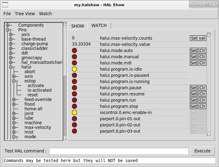

3. Halshow
halshow (complete usage description) can be started from the command line
to show details for selected components, pins, parameters, signals, functions, and threads of a running HAL.
The WATCH tab provides a continuous display of selected pin, parameters, and signal items.
The File menu provides buttons to save the watch items to a watch list and to load an existing watch list.
The watch list items can also be loaded automatically on startup.
For command line usage:
halshow --help
Usage:
  halshow [Options] [watchfile]
  Options:
           --help    (this help)
           --fformat format_string_for_float
           --iformat format_string_for_int
Notes:
  Create watchfile in halshow using: 'File/Save Watch List'.
  LinuxCNC must be running for standalone usage.
A watchfile created using the File/Save Watch List menu item is formatted as a single line with tokens "pin+", "param+", "sig=+", followed by the appropriate pin, param, or signal name. The token-name pairs are separated by a space character.
pin+joint.0.pos-hard-limit pin+joint.1.pos-hard-limit sig+estop-loop
A watchfile created using the File/Save Watch List (multiline) menu item is formatted with separate lines for each item identified with token-name pairs as described above.
sig+estop-loop
When loading a watchfile with the File/Load Watch List menu item, the token-name pairs may appear as single or multiple lines. Blank lines and lines beginning with a # character are ignored.

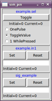

5. Sim Pin
sim_pin is a command line utility to display and update any number of writable pins, parameters or signals.
Usage:
        sim_pin [Options] name1 [name2 ...] &
Options:
        --help                (this text)
        --title title_string  (window title, default: sim_pin)
Note:  LinuxCNC (or a standalone HAL application) must be running
        A named item can specify a pin, param, or signal
        The item must be writable, e.g.:
          pin:    IN or I/O (and not connected to a signal with a writer)
          param:  RW
          signal: connected to a writable pin
        HAL item types bit,s32,u32,float are supported.
        When a bit item is specified, a pushbutton is created
        to manage the item in one of three manners specified
        by radio buttons:
            toggle: Toggle value when button pressed
            pulse:  Pulse item to 1 once when button pressed
            hold:   Set to 1 while button pressed
        The bit pushbutton mode can be specified on the command
        line by formatting the item name:
            namei/mode=[toggle | pulse | hold]
        If the mode begins with an uppercase letter, the radio
        buttons for selecting other modes are not shown
For complete information, see the man page:
man sim_pin
halcmd loadrt mux2 names=example; halcmd net sig_example example.in0
sim_pin example.sel example.in1 sig_example &

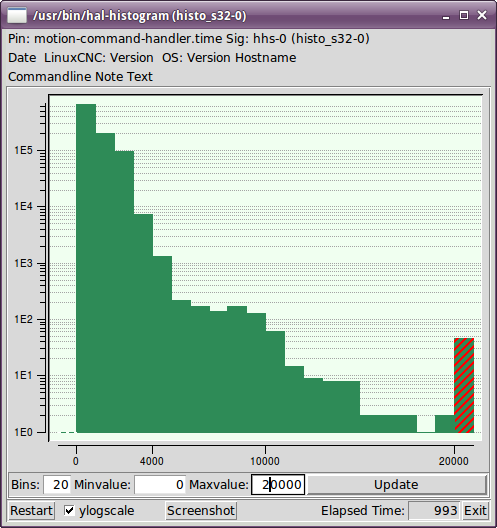

7. HAL Histogram
hal-histogram is a command line utility to display histograms for HAL pins.
   hal-histogram --help | -?
or
   hal-histogram [Options] [pinname]
| Option | Value | Description |
--minvalue  |
minvalue  |
minimum bin, default: 0  |
--binsize  |
binsize  |
binsize, default: 100  |
--nbins  |
nbins  |
number of bins, default: 50  |
--logscale  |
0/1  |
y axis log scale, default: 1  |
--text  |
note  |
text display, default: ""  |
--show  |
show count of undisplayed nbins, default off  |
--verbose  |
progress and debug, default off  |
LinuxCNC (or another HAL application) must be running.
If no pinname is specified, default is:
motion-command-handler.time. -
This app may be opened for 5 pins.
Pintypes float, s32, u32, bit are supported.
The pin must be associated with a thread supporting floating point. For a base thread, this may require using
loadrt motmod ... base_thread_fp=1.
