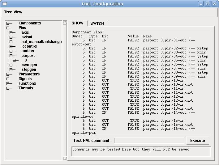

To see the HAL configuration and check the status of pins and parameters use the HAL Configuration window on the Machine menu in AXIS. To watch a pin status open the Watch tab and click on each pin you wish to watch and it will be added to the watch window.
![The HAL Configuration Window](images/HAL_Configuration.png)

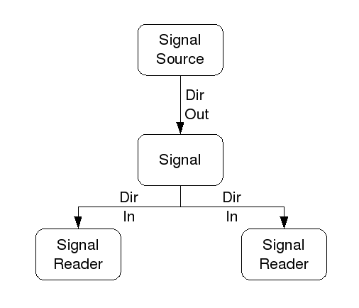

![Signal Direction](images/signal-direction.png)
This example shows the signal xStep with the source being stepgen.0.out
and with two readers, parport.0.pin-02-out
and parport.0.pin-08-out
Basically the value of stepgen.0.out
is sent to the signal xStep and that value is then sent to parport.0.pin-02-out
# signal source destination destination net xStep stepgen.0.out => parport.0.pin-02-out parport.0.pin-08-out
Since the signal xStep contains the value of stepgen.0.out
(the source) you can use the same signal again to send the value to another reader.
To do this just use the signal with the readers on another line.
# signal destination2 net xStep => parport.0.pin-06-out

In the following example, a copy of the AXIS HAL configuration window, bits 0 and 2 are TRUE, they have no offset. The weight (weight) of bit 0 is 1, that of bit 2 is 4, so the sum is 5.
Owner | Type | Dir | Value | Name |
10 |
bit |
In |
TRUE |
10 |
s32 |
I/O |
1 |
10 |
bit |
In |
FALSE |
10 |
s32 |
I/O |
2 |
10 |
bit |
In |
TRUE |
10 |
s32 |
I/O |
4 |
10 |
bit |
In |
FALSE |
10 |
s32 |
I/O |
8 |
10 |
bit |
In |
FALSE |
10 |
s32 |
I/O |
0 |
10 |
s32 |
Out |
5 |
