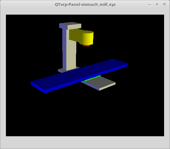

Vismach displays the model in a 3D viewport and the model parts are animated as the values of associated HAL pins change.
The Vismach 3D viewport view can be manipulated as follows:
zoom by scroll wheel
pan by middle button drag
rotate by right-button drag
tilt by left button drag

Taking the mill shown in the 3D Viewport picture above for example:
If you move X, it can move on its own,
but if you move Y, it will also move X assembly, as it is attached to Y assembly.
So for this machine, the tree looks like this:
