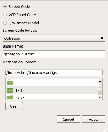

1.1. copy
Used for copying QtVCP’s builtin Screens/VCP Panels/QtVismach code to a folder so one can customize it.
In a terminal run:
qtvcp copy

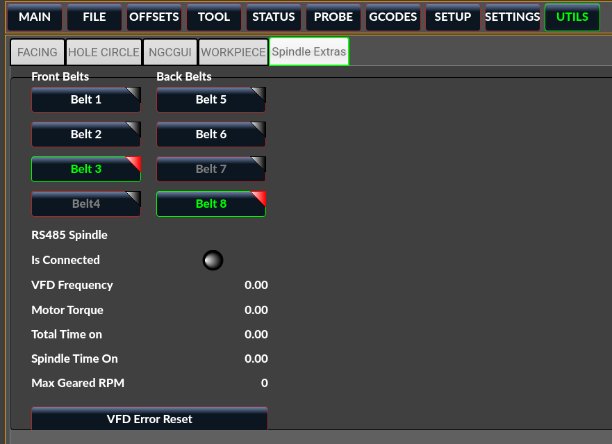

copy Dialog - Screen, VCP Panel or QtVismach Code Copy Panel1.2. spindle_belts
This panel is designed to display additional RS485 VFD data and also to configure a 4 sheave, 2 belt spindle drive via a series of buttons.
In addition, it is also a useful template to use for your custom panel because it includes:
Display of additional HAL data
Buttons and button groups
Dynamic changes to button enabled/disabled state based on the state of other buttons
Saving data to the qtdragon.prefs file
Custom button to reset the VFD
Modify this panel to suit your own requirements. Most common features are used. The advantage of using panels is that it separates your custom display code from the qtdragon core code so upgrading the system will not break your customization.
1.2.1. Additional Requirements
A spindle drive (for instance VFDMOD)
A custom component that scales the VFD frequency to obtain the desired spindle speed.
A belt driven spindle that uses two belts and an intermediate idler pulley much like a drill press.
Connect the input pins qtdragon.belts.<pin-name> in your postgui HAL file.
1.2.2. Funktion
The belts are broken into two button groups, the front belts and the rear belts. These are numbered as per the plate on the machine. Buttons in a group are mutually exclusive, i.e., only one can be selected in the group.
Additionally, it’s not possible to have both belts on the same level with this kind of mechanism because you cannot fit two belts to the one idler pulley sheave. So if a belt is selected, its opposite button is disabled. E.g., if belt 3 is selected, belt 7 is disabled.
1.2.3. Embedding commands
Add these lines to the [DISPLAY] section in your .ini file
The example tab_location is for the QtDragon screen.
EMBED_TAB_NAME=Spindle Extras
EMBED_TAB_COMMAND=qtvcp spindle_belts
EMBED_TAB_LOCATION=tabWidget_utilities
Here is how to load spindle_belt from a HAL script:
loadusr qtvcp spindle_belts
1.2.4. Customization Hints
Customizing the panel:
Copy the files located in /user/share/qtvcp/qtdragon/panels/belts to: ~/linuxcnc/configs/<my_configuration_folder>/qtvcp/panels/belts (you can use the copy dialog panel to do this)
Edit belts.ui with designer.
Edit belts_handler.py with a text editor
Connect the relevant pins in a postgui.hal file
Make sure your postgui file is loaded by your .ini file.
For information on the finer points, consult the QtVCP and QtDragon documentation. The Python handler file also provides a useful template for any custom panel.

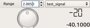

1.3. test_dial
Dieses Panel hat ein * Einstellrad, das S32- und Float-HAL-Ausgangspins einstellt *.
The dial’s range can be adjusted from a drop down menu.
The output can be scaled with the
spinbox. -
A
comboboxcan be used to automatically select and connect to a signal.
loadusr qtvcp test_dial

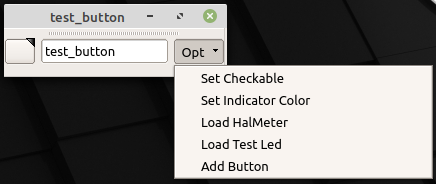

test_dial Panel - Test Dial VCP1.4. test_button
Dieses Panel hat eine Schaltfläche, die einen HAL-Pin setzt.
The button can be selected as a momentary or a toggle button.
The button’s indicator color can be adjusted from a drop down menu.
You can add more buttons from the drop down menu.
You can load a Halmeter from the drop down menu.
You can load a test LED from the drop down menu.
The button can be detached from the main windows.
Here is how to load test_button from a HAL script:
loadusr qtvcp test_button loadusr qtvcp -o 4 test_button
The -o switch sets how many buttons the panel starts with.
If loading directly from a terminal omit the loadusr.

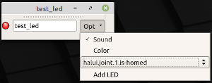

test_button - Test Button VCP1.5. test_led
Dieses Panel verfügt über eine *LED, die ausgewählt werden kann, um HAL-Bit-Pins / Signale * zu beobachten.
The LED’s color can be adjusted from a drop down menu.
The text box and state can be output as speech if sound is selected.
A
comboboxcan be used to automatically select and connect to a pin/signal. -
You can add more LEDs from the drop down menu.
The LED can be detached from the main windows.
Here is how to load test_led from a HAL script:
loadusr qtvcp test_led loadusr qtvcp -o 4 test_led
The -o switch sets how many LEDs the panel starts with.

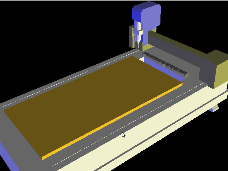

vismach_mill_xyz - 3-Achsen-Fräse 3D-Ansichtspanel2.2. QtVCP vismach_router_atc
3D OpenGL view of a 3-Axis router style, gantry bed milling machine.
This particular panel shows how to define and connect the model parts in the handler file, rather then importing the pre-built model from QtVCP’s vismach library.
loadusr qtvcp vismach_router_atc

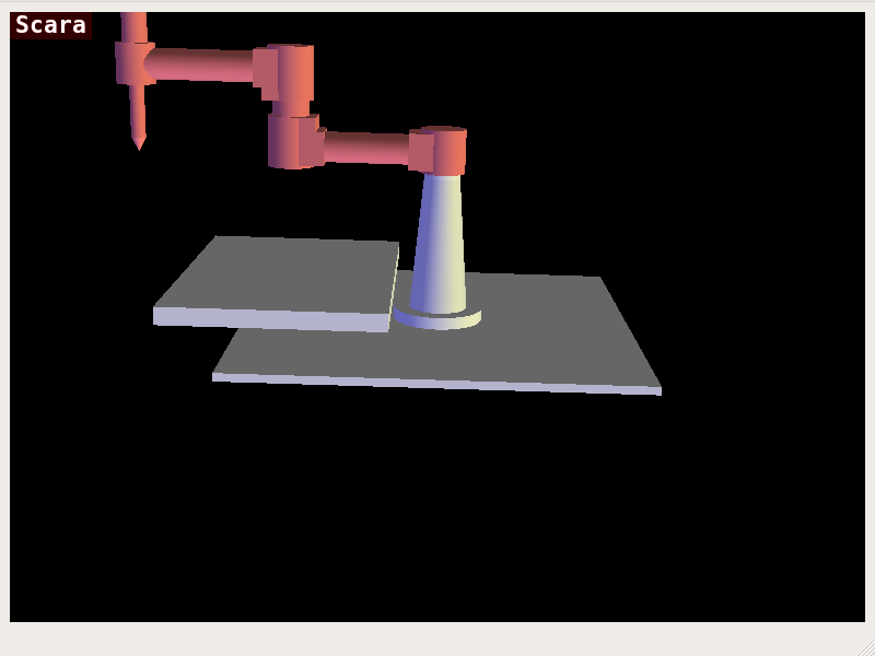

vismach_router_atc - 3-Axis Gantry Bed Mill 3D View Panel2.3. QtVCP vismach_scara
3D-OpenGL-Ansicht einer SCARA-basierten Fräsmaschine.
loadusr qtvcp vismach_scara

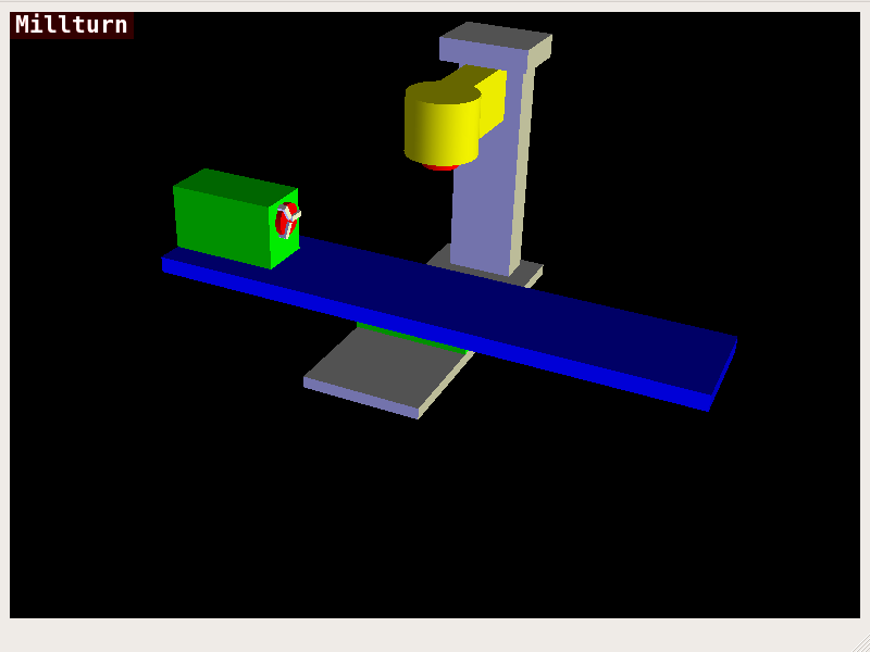

vismach_scara - SCARA Fräse 3D-Ansichtsfenster2.4. QtVCP vismach_millturn
3D OpenGL view of a 3-Axis milling machine with an A axis/spindle.
loadusr qtvcp vismach_millturn

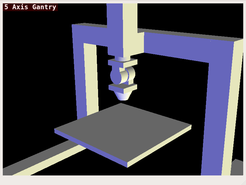

vismach_millturn - 4 Axis MillTurn 3D View Panel2.5. QtVCP vismach_mill_5axis_gantry
3D OpenGL view of a 5-Axis gantry type milling machine.
loadusr qtvcp vismach_mill_5axis_gantry

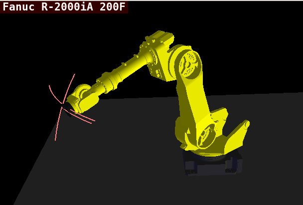

vismach_mill_5axis_gantry - 5-AxIs Gantry Mill 3D View Panel2.6. QtVCP vismach_fanuc_200f
3D openGL view of a 6 joint robotic arm.
loadusr qtvcp vismach_fanuc_200f
