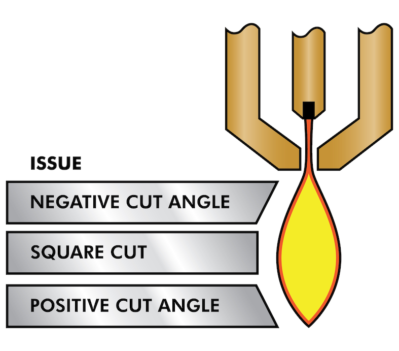

A plasma Arc is oval in shape and the cutting height needs to be controlled to minimise bevelled edges. If the torch is too high or too low then the edges can become excessively bevelled. It is also critical that the torch is held perpendicular to the surface.
  • Torch to work distance can impact edge bevel
width=50%
  • Negative cut angle: torch too low, increase torch to work distance.
  • Positive cut angle: torch too high, decrease torch to work distance.
Not
A slight variation in cut angles may be normal, as long as it is within tolerance.
