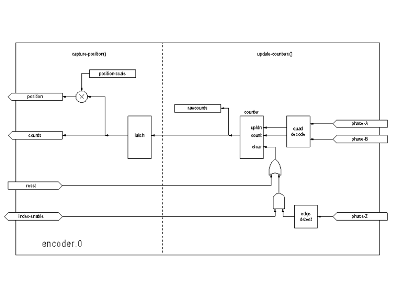

3. Encoder
This component provides software based counting of signals from quadrature (or single-pulse) encoders. It is a realtime component only, and depending on CPU speed, latency, etc., is capable of maximum count rates of 10 kHz to perhaps up to 50 kHz.
The base thread should be 1/2 count speed to allow for noise and timing variation. For example if you have a 100 pulse per revolution encoder on the spindle and your maximum RPM is 3000 the maximum base thread should be 25 µs. A 100 pulse per revolution encoder will have 400 counts. The spindle speed of 3000 RPM = 50 RPS (revolutions per second). 400 * 50 = 20,000 counts per second or 50 µs between counts.
The Encoder Counter Block Diagram is a block diagram of one channel of an encoder counter.
images/encoder-block-diag.png
Figur 6. Encoder Counter Block Diagram

halcmd: loadrt encoder [num_chan=<counters>]
<counters> is the number of encoder counters that you want to install. If num_chan is not specified, three counters will be installed. The maximum number of counters is 8 (as defined by MAX_CHAN in encoder.c). Each counter is independent, but all are updated by the same function(s) at the same time. In the following descriptions, <chan> is the number of a specific counter. The first counter is number 0.

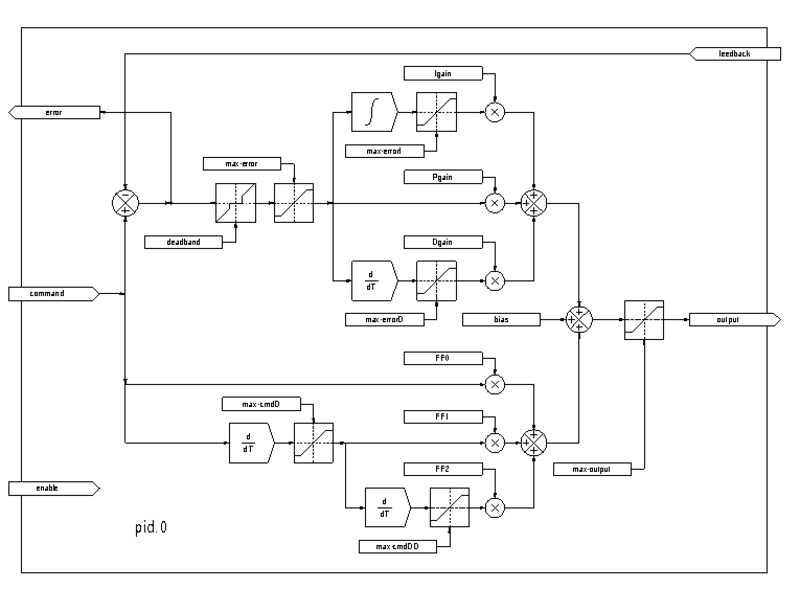

4. PID
This component provides Proportional/Integral/Derivative control loops. It is a realtime component only. For simplicity, this discussion assumes that we are talking about position loops, however this component can be used to implement other feedback loops such as speed, torch height, temperature, etc. The PID Loop Block Diagram is a block diagram of a single PID loop.
images/pid-block-diag.png
Figur 7. PID Loop Block Diagram

halcmd: loadrt pid [num_chan=<loops>] [debug=1]
<loops> is the number of PID loops that you want to install. If num_chan is not specified, one loop will be installed. The maximum number of loops is 16 (as defined by MAX_CHAN in pid.c). Each loop is completely independent. In the following descriptions, <loopnum> is the loop number of a specific loop. The first loop is number 0.
If debug=1 is specified, the component will export a few extra pins that may be useful during debugging and tuning. By default, the extra pins are not exported, to save shared memory space and avoid cluttering the pin list.

  • (float) pid.`__<loopnum>__.feedback` - The present position, as measured by a feedback device such as an encoder.
  • (float) pid.`__<loopnum>__.output` - A velocity command that attempts to move from the present position to the desired position.
For a position loop, .command and .feedback are in position units. For a linear axis, this could be inches, mm, meters, or whatever is relevant. Likewise, for an angular axis, it could be degrees, radians, etc. The units of the .output pin represent the change needed to make the feedback match the command. As such, for a position loop .output is a velocity, in inches/s, mm/s, degrees/s, etc. Time units are always seconds, and the velocity units match the position units. If command and feedback are in meters, then output is in meters per second.
Each loop has two pins which are used to monitor or control the general operation of the component.
  • (float) pid.<loopnum>.error - Equals .command minus .feedback.
  • (bit) pid.<loopnum>.enable - A bit that enables the loop. If .enable is false, all integrators are reset, and the output is forced to zero. If .enable is true, the loop operates normally.
Pins used to report saturation. Saturation occurs when the output of the PID block is at its maximum or minimum limit.
  • (bit) pid.<loopnum>.saturated - True when output is saturated.
  • (float) pid.<loopnum>.saturated_s - The time the output has been saturated.
  • (s32) pid.<loopnum>.saturated_count - The time the output has been saturated.
The PID gains, limits, and other tunable features of the loop are available as pins so that they can be adjusted dynamically for more advanced tuning possibilities.
  • (float) pid.<loopnum>.Pgain - Proportional gain
  • (float) pid.<loopnum>.Igain - Integral gain
  • (float) pid.<loopnum>.Dgain - Derivative gain
  • (float) pid.<loopnum>.bias - Constant offset on output
  • (float) pid.<loopnum>.FF0 - Zeroth order feedforward - output proportional to command (position).
  • (float) pid.<loopnum>.FF1 - First order feedforward - output proportional to derivative of command (velocity).
  • (float) pid.<loopnum>.FF2 - Second order feedforward - output proportional to 2nd derivative of command (acceleration).
  • (float) pid.<loopnum>.deadband - Amount of error that will be ignored
  • (float) pid.<loopnum>.maxerror - Limit on error
  • (float) pid.<loopnum>.maxerrorI - Limit on error integrator
  • (float) pid.<loopnum>.maxerrorD - Limit on error derivative
  • (float) pid.<loopnum>.maxcmdD - Limit on command derivative
  • (float) pid.<loopnum>.maxcmdDD - Limit on command 2nd derivative
  • (float) pid.<loopnum>.maxoutput - Limit on output value
All max* limits are implemented so that if the value of this parameter is zero, there is no limit.
If debug=1 was specified when the component was installed, four additional pins will be exported:
  • (float) pid.<loopnum>.errorI - Integral of error.
  • (float) pid.<loopnum>.errorD - Derivative of error.
  • (float) pid.<loopnum>.commandD - Derivative of the command.
  • (float) pid.<loopnum>.commandDD - 2nd derivative of the command.
4.2. Functions
The component exports one function for each PID loop. This function performs all the calculations needed for the loop. Since each loop has its own function, individual loops can be included in different threads and execute at different rates.
  • (funct) pid.<loopnum>.do_pid_calcs - Performs all calculations for a single PID loop.
If you want to understand the exact algorithm used to compute the output of the PID loop, refer to
  • figure PID Loop Block Diagram,
  • the comments at the beginning of emc2/src/hal/components/pid.c, and of course to
  • the code itself.
The loop calculations are in the C function calc_pid().
