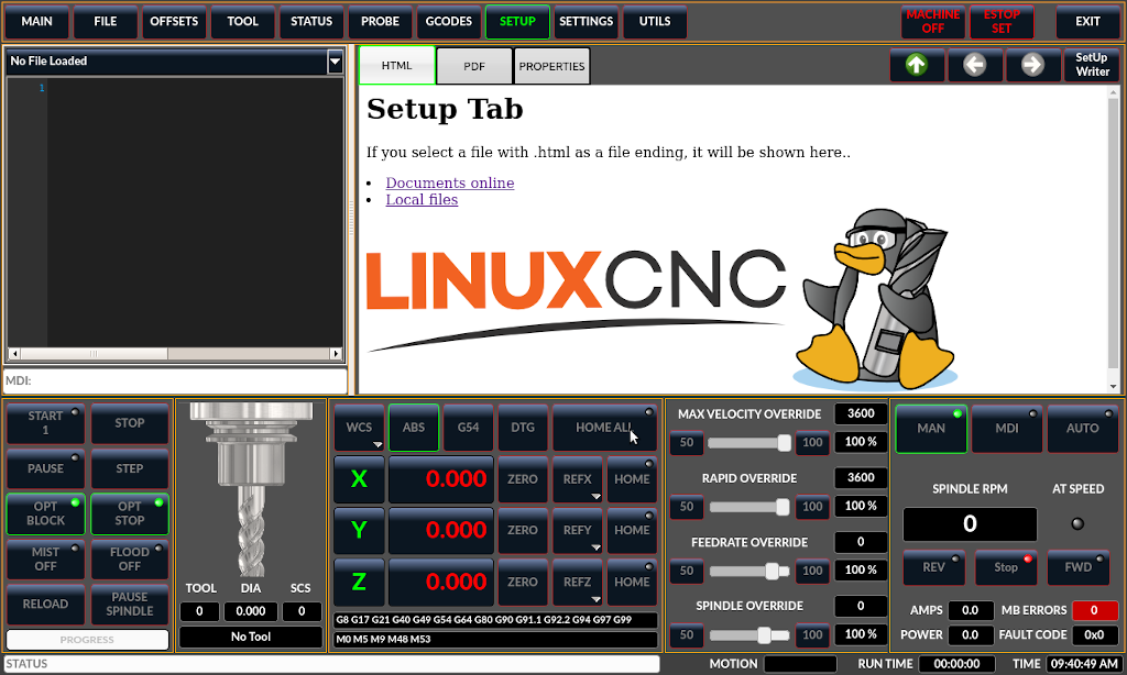

17.9. Setup Tab
It’s possible to load HTML or PDF file (.html / .pdf ending) with setup notes, and will be displayed in the setup tab.
If you load a G-code program and there is an HTML/PDF file of the same name, it will load automatically.
Some program, such as Fusion 360 and Aspire will create these files for you. You can also write your own HTML docs with the included SetUp Writer button.
There are three sub tabs:
  • HTML - any loaded HTML pages are displayed here. The navigation buttons work on this page.
  • PDF - any loaded PDF setup pages are displayed here.
  • PROPERTIES - when a program is loaded its G-code properties are displayed here.
There are navigation buttons for HTML page:
  • The up arrow returns you to the default HTML page.
  • The left arrow moves backward one HTML page.
  • The right arrow moves forward one HTML page.
If you wish to include a custom default HTML page, name it default_setup.html and place it in your configuration folder.
Custom QtVCP panels can be displayed in this tab by setting the EMBED_TAB_LOCATION option to tabWidget_setup.
QtDragon Setup Tab
Figur 9. QtDragon - Setup Tab Sample

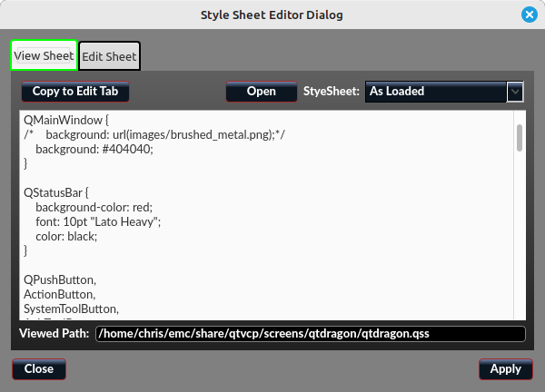

20.1. Stylesheets
Stylesheets can be leveraged to do a fair amount of customization, but you usually need to know a bit about the widget names. Pressing F12 will display a stylesheet editor dialog to load/test/save modification. Sometimes these lines will be present and you can change them, otherwise you will need to add them.
For instance, to change the DRO font (look for this entry and change the font name):
