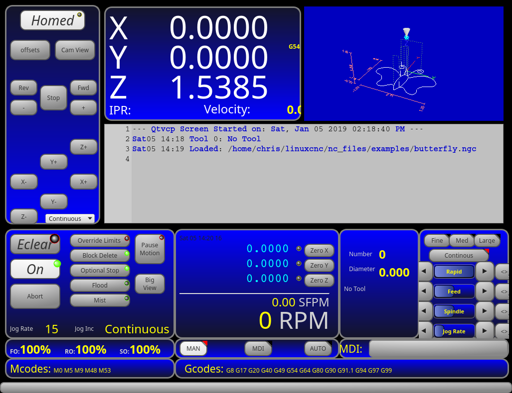

QtDragon Router
Figure 1. QtDragon - 3/4-Axis Sample

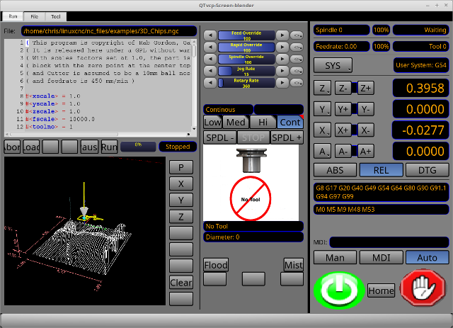

Qtscreen Blender
Figure 4. Blender - 4-Axis Sample

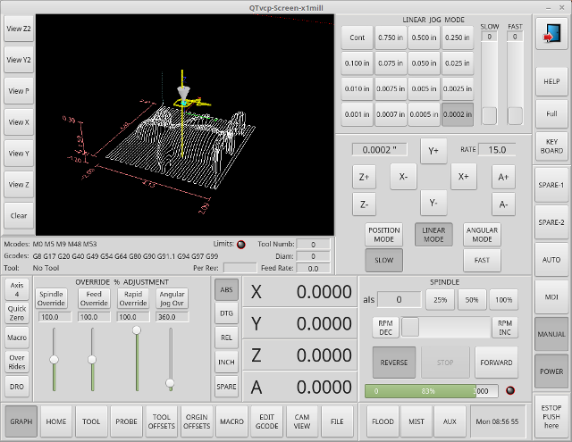

Qtscreen x1mill
Figure 5. X1mill - 4-Axis Sample

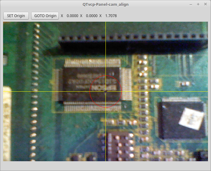

Qtscreen x1mill
Figure 6. cam_align - Camera Alignment VCP

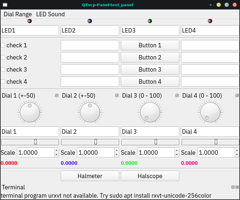

Test Panel
Figure 7. test_panel - Test Panel VCP

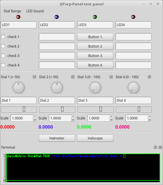

QtVCP can be used to create control panels that interface with HAL.
3.1. Builtin Panels
There are several builtin HAL panels available.
In a terminal type qtvcp <return> to see a list:
test_panel
Collection of useful widgets for testing HAL components, including speech of LED state.
QtVCP HAL Test Builtin Panel
Figure 8. QtVCP HAL Test Builtin Panel
cam_align
A camera display widget for rotational alignment.
Qtscreen x1mill
Figure 9. cam_align - Camera Alignment VCP

loadusr -Wn test_panel qtvcp test_panel
In this way HAL will wait till the HAL pins are made before continuing on.
3.2. Custom Panels
You can of course make your own panel and load it.
If you made a UI file named my_panel.ui and a HAL file named my_panel.hal, you would then load this from a terminal with:
halrun -I -f my_panel.hal
Example HAL file loading a QtVCP panel
# load realtime components
loadrt threads
loadrt classicladder_rt
# load non-realtime programs
loadusr classicladder
loadusr -Wn my_panel qtvcp my_panel.ui  # <1>
# add components to thread
addf classicladder.0.refresh thread1
# connect pins
net bit-input1     test_panel.checkbox_1        classicladder.0.in-00
net bit-hide       test_panel.checkbox_4        classicladder.0.hide_gui
net bit-output1    test_panel.led_1             classicladder.0.out-00
net s32-in1        test_panel.doublescale_1-s   classicladder.0.s32in-00
# start thread
start
  1. In this case we load qtvcp using -Wn which waits for the panel to finish loading before continuing to run the next HAL command.
    This is to ensure that the panel created HAL pins are actually done in case they are used in the rest of the file.

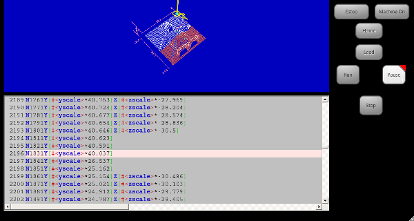

4. Build A Simple Clean-sheet Custom Screen
QtVCP Ugly custom screen
Figure 12. QtVCP Ugly custom screen
4.1. Overview
To build a panel or screen:
  • Use Qt Designer to build a design you like and save it to your configuration folder with a name of your choice, ending with .ui
  • Modify the configuration INI file to load QtVCP using your new .ui file.
  • Then connect any required HAL pins in a HAL file.
4.2. Get Qt Designer To Include LinuxCNC Widgets
Install Qt Designer
First you must have the Qt Designer installed.
The following commands should add it to your system, or use your package manager to do the same:
sudo apt-get install qttools5-dev-tools qttools5-dev libpython3-dev
Add qtvcp_plugin.py link to the Qt Designer Search Path
Then you must add a link to the qtvcp_plugin.py in one of the folders that Qt Designer will search into.
In a RIP version of LinuxCNC qtvcp_plugin.py will be:
'~/LINUXCNC_PROJECT_NAME/lib/python/qtvcp/plugins/qtvcp_plugin.py'
For a Package installed version it should be:
'usr/lib/python2.7/qtvcp/plugins/qtvcp_plugin.py' or
'usr/lib/python2.7/dist-packages/qtvcp/plugins/qtvcp_plugin.py'
Make a symbolic link to the above file and move it to one of the places Qt Designer searches in.
Qt Designer searches in these two place for links (pick one):
'/usr/lib/x86_64-linux-gnu/qt5/plugins/designer/python' or
'~/.designer/plugins/python'
You may need to create the plugins/python folder.
Start Qt Designer:
  • For a RIP install:
    Open a terminal, set the environment for LinuxCNC <1>, then load Qt Designer <2> with :
    . scripts/rip-environment   <1>
    designer -qt=5              <2>
  • For a package install:
    Open a terminal and type:
    designer -qt=5
If all goes right, Qt Designer will launch and you will see the selectable LinuxCNC widgets on the left hand side.

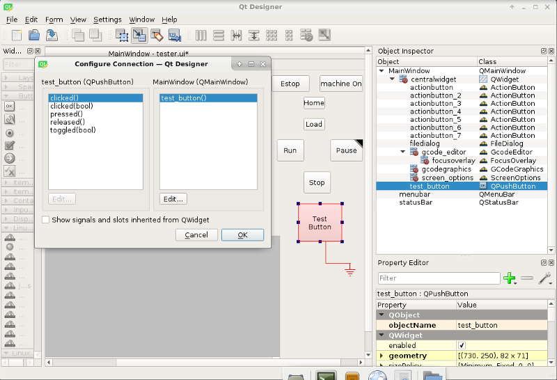

4.3. Build The Screen .ui File
Create MainWindow Widget
When Qt Designer is first started there is a 'New Form' dialog displayed.
Pick 'Main Window' and press the 'Create' button.
A MainWindow widget is displayed.
We are going to make this window a specific non resizeable size:
Set MainWindow Minimum and Maximum Size
  • Grab the corner of the window and resize to an appropriate size, say 1000x600.
  • Right click on the window and click set minimum size.
  • Do it again and set maximum size.
Our sample widget will now not be resizable.
Add the ScreenOptions Widget
Drag and drop the ScreenOptions widget anywhere onto the main window.
This widget doesn’t add anything visually but sets up some common options.
It’s recommended to always add this widget before any other.
Right click on the main window, not the ScreenOptions widget, and set the layout as vertical to make the ScreenOptions fullsized.
Add Panel Content
On the right hand side there is a panel with tabs for a Property editor and an Object inspector.
On the Object inspector click on the ScreenOptions.
Then switch to the Property Editor and, under the ScreenOptions heading, toggle filedialog_option.
Drag and drop a GCodeGraphics widget and a GcodeEditor widget.
Place and resize them as you see fit leaving some room for buttons.
Add Action Buttons
Add 7 action buttons on to the main window.
If you double click the button, you can add text.
Edit the button labels for Estop, Machine On, Home, Load, Run, Pause and stop.
Action buttons default to no action so we must change the properties for defined functions. You can edit the properties:
  • directly in the property editor on the right side of Qt Designer, or
  • conveniently, left double clicking on the button to launch a properties dialog that allows selecting actions while only displaying relevant data to the action.
We will describe the convenient way first:
  • Right click the Machine On button and select Set Actions.
  • When the dialog displays, use the combobox to navigate to MACHINE CONTROLS - Machine On.
  • In this case there is no option for this action so select OK.
Now the button will turn the machine on when pressed.
And now the direct way with Qt Designer’s property editor:
  • Select the Machine On button.
  • Go to the Property Editor on the right side of Qt Designer.
  • Scroll down until you find the ActionButton heading.
  • Click the machine_on action checkbox you will see in the list of properties and values.
The button will now control machine on/off.
Do the same for all the other button with the addition of:
  • With the Home button we must also change the joint_number property to -1.
    This tells the controller to home all the axes rather then a specific axis.
  • With the Pause button:
    • Under the Indicated_PushButton heading check the indicator_option.
    • Under the QAbstactButton heading check checkable.
Qt Designer: Selecting Pause Button's Properties
Figure 13. Qt Designer: Selecting Pause Button’s Properties
Save The .ui File
We then need to save this design as tester.ui in the sim/qtvcp folder.
We are saving it as tester as that is a file name that QtVCP recognizes and will use a built in handler file to display it.

6.2. Using Qt Designer to add Slots
When you have loaded your screen into Qt Designer, add a plain PushButton to the screen.
You could change the name of the button to something interesting like test_button.
There are two ways to edit connections - This is the graphical way.
  • There is a button in the top tool bar of Qt Designer for editing signals. After pushing it, if you click-and-hold on the button it will show an arrow (looks like a ground signal from electrical schematic).
  • Slide this arrow to a part of the main window that does not have widgets on it.
  • A Configure Connections dialog will pop up.
    • The list on the left are the available signals from the widget.
    • The list on the right are the available slots on the main window and you can add to it.
  • Pick the signal clicked() - this makes the slots side available.
  • Click Edit on the slots list.
  • A Slots/Signals of MainWindow dialog will pop up.
  • On the slots list at the top there is a + icon - click it.
  • You can now edit a new slot name.
  • Erase the default name slot() and change it to test_button().
  • Press the OK button.
  • You’ll be back to the Configure Connections dialog.
  • Now you can select your new slot in the slot list.
  • Then press OK and save the file.
Qt Designer Signal/Slot Selection
Figure 14. Qt Designer Signal/Slot Selection
6.3. Python Handler Changes
Now you must add the function to the handler file.
The function signature is def slot_name(self):.
For our example, we will add some code to print the widget name:
def test_button(self):
    name = self.w.sender().text()
    print(name)
Add this code under the section named:
# callbacks from form #
In fact it doesn’t matter where in the handler class you put the commands but by convention this is where to put it.
Save the handler file.
Now when you load your screen and press the button it should print the name of the button in the terminal.
