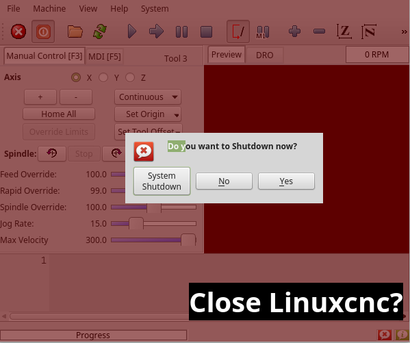

1.4. FocusOverlay - Focus Overlay Widget
This widget places a colored overlay over the screen, usually while a dialog is showing.
QtVCP focus overlay
Figure 1. Focus overlay example for confirm close prompt
Used to create a focused feel and to draw attention to critical information.
It can also show a translucent image.
It can also display message text and buttons.
This widget can be controlled with STATUS messages.

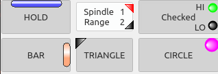

1.13. LED - Indicator Widget
QtVCP LED: LED Indicator Widget
Figure 5. QtVCP LED: LED Indicator Widget
A LED like indicator that optionally follows a HAL pin’s logic.
halpin_option
Selects if the LED follows an input HAL pin or program state.
diameter
Diameter of the LED (defaults to 15).
color
Color of the LED when on (defaults to green).
off_color
Color of the LED when off (defaults to black).
gradient
turns the gradient high light on or off (defaults to on).
on_gradient_color
Color highlight of the LED when on (defaults to white).
off_gradient_color
Color highlight of the LED when off (defaults to white).
alignment
Qt alignment hint.
state
Current state of LED
flashing
Turns flashing option on and off.
flashRate
Sets the flash rate.
The LED properties can be defined in a stylesheet with the following code added to the .qss file, name_of_led being the widget name defined in Qt Designer’s editor:
LED #name_0f_led{
  qproperty-color: red;
  qproperty-diameter: 20;
  qproperty-flashRate: 150;

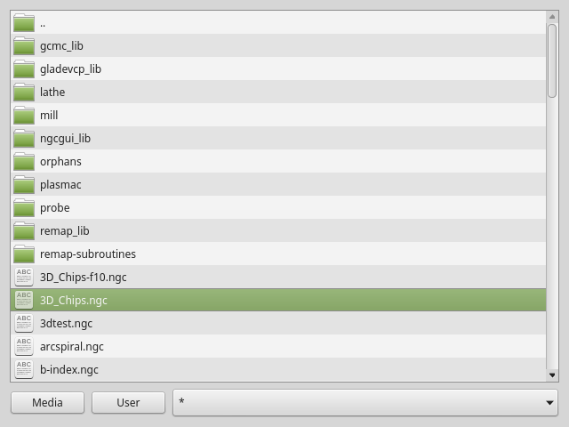

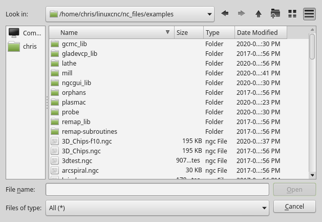

2.7. FileManager - File Loading Selector Widget
QtVCP FileManager: File Loading Selector Widget
Figure 7. QtVCP FileManager: File Loading Selector Widget
This widget is used to select files to load.
It has a the ability to scroll the names with hardware such as a MPG.
One can class patch the function load(self,fname) to customize file loading.
The function getCurrentSelected() will return a Python tuple, containing the file path and whether it is a file.
temp = FILEMANAGER.getCurrentSelected()
print('filepath={}'.format(temp[0]))
if temp[1]:
    print('Is a file')
Stylesheets Properties
doubleClickSelection (bool)
Determines whether or not to require double clicking on a folder.
Single clicking a folder (False) is enabled by default and is intended for touch screen users.
The following shows an example of how to set this property:
#filemanager {
    qproperty-doubleClickSelection: True;
showListView (bool)
Determines whether or not to show the file/folder structure in list form.
Table view (False) is enabled by default.
#filemanager {
    qproperty-showListView: True;
It is based on PyQt’s FIXME

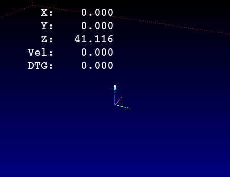

2.10. GCodeGraphics - G-code Graphic Backplot Widget
QtVCP GcodeGraphics: G-code Graphic Backplot Widget
Figure 8. QtVCP GcodeGraphics: G-code Graphic Backplot Widget
This displays the current G-code in a graphical form.

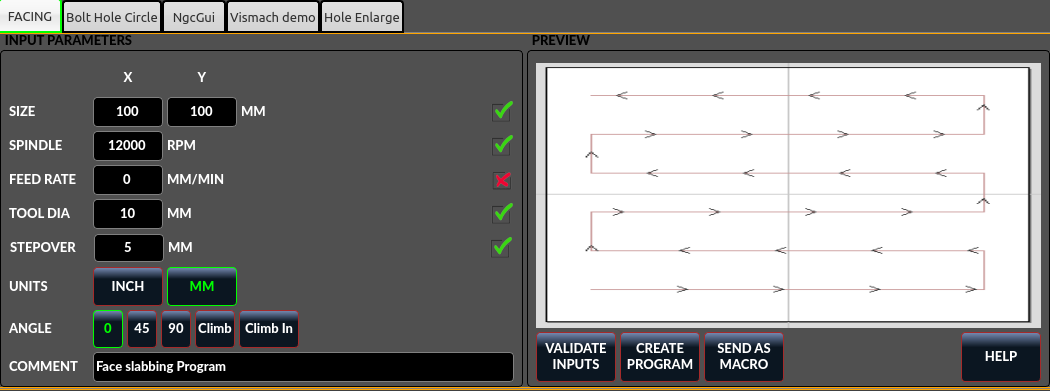

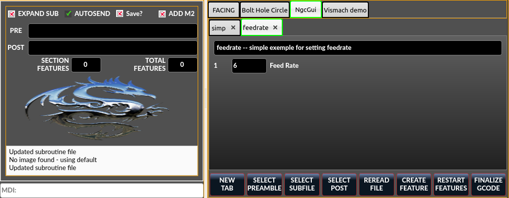

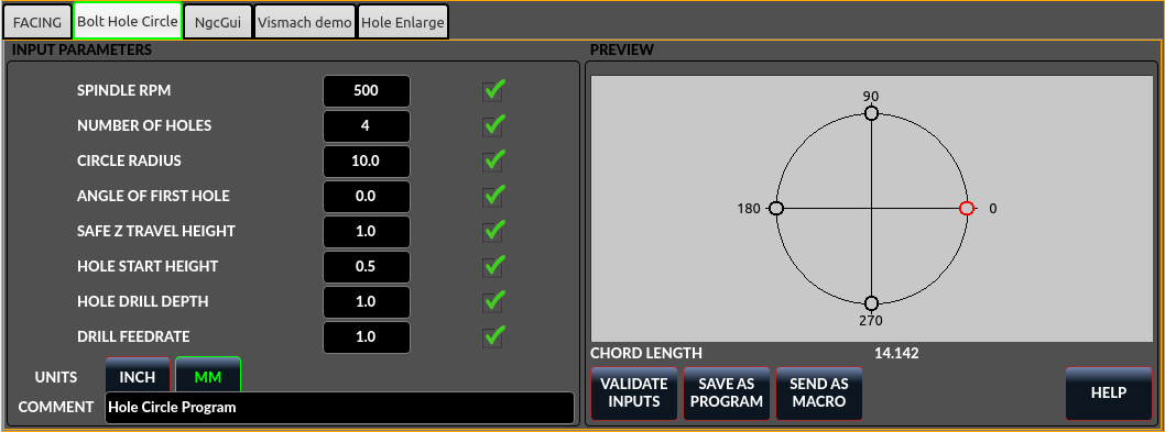

2.13. MacroTab - Special Macros Widget
QtVCP MacroTab: Special Macros Widget
Figure 9. QtVCP MacroTab: Special Macros Widget
This widget allows a user to select and adjust special macro programs for doing small jobs.
It uses images for visual representation of the macro and for an icon.
It searches for special macros using the INI definition:
[RS274NGC]
SUBROUTINE_PATH =
The macros are O-word subroutines with special comments to work with the launcher. The first three lines must have the keywords below, the fourth is optional.
Here is a sample for the first four lines in an O-word file:
; MACROCOMMAND = Entry1,Entry2
; MACRODEFAULTS = 0,true
; MACROIMAGE = my_image.svg,Icon layer number,Macro layer number
; MACROOPTIONS = load:yes,save:yes,default:default.txt,path:~/macros
MACROCOMMAND
This is the first line in the O-word file.
It is a comma separated list of text to display above an entry.
There will be one for every variable required in the O-word function.
If the macro does not require variables, leave it empty:
; MACROCOMMAND=
MACRODEFAULTS
This must be the second line in the O-word file.
It is a comma separated list of the default values for each variable in the O-word function.
If you use the word radiotrue, radiofalse, true or false in the list, a *radiobutton* will be shown.
If you use the word checktrue or checkfalse in the list, a *checkbox* will be shown.
If you use the word buttontrue or buttonfalse in the list, a *Checkable Pushbutton* will be shown.
If the default has a decimal, macroTab assumes you want a float value otherwise an integer.
Note
When using radiobuttons, only set one radiobutton as true. Radio button are used for exclusive choices.
MACROIMAGE
This must be the third line in the O-word file.
  • SVG Images
    If using SVG image files, they must end with the .svg extension.
    The images must be added to SVG layers which are used to define the different images for macro and icon.
    Value is comma separated list of three ordered fields:
    ; MACROIMAGE=filename.svg,macro_layer_name[,icon_layer_name]
    With:
    _filename_.svg
    SVG image file name as first field.
    It is assumed to be in the same folder as the O-word file.
    *macro_layer_name
    Macro image layer name as second field.
    icon_layer_name
    Icon image layer name as optional third field. If the third entry is missing, the same image will be used for macro and icon.
  • PNG/JPG Images:
    Value remains a comma separated list:
    ; MACROIMAGE=macro_image.(png|jpg)[,icon_image.(png|jpg)]
    With:
    _macro_image_.(png|jpg)
    Macro image file name as first field.
    It is assumed that the image file are in the same folder than the macro.
    _icon_image_.(png|jpg)
    Icon image file name as optional second field.
    If the second entry is missing the same image will be used for macro and image.
If the keyword is present but the entries are missing, no images will be used.
MACROOPTIONS
This optional line must be the fourth line in the O-word file.
It is a comma separated list of keyword and data, all of which are optional:
LOAD:yes
Shows a load button.
SAVE:yes
Shows a save button.
DEFAULT:ThisMacroData.txt
Sets the default preselected filename when loading/saving data for this macro.
It can be any valid filename but must end in .txt
PATH:~/linuxcnc/nc_files/mySavedMacrosData
Sets the default directory folder to preselect when loading/saving data for this macro.

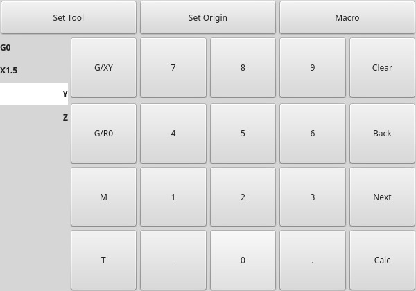

2.17. MDITouchy - Touch Screen MDI Entry Widget
QtVCP MDITouchy: Touch Screen MDI Entry Widget
Figure 10. QtVCP MDITouchy: Touch Screen MDI Entry Widget
This widget displays buttons and entry lines to use for entering MDI commands.
Based on LinuxCNC’s Touchy screen’s MDI entry process, its large buttons are most useful for touch screens.
To use MDITouchy:
  • First press one of the G/XY, G/RO, M or T button. On the left will show the entry fields that can be filled out.
  • Then press Next and Back to navigate between fields.
  • Calc will pop up a calculator dialog.
  • Clear clears the current entry.
  • Set Tool will call for a tool change.
  • Set Origin will allow setting the origin of the current G6x system.
  • Macro will call any available macro ngc programs.
The widget requires an explicit call to MDITouchy Python code to actually run the MDI command:
  • For handler file code
    If the widget was named mditouchy in Qt Designer, the command below would run the displayed MDI command:
    self.w.mditouchy.run_command()
  • For action button use
    If the widget was named mditouchy in Qt Designer, use the action button’s Call Python commands option and enter:
    INSTANCE.mditouchy.run_command()
The macro button cycles though macros defined in the INI [DISPLAY] heading.
Add one or more MACRO lines of the following format:
MACRO = macro_name [param1] [... paramN]
In the example below, increment is the name of the macro, and it accepts two parameters, named xinc and yinc.
MACRO = incerment xinc yinc
Now, place the macro in a file named macro_name.ngc in the PROGRAM_PREFIX directory, or into any directory in the SUBROUTINE_PATH specified in the INI file.
Keeping on with the example above, it would be named increment.ngc and its content could look like:
O<increment> sub
G91 G0 X#1 Y#2
G90
O<increment> endsub
Notice the name of the sub matches the file name and macro name exactly, including case.
When you invoke the macro by pressing the Macro button you can enter values for parameters (xinc and yinc in our example).
These are passed to the macro as positional parameters: #1, #2#N respectively.
Parameters you leave empty are passed as value 0.
If there are several different macros, press the Macro button repeatedly to cycle through them.
In this simple example, if you enter -1 for xinc and invoke the running of the MDI cycle, a rapid G0 move will be invoked, moving one unit to the left.
This macro capability is useful for edge/hole probing and other setup tasks, as well as perhaps hole milling or other simple operations that can be done from the panel without requiring specially-written G-code programs.

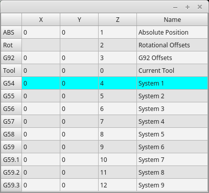

2.18. OriginOffsetView - Origins View and Setting Widget
QtVCP OriginOffsetsView: Origins View and Setting Widget
Figure 11. QtVCP OriginOffsetsView: Origins View and Setting Widget
This widget allows one to visualize and modify User System Origin offsets directly.
It will update LinuxCNC’s Parameter file for changes made or found.
The settings can only be changed in LinuxCNC after homing and when the motion controller is idle.
The display and entry will change between metric and imperial, based on LinuxCNC’s current G20 / G21 setting.
The current in-use user system will be highlighted.
Extra actions can be integrated to manipulate settings.
These actions depend on extra code added either to a combined widget, like originoffsetview dialog, or the screens handler code.
Typical actions might be Clear Current User offsets or Zero X.
Clicking on the columns and rows allows one to adjust the settings.
A dialog can be made to popup for data or text entry.
The comments section will be recorded in the preference file.
It is based on PyQt’s QTableView, QAbstractTableModel, and ItemEditorFactory.
Properties, functions and styles of the PyQt base objects are always available.

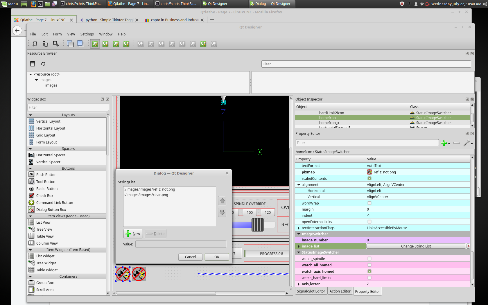

Here is an example of using it to display an icon of Z axis homing state:
QtVCP StatusImageSwitcher: Controller Status Image Switcher
Figure 12. QtVCP StatusImageSwitcher: Controller Status Image Switcher
In the properties section notice that:
  • watch_axis_homed is checked
  • axis_letter is set to Z
If you double click the image_list a dialog will show and allow you to add image paths to.
If you have one image as an icon and one clear image then that will look like it shows and hides the icon.
Selecting image paths can be done by selecting the pixmap property and selecting an image.
Note
The pixmap setting is for test display only and will be ignored outside of Qt Designer.
  • Right click the image name and you should see Copy path.
  • Click Copy path.
  • Now double click the image list property so the dialog shows.
  • Click the New button.
  • Paste the image path in the entry box.
Do that again for the next image.
Use a clear image to represent a hidden icon.
You can test the images display from the image list by changing the image number. In this case 0 is unhomed and 1 would be homed.
This is for test display only and will be ignored outside of Qt Designer.

catch_close_option
Catching the close event to pop up a 'are you sure' prompt.
close_overlay_color
Color of transparent layer shown when quitting.

fileDialog_option
Sets up the file choosing dialog.
file_overlay_color
Color of transparent layer shown when the file dialog is shown.

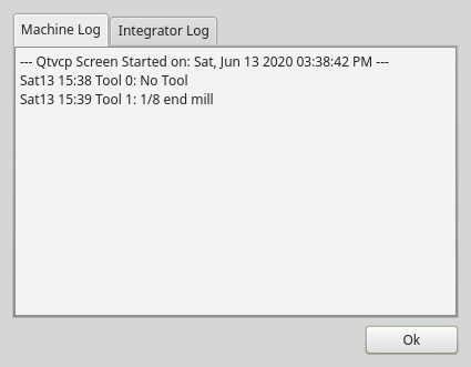

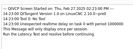

machineLogDialog_option
Sets up a dialog to display logs from the machine and QtVCP.
machineLog_overlay_color
Color of transparent layer shown when the machineLog dialog is shown.
  1. name_of_led would be the name defined in Qt Designer’s editor.
It is based on the LED widget.

2.31. StatusImageSwitcher - Controller Status Image Switching Widget
This widget will display images based on LinuxCNC status.
You can watch:
  • the state of the spindle,
  • the state of all homed,
  • the state of a certain axis homed,
  • the state of hard limits.

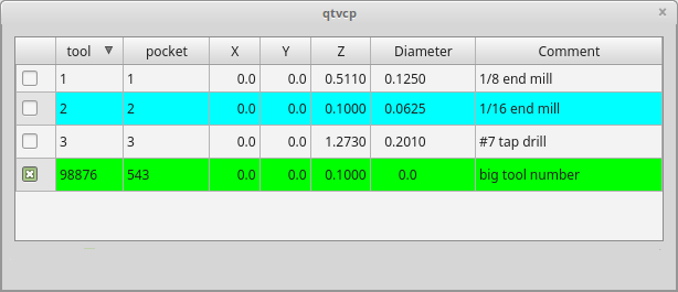

2.32. ToolOffsetView - Tools Offsets View And Edit Widget
QtVCP ToolOffsetView: Tools Offsets View And Edit Widget
Figure 13. QtVCP ToolOffsetView: Tools Offsets View And Edit Widget
This widget displays and allows one to modify tools offsets.
It will update LinuxCNC’s tool table for changes made or found.
The tool settings can only be changed in LinuxCNC after homing and when the motion controller is idle.
The display and entry will change between metric and imperial based on LinuxCNC’s current G20/G21 setting.
The current in-use tool will be highlighted, and the current selected tool will be highlighted in a different color.
The checkbox beside each tool can be used to select too for an action that depends on extra code added either to a combined widget, like the toolOffsetView dialog or the screens handler code.
Typical actions are load selected tool, delete selected tools, etc.
The comments section will typically be displayed in the manual tool change dialog.
If using a lathe configuration, there can be columns for X and Z wear.
To use these columns to adjust the tool wear, it requires a remapped tool change routine.

3.3. FileDialog - Load and Save File Chooser Dialog Widget
QtVCP FileDialog: Load and Save File Chooser Widget
Figure 16. QtVCP FileDialog: Load and Save File Chooser Widget
This is used to load G-code files.
If there is a Focus Overlay widget present, it will signal it to display.
When using STATUS 's request-dialog function, the default launch names are LOAD or SAVE.

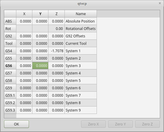

3.4. OriginOffsetDialog - Origin Offset Setting Dialog Widget
QtVCP `OriginOffsetDialog`: Origin Offset Setting Widget
Figure 17. QtVCP OriginOffsetDialog: Origin Offset Setting Widget
This widget allows one to modify User System origin offsets directly in a dialog form.
If there is an Focus Overlay widget present, it will signal it to display.
When using STATUS 's request-dialog function, the default launch name is ORIGINOFFSET.
It is based on PyQt’s QDialog.

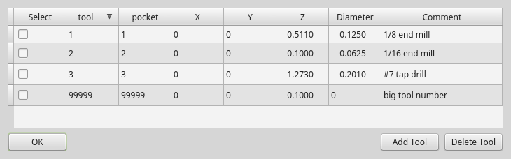

3.5. ToolOffsetDialog - Tool Offset Setting Dialog Widget
QtVCP `ToolOffsetDialog`: Tool Offset Setting Dialog Widget
Figure 18. QtVCP ToolOffsetDialog: Tool Offset Setting Dialog Widget
This widget allows one to modify Tool offsets directly in a dialog form.

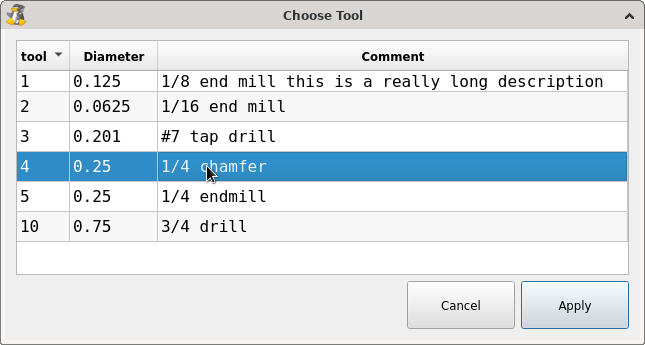

3.6. ToolChooserDialog - Tool Chooser Dialog Widget
QtVCP `ToolChooserDialog`: Tool Chooser Dialog Widget
Figure 19. QtVCP ToolChooserDialog: Tool Chooser Dialog Widget
This widget allows the operator to select one of the tools defined in the tool table. If a tool is selected and Apply is pressed or the tool is double-clicked, the dialog will return the tool number selected. This can be used in conjunction with the OperatorValueLine widget to create a tool change widget, for example.
When using STATUS 's request-dialog function, the default launch name is TOOLCHOOSER.

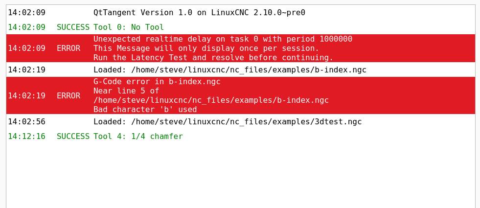

3.7. MachineLog - Machine Events Journal Display Widget
This widget displays various log event messages that have been output by the system during the current session. This includes informational messages as well as errors.
QtVCP `MachineLog`: Machine Log Widget
Figure 20. QtVCP MachineLog: Machine Events Log in machine_log (plain) mode
Figure 21. QtVCP MachineLog: Machine Events Log in machine_log_severity mode
Two distinct types of logs may be displayed:
  • machine log (plain text or severity highlighted)
  • integrator log (plain text only)
The type of log shown by the widget is controlled by the option properties of the widget. By selecting machine_log_option or integrator_log_option the appropriate log will be displayed. These options will display plain styled logs in a Qt QTextEdit widget.
Additionally, there is a machine_log_severity_option property that may be chosen that will display the machine log in a variety of colors depending on the severity of the message, by using a QTableWidget. The colors may be configured with the properties of the widget.
3.7.1. Emitting Log messages with Severity
Severity is conveyed via the option value sent along with the STATUS signal called update-machine-log. The option parameter is a comma-delimited list, containing typically
``` text = an error has occurred. STATUS.emit(update-machine-log, text, TIME,ERROR) ```

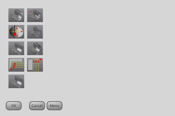

3.8. MacroTabDialog - Macro Launch Dialog Widget
This is a dialog to display the macrotab widget.
MacroTab displays a choice of macro programs to run using icons.
When using ``STATUS``'s request-dialog function, the default launch name is MACROTAB.

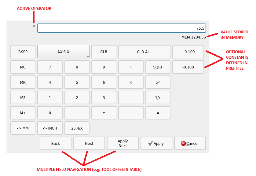

3.11. CalculatorDialog - Calculator Dialog Widget
This is a dialog to display a calculator for numeric entry, such as origin offset, spindle RPM, etc. It is primarily intended for touchscreen use, but it has support for physical keyboard input as well.
QtVCP CalculatorDialog: Calculator Dialog Widget
Figure 22. QtVCP CalculatorDialog: Calculator Dialog Widget
It returns the entry via STATUS messages using a Python DICT.
The DICT contains at minimum, the name of the dialog requested and an ID code.
When using ``STATUS``'s request-dialog function, the default launch name is CALCULATOR.
3.11.1. Preferences file options
In the CALCULATOR section of the preferences file the following options may be set:
  • constValuesList - A comma-delimited list of common values you might enter, that will appear on a dedicated row of buttons at the bottom of the calculator. e.g. setting to 0.100, -0.100 would provide two buttons for +0.100 and -0.100 which are commonly used when edge-finding on inch mills. Up to six (6) values may be entered, beyond that the list will be truncated. Values must be valid floating point or integer.
  • onShowBehavior - A list of optional behaviors that will be triggered when the calculator dialog is shown. Each option must be separated by a comma.
    • CLEAR_ALL to issue a Clear All each time the calculator is shown. This will clear any previously entered values from the last time the calculator was used and open with the display value set to 0
    • FORCE_FOCUS will force the focus to the calculator input field when the widget is shown. This will allow a physical keyboard to provide input to the widget properly without additional clicks. Also, it has the side-effect of selecting the current value, such that typing from a physical keyboard will replace the existing value unless the text selection is changed.
  • acceptOnReturnKey - If set to True, the calculator will accept the current value and close the dialog when the keyboard return/enter key is pressed. If set to False, the return key will be ignored and the Apply button must be clicked. For cases where the Apply Next button is available, the return key will perform this action instead, and the dialog will remain open.

  • the minus key (-) will toggle the sign of the current number in the calculator display when it is hit twice in a row. Otherwise when hit only once it will perform a subtraction operator as expected.
  • Alt+Left Arrow will perform Back function, moving to the previous field for cases where this is supported.
  • Alt+Right Arrow will perform a Next function, moving to the next field for cases where this is supported.
  • Alt+Backspace will cancel out of the calculator and not provide a return value to the calling widget.

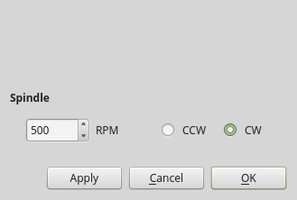

3.12. RunFromLine - Run-From-Line Dialog Widget
QtVCP RunFromLine: Run-From-Line Dialog Widget
Figure 23. QtVCP RunFromLine: Run-From-Line Dialog Widget
Dialog to preset spindle settings before running a program from a specific line.

3.14. MachineLogDialog - Machine and Debugging Logs Dialog Widget
QtVCP MachineLogDialog: Machine and Debugging Logs Dialog Widget
Figure 25. QtVCP MachineLogDialog: Machine and Debugging Logs Dialog Widget
This is a dialog to display the machine log and QtVCP’s debugging log.

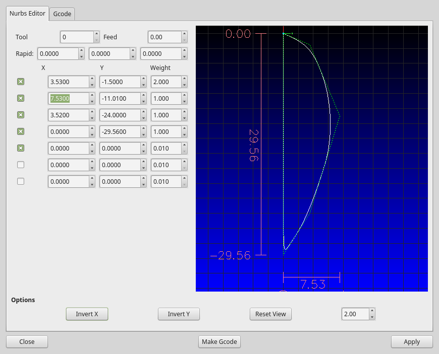

4.1. NurbsEditor - NURBS Editing Widget
QtVCP NurbsEditor: NURBS Editing Widget
Figure 26. QtVCP NurbsEditor: NURBS Editing Widget
The Nurbs editor allows you to manipulate a NURBS based geometry on screen and then convert NURBS to G-code.
You can edit the G-code on screen and then send it to LinuxCNC.

5.1. IndicatedPushButtons
This class modifies QPushButton behaviour.
5.1.1. Indicator Option
indicator_option puts a LED on the top of the button.
QtVCP PushButton: Indicated Action Button, LED Indicator Option
Figure 27. QtVCP PushButton: Indicated Action Button, LED Indicator Option
It can be a triangle, circle, top bar, or side bar.
The size and position can be adjusted.
It will indicate:
  • the current state of the button, or
  • the state of a HAL pin, or
  • LinuxCNC status.

on_color
off_color
flashIndicator
flashRate
indicator_size
circle_diameter
shape_option
right_edge_offset
top_edge_offset
height_fraction
width_fraction
corner_radius
Indicator corner radius.
The LED indicator color can be defined in a stylesheet with the following code added to the .qss file:
Indicated_PushButton{
  qproperty-on_color: #000;
  qproperty-off_color: #444;
Or for a particular button:
Indicated_PushButton #button_estop{
  qproperty-on_color: black;
  qproperty-off_color: yellow;
Options

6.3. Facing
Slab or face a definable area with different strategies.
6.4. Hole Circle
Drill multiple holes on a bolt hole circle.

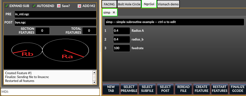

6.5. Qt NGCGUI
QtVCP NGCGUI: Shown from QtDragon
QtVCP’s version of NGC subroutine selector (Shown as used in QtDragon).
6.5.1. INI settings
LinuxCNC needs to know where to look to run the subroutines.
If the subroutine calls other subroutines or custom M codes, those paths must be added too.
[RS274NGC]
SUBROUTINE_PATH = ~/linuxcnc/nc_files/examples/ngcgui_lib:~/linuxcnc/nc_files/examples/ngcgui_lib/utilitysubs
QtVCP needs to know where to open subroutines from.
You can also specify subroutines to be pre-opened in tabs.
[DISPLAY]
# NGCGUI subroutine path.
# This path must also be in [RS274NGC] SUBROUTINE_PATH
NGCGUI_SUBFILE_PATH = ~/linuxcnc/nc_files/examples/ngcgui_lib
# pre selected programs tabs
# specify filenames only, files must be in the NGCGUI_SUBFILE_PATH
NGCGUI_SUBFILE = slot.ngc
NGCGUI_SUBFILE = qpocket.ngc
6.5.2. Buttons
  • NEW TAB - add new blank tab to NGCGUI
  • SELECT PREAMBLE - select a file that add preamble G-code
  • SELECT SUBFILE - select a NGCGUI subroutine file
  • SELECT POST - select a file that add post G-code
  • REREAD FILE - reload the subroutine file
  • CREATE FEATURE - add feature to the list
  • RESTART FEATURE - remove all features from the list
  • FINALIZE GCODE - create the full G-code and send it to LinuxCNC/a file
6.5.3. Adding Custom Subroutines
You can create your own subroutines for use with NGCGUI. They must follow these rules:
  • For creating a subroutine for use with NGCGUI, the filename and the subroutine name must be the same.
  • The subroutine must be in a folder within LinuxCNC’s INI designated search path.
  • On the first line there may be a comment of type info:
  • The subroutine must be surrounded by the sub and endsub tags.
  • The variables used must be numbered variables and must not skip number.
  • Comments and presets may be included.
  • If an image file of the same name is in the folder, it will be shown.
(info: feedrate -- simple example for setting feedrate)
o<feedrate> sub
    #<feedrate>       = #1 (= 6 Feed Rate) ; comments in brackets will be shown in ngcui
    f#<feedrate>
o<feedrate> endsub
QtVCP NGCGUI Custom Sub
