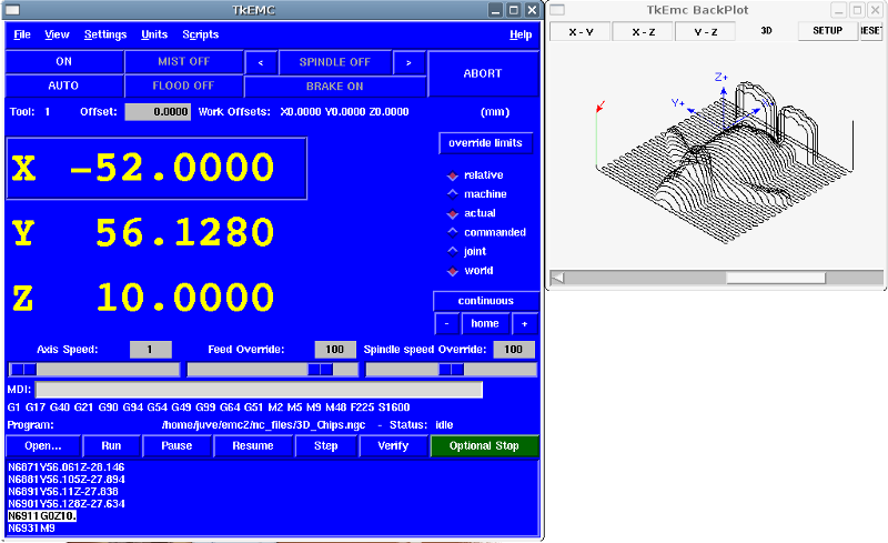

TkLinuxCNC is one of the first graphical front-ends for LinuxCNC. It is written in Tcl and uses the Tk toolkit for the display. Being written in Tcl makes it very portable (it runs on a multitude of platforms). A separate backplot window can be displayed as shown.
TkLinuxCNC Window

3. Elements of the TkLinuxCNC window
The TkLinuxCNC window contains the following elements:
  • A menubar that allows you to perform various actions
  • A set of buttons that allow you to change the current working mode, start/stop spindle and other relevant I/O
  • Status bar for various offset related displays
  • Coordinate display area
  • A set of sliders which control Jogging speed, Feed Override, and Spindle speed Override which allow you to increase or decrease those settings
  • Manual data input text box MDI
  • Status bar display with active G-codes, M-codes, F- and S-words
  • Interpreter related buttons
  • A text display area that shows the G-code source of the loaded file

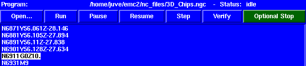

3.4. TkLinuxCNC Interpreter / Automatic Program Control
TkLinuxCNC Interpreter / program control
Control Buttons
The buttons in the lower part of TkLinuxCNC are used to control the execution of a program:
+ * Open to load a program, * Verify to check it for errors, * Run to start the actual cutting, * Pause to stop it while running, * Resume to resume an already paused program, * Step to advance one line in the program and * Optional Stop to toggle the optional stop switch (if the button is green the program execution will be stopped on any M1 encountered).
Text Program Display Area
When the program is running, the line currently being executed is highlighted in white. The text display will automatically scroll to show the current line.
