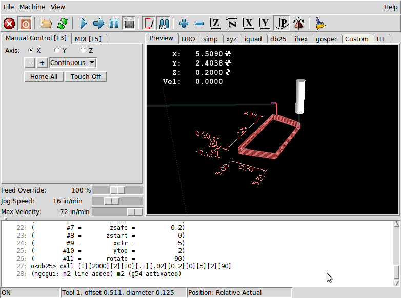

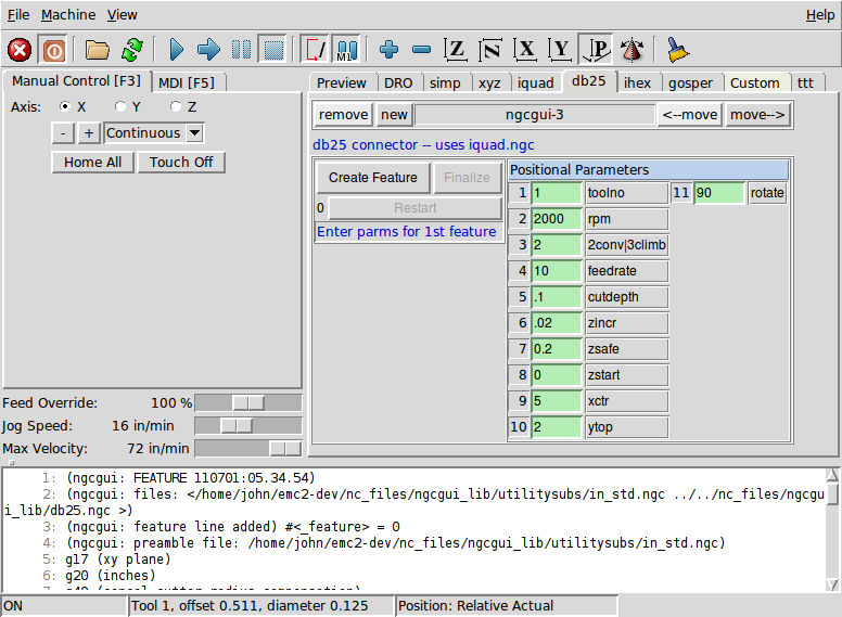

To try a demonstration, select a sim configuration and start the LinuxCNC program.
If using the AXIS GUI, press the E-Stop images/tool_estop.png then Machine Power images/tool_power.png then Home All. Pick a NGCGUI tab, fill in any empty blanks with sensible values and press Create Feature then Finalize. Finally press the Run images/tool_run.png button to watch it run. Experiment by creating multiple features and features from different tab pages.

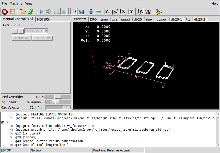

To create several subroutines concatenated into a single file, go to each tab fill in the blanks, press Create Feature then using the arrow keys move any tabs needed to put them in order. Now press Finalize and answer the prompt to create

7. DB25 Example
The following shows the DB25 subroutine. In the first photo you see where you fill in the blanks for each variable.
